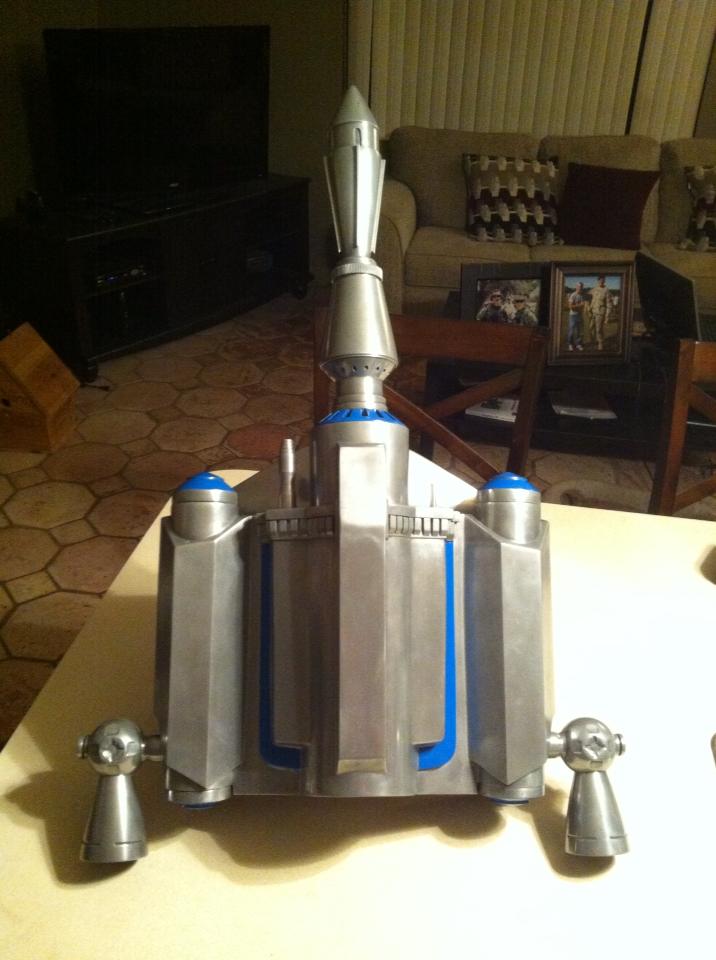

Looks awesome! What paints did you use to weather the jet pack?
Thanks!
The weathering is my usual mix of acrylic paints - Apple Barrel brand you can find at walmart or craft stores. Always use a brown and black. I'll play around with the ratio when mixing though. I haven't actually finished weathering the pack (actually, it's half-weathered lol ) as I actually ran out of the paint, and was too lazy to get more at the time. I *may* look into adding a few different colors for the pack's weathering. I think this looks good (matches my helmet) but gotta figure it should have some more "variety"

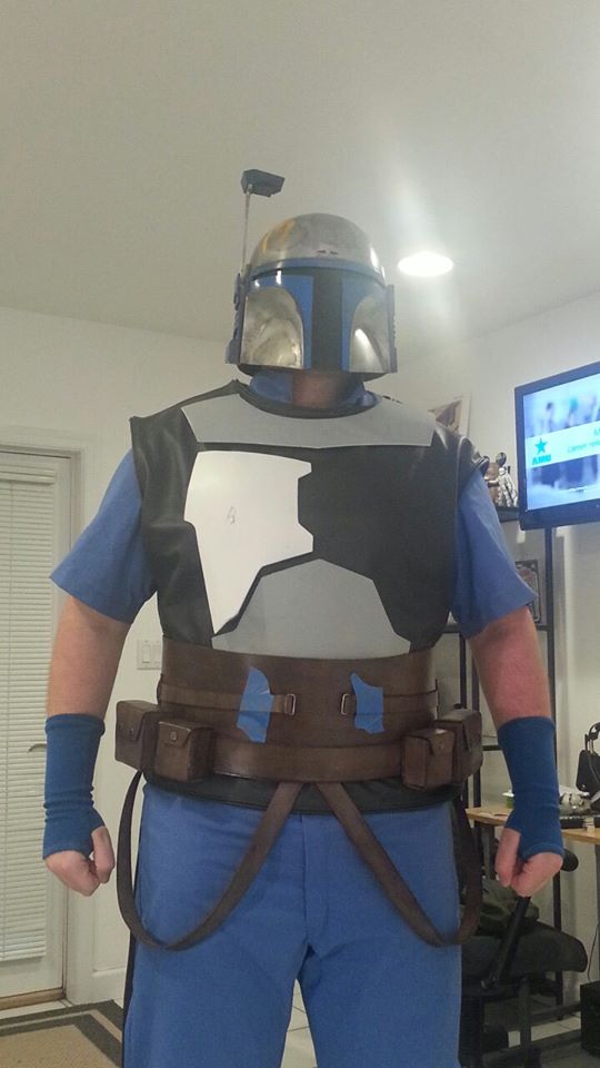

Took a lot longer than I expected but taking pics with a timer while trying to keep your armor held up with blue tape is not exactly..easy..
Just wanted to see how it all looked so far.
Got a lot left to do...

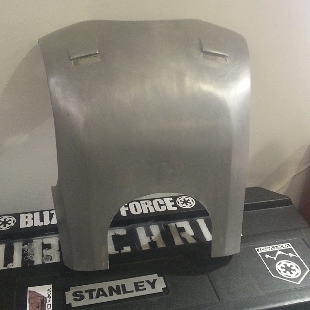

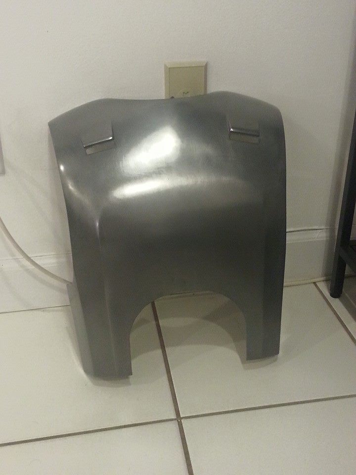

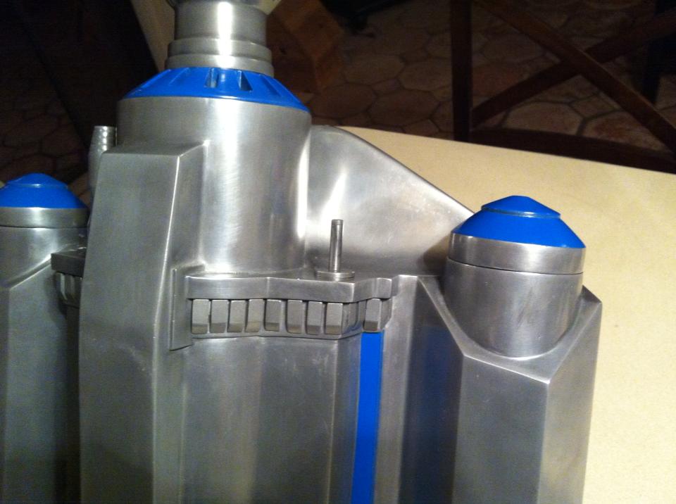

Did something else today too. I've had this Cruzer cold cast backplate sitting around so I figured why not do something about it. I'm not entirely sure I'll really be able to use this, but I'd have to heat and widen up the lower sides that stick inward. I think that's all I'd need to do to make it work out, but the backplate will more than likely be required for 501st approval, regardless if it's visible or not
Just hit it with some 400 grit sandpaper to eliminate the gray primer coat
One good once-over with the aluminum polish..
Nice and shiny. Still need to do some edge smoothing but it's alright to polish it up anyways
-TC

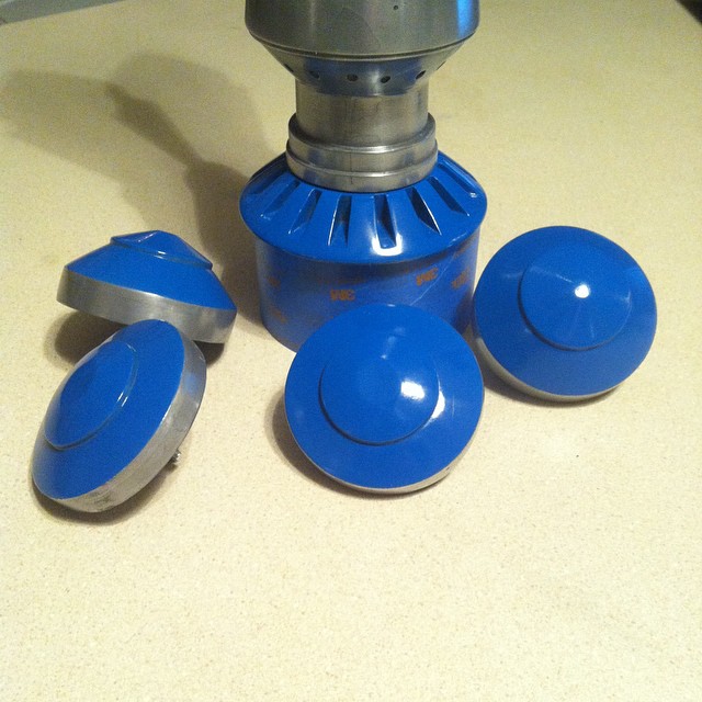

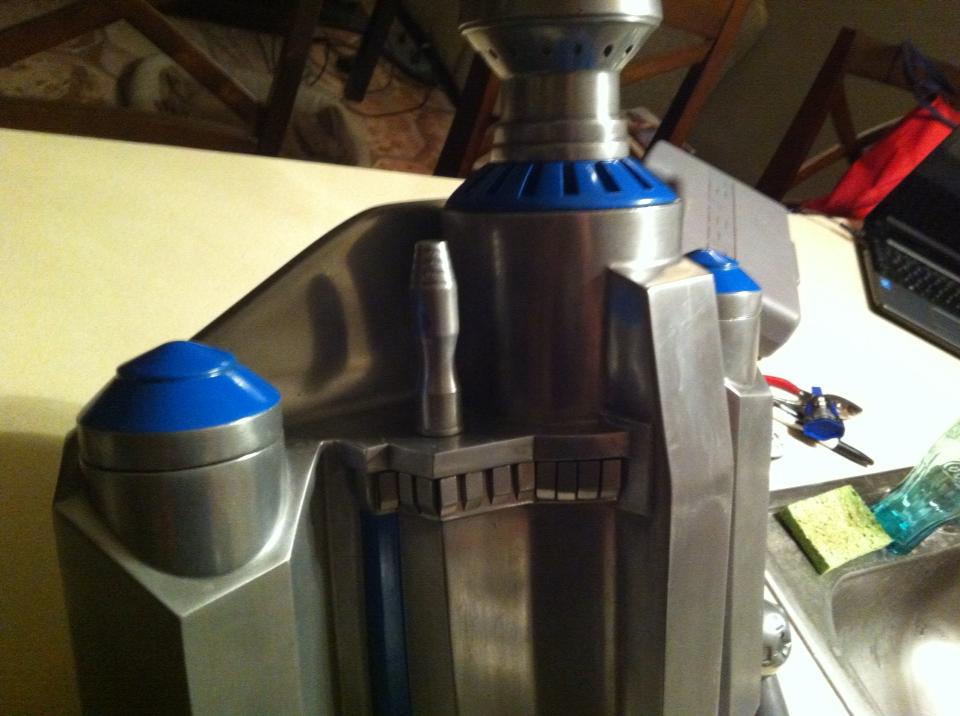

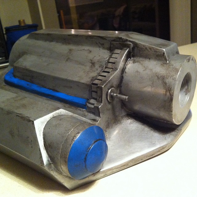

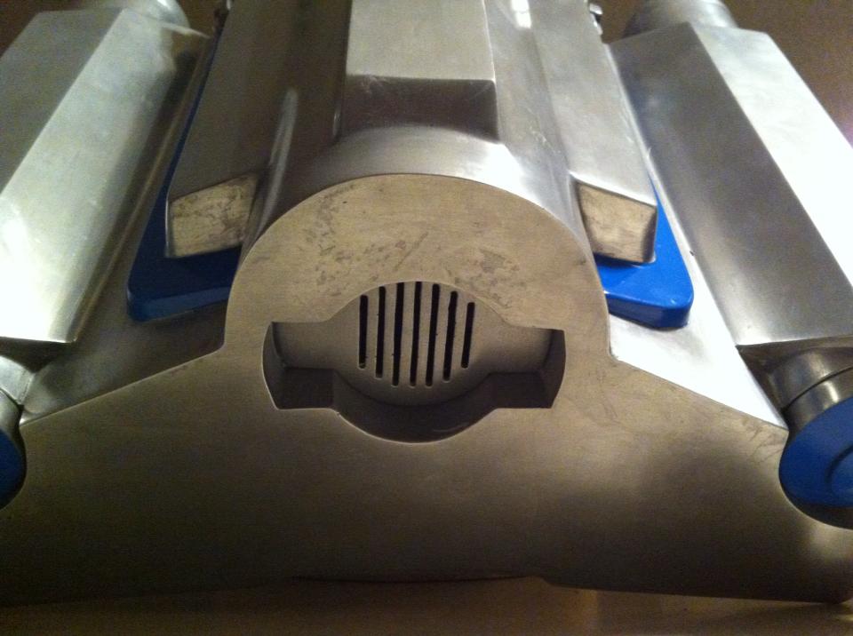

I noticed some of my images were no longer appearing so I'm re-hosting them so they won't do that again...namely of my cold-cast Jetpack
How it looks now...half-weathered lol Gotta do the other half..

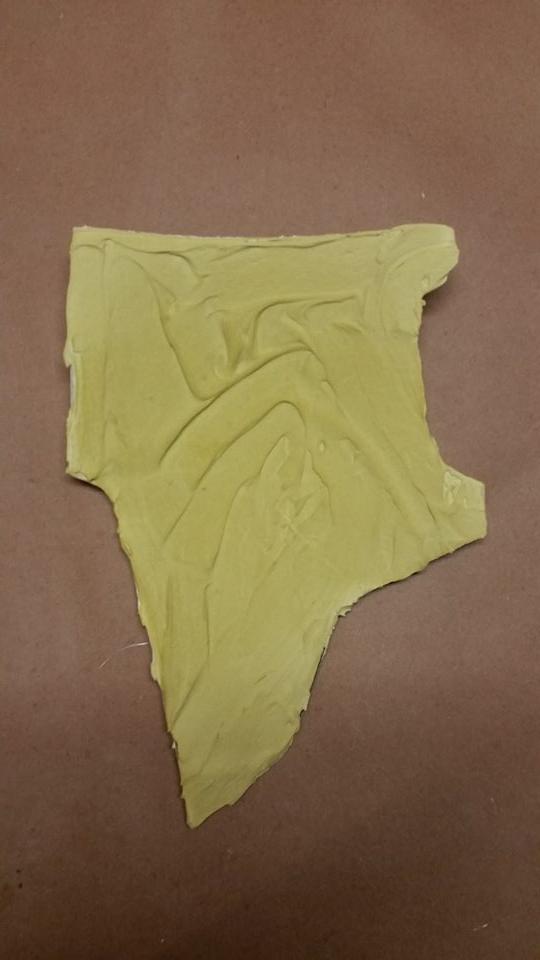

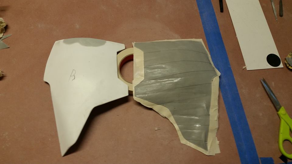

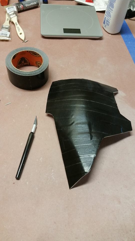

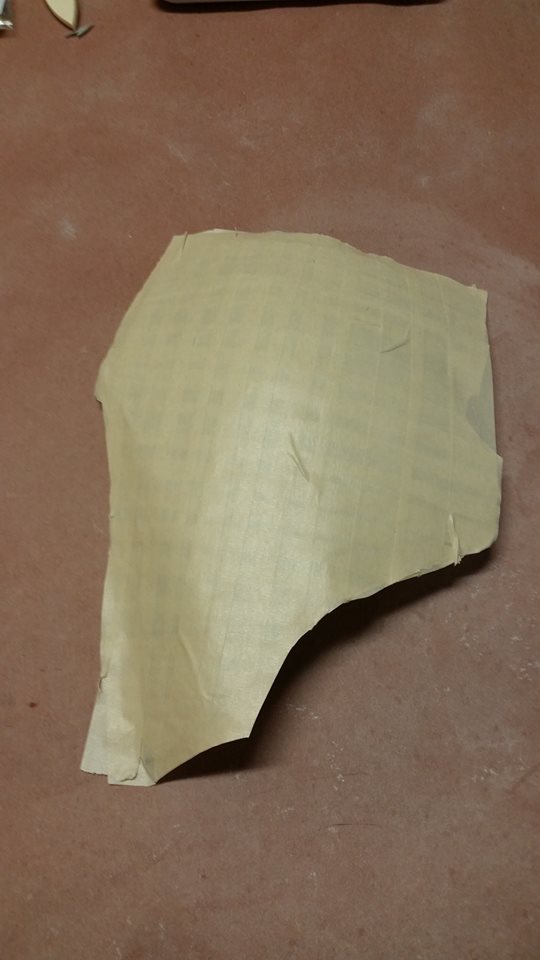

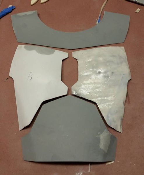

I got a bit more done today. Taking a few days off so I wanted to get the ball rolling on making the other pectoral piece. This is a technique I've been wanting to try for awhile and discovered this from Bobamaker's page on how he had to create the opposite jango pectoral. I will say, maybe due to the significantly larger scale my piece is to a normal jango pec, it was seemingly more difficult than it looks. Nonetheless, I feel it worked well enough for my needs so I can't complain. While the outcome is not a smooth surface, the idea is you're mirroring the overall shape so you're not trying to make it symmetrical by sculpting it.
The one thing I will be doing differently, however, is that Daz used his resin copy as the final master. For myself, as I did with the first sintra pec, by creating a form and heating/shaping the sintra, I'll be doing the same with this piece, by reinforcing and cleaning the surface, pressing into the plastic.
The surface is funky as I had used talcum powder to thicken the resin. Unfortunately, depsite the work time stating 10 minutes, it was already starting to cure closer to 5, therefore some of the larger clumps. Was my first time doing that, so I'll just experiment next time...
-TC

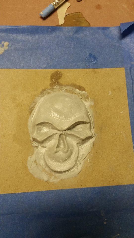

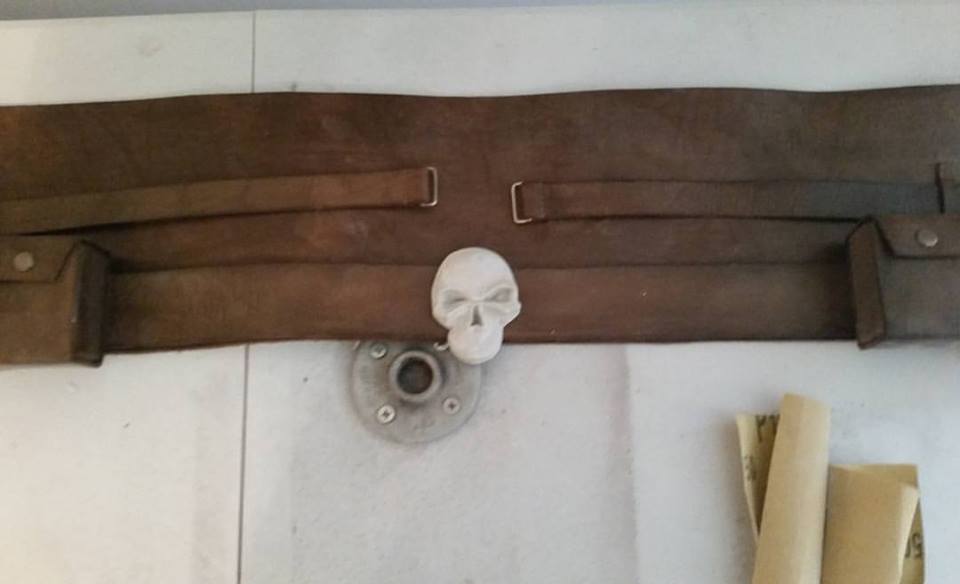

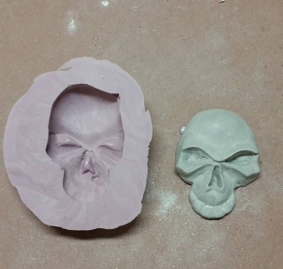

Little bit more work today. While doesn't look like much, trying to sculpt this was a chore. This piece will sit on the lower-center part of the belt. I used magic sculpt and just went at it. It's not perfect, but considering I suck at sculpting (anything in clay) I think it's alright. Once it cures I'll be scribing in the teeth details. Once it's done, I'll make a quick mold and cold-cast the piece. Think it'll look good once that process is done.
Additionally, I reinforced the rear of that resin copy I did yesterday. It's no longer going to flex, so I can start cleaning the top-side without fear of breaking anything. As I said, this will just serve as the form for the sintra.
As for the other armor parts, I'm gonna reinforce the collar piece the same way as it's pretty flexible. Another thing to note though, I'm wondering if the collar may just be a bit too wide for me, but I'll consult with locals about that before proceeding forward
-TC

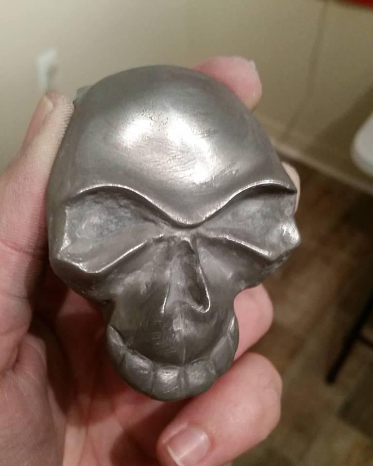

Despite running around most of the day, I've got this piece pretty much done, the hard part anyways. Piece is cold cast and polished. Just needs some weathering.
Placement on the belt, think it's a good size
I added teeth to the sculpt and made a quick mold
First cast cleaned up and polished!
