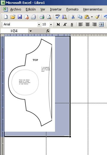

hey guys, sorry for the long wait. but, i finally shipped the templates off. I am truly sorry for the delay.
~Michael
Thank you very much, I just received mine and am heading off to Home Depot later. Thank you for sending me those templates!!!!!!

cal196 said:
Can anyone send these full size to me? I have no way to print them out at all.
if you had excel you can paste the images, and then print.
the excel software can prints diferents sheets for a larger one ;)
edit
as you can see here you can print 4 pages
