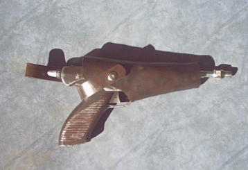

I went for a beaten up look with ths
That looks pretty sweet! Could you make a tutorial for me as I'm going to need to make one for my ESB Fett!
I'm pretty lousy at tutorials....I essentially cut the top off the Zapper with my trusty dremel and fashioned a new one out of Sintra. The barrel is just aluminium tubing, and the "flash nozzel" is the casing off a UHF connector

Nice! Great work DarthBish. I saw a few of the old Zappers being sold at the mall a whlile back. I'll have to see if they're still there and pick one up. I especially like the Barrel tip you made, great idea with the UHF connector.
The old Nintendo zappers/light guns are not too bad a price in the second hand games shops now, I saw one for £6.99 yesterday :)
soilman1 said:
what is the uhf adapter thing? is there a part number for it?
Its a plastic plug that joins the aerial cable to the TV, any electrical shop will do them.
