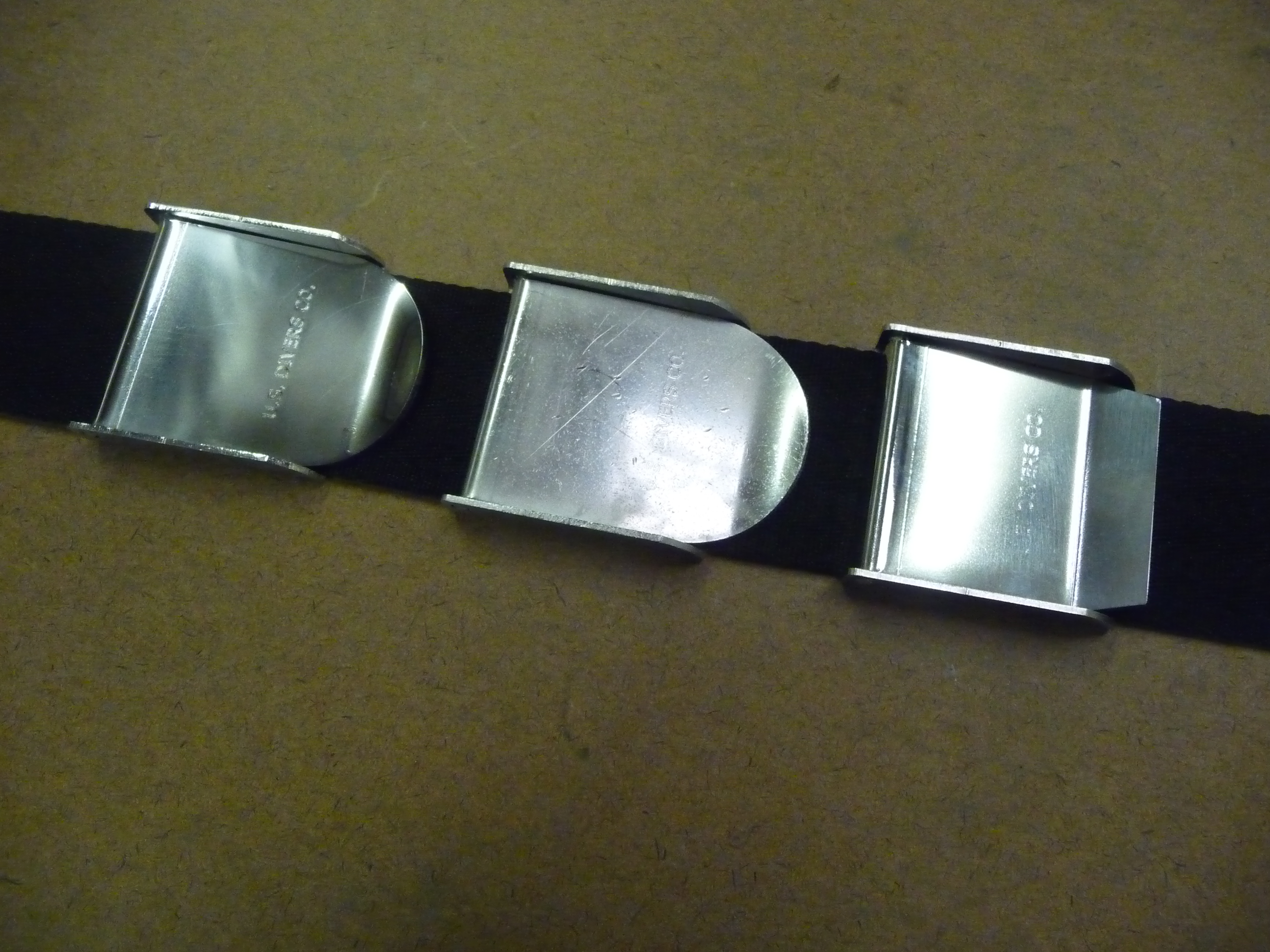

As Gav has said before the harness does not include the US divers buckle,but a high quality replica is available through me or Rob.
I have now added the square tab bucklefor Supertrooper and PP1.
Shown from left to right, round tab(clean),round tab(weathered),and square tab.

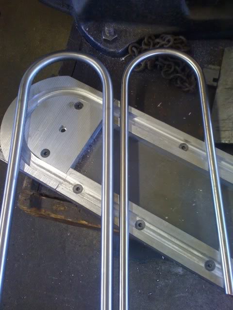

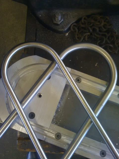

Ok, I have spent the day in the fab shop working on the rig. We have pretty much been laying the foundations, making the jig to locate the harness in the CNC later in the process. The rig is also used at this point to make sure the correct bend is achieved. We also finished the former to bend the material without any deformation. These were all done on the same principals as the previous outing, but the former has been "beefed up" due to the increase in wall thickness.
Here is the first bent section (left) on the right is the previous rig. This is the first time I have been able to compare the difference.
And the jig in the CNC
From here we can make the brace sections to fit the rig and the distance between the two legs perfectly.
