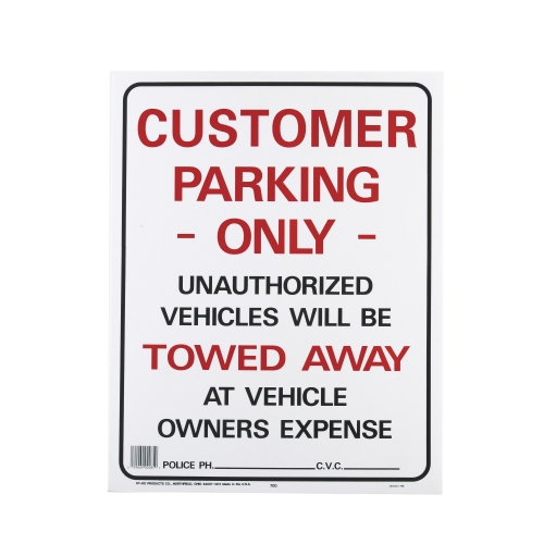

I've also found that clear acrylic does not cut easy witha Dremel or jigsaw. The friction heat that builds up usually melts the plastic back closed behind your cutting wheel or blade.
Go to a True Value or ACE Hardware. They carry a Tow Away Zone Sign that is a very nice thickness. This is much thicker than the "For Sale" or "Garage Sale" signs that I've seen at Home of De'pot or Lowes.
The signs look like this:

drokkul,
Thanks for the tip on the Tow Away signs. That's good to know. Helps to have a local supply available.
