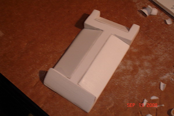

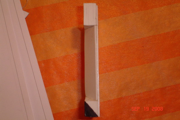

Okay, since it is Friday, I was able to do some more work. Now, I can't wait until tomorrow!! I was able to widdle down more of the lower ear cap piece that goes under the range finder. I marked off the angle of the lower piece with a Sharpie and then went to work! Then I sanded it down as best I could and the result is what you see in the picture. Next, I will complete the top rangefinder piece as well as fix some of the imperfections on the lower ear cap piece. Hopefully, I can finish the other ear cap over the weekend!

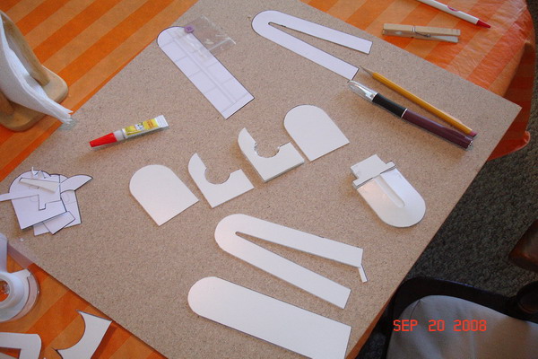

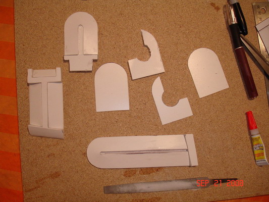

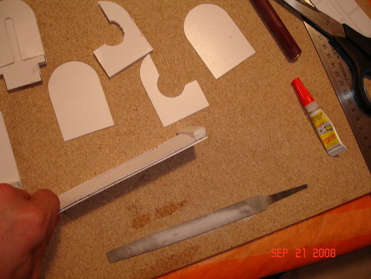

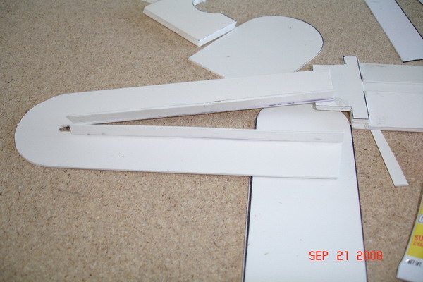

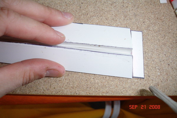

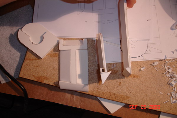

I continued with the easr pieces. I cut out parts of the range finder cap using foam board to "build" it up. I cut the same shapes out of the Sintra for a stiff base. Next will be piecing them together and using some Bondo to strengthen them into a solid looking piece. I also started the other ear cap piece. I used all Sintra pieces and found that when I bent the "U" shaped piece into place, it bowed out in the middle and looked a little awkward. So, I cut to strips and Super Glued them into place in the edge of the "U". Now it has good strength to hold the proper form. I did make them a little too wide though so I will trim them down; you can see in one of the photos that it causes the edges of the "U" to go beyond the base piece. SO, a little sanding and trimming and it should be good to go!

Hi Brent, that is actually eight pieces of 2mm Sintra to form the "upright" and angled edge (one whole piece and then trimmed and sanded to form the angle), then it was glued onto another 2mm piece as the base of the lower ear cap piece.

Hey Brent, your question prompted me to take a look at my lower ear cap again and I noticed that I needed to add another 2mm layer to it. I do not know if that was the intent of your question, but thanks for getting me to look at it again!

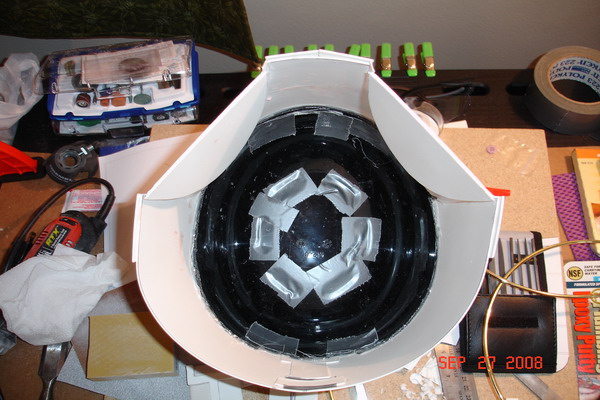

OKay, today was a busy day so I was not able to get as much done as I had wanted; however, I was able to add one layer to the back of my lower ear piece and complete initial construction of the left ear piece. I blocked together five pieces of Sintra and tomorrow I will widdle away and do some more sanding to create the angle of the lower ear piece. These pieces will actually need a little refinement (in my opinion) before they are attached to the helmet. I am also debating about casting the lid and whether I should cast it with the ear caps on or off. I am also debating before attaching them whether I should make a mold of them as well, depending on the final result! Enjoy the photos, any comments or thoughts on today's post, let me know!

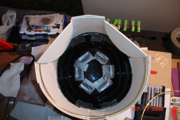

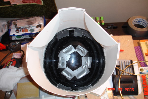

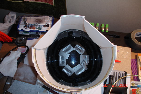

Okay, today I decided that it is time to get back to correcting the helmet in preparation for adding a strengthening layer of fiberglass to the inside of the helmet. To do this I need to add the craft ring into the lid. I purchased a 10" and a 12" ring and decided to hack up and slightly bend the 12" into place and see how that works. In the photos that I have, I took before and after so that you can see if there is a difference. Once I have eliminated the irregular shape, I will then hot glue the ring into place and then add the fiberglass.
