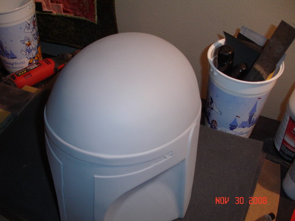

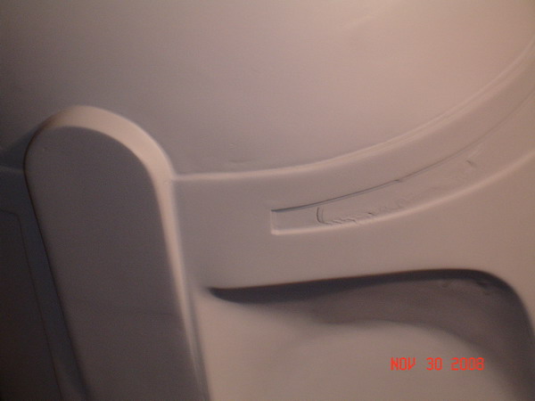

Another possible solution to the problem with the holes in the top, is to coat the whole dome with a thin layer of bondo, then when you sand it down, it should sand down evenly.
Just a thought. The problem with the bike helmet holes arises because the filler material (bondo or red paste) is less tough than the original plastic. So when you sand the area the filler sands down faster than the bike helmet and you get the dips.
You need to find a filler that is of a similar toughness to the bike helmet. No idea what sort of filler that might be.
I had a similar problem because I used two different types of polyfiller on my bucket.
Actually, the "Red Paste" is Bondo, I found it in a single tube that does not require mixing. I took to the lid this past Wednesday and found that by lightly sanding teh area, it seemed to fill the holes better, and then with the new primer that I used called Dupli-Color Filler Primer from an automotive store, it wound up covering the holes and the crack lines after my last bit of Bondo-ing quite nicely. I just have a little more filler work to do and a little more sanding and I will be ready for the keyholes in the back and then the Dent!
Eric

Short of fiber glassing the holes I don't think you can find a 'filler' that would be as strong as the plastic helmet. The problem with using filler to fill holes in plastic is also due in part to the plastic being very flexible as well as hard. I would suggest trying a skim layer over the larger surface of the holes and sanding down in stages.
Rough shape with 120 grit so you don't take too much material off or make deep groves (80 grit if you apply too much) then step it down to 220, 320, 400, 600 and 1000. Pressure is key in sanding but the good news is that you're in control. Try using a foam sanding block or a sponge to sand with.
-Aaron.

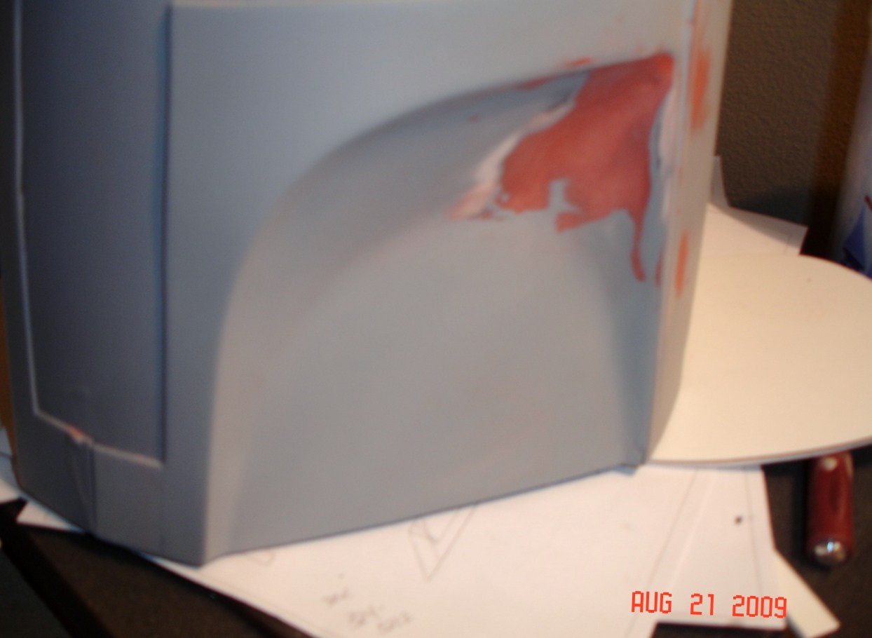

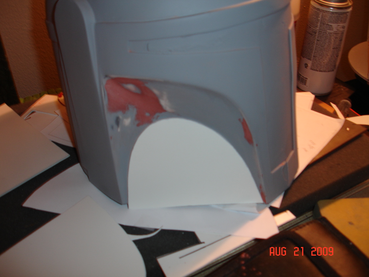

Hey gang, looking for some assistance/suggestions. I have been annoyed with how the cheeks look. I notice that in the movei reference photos, the "cheekbone" is rather defined. Is this because of a good paint job or are the cheeks outlined against the upper cheek piece really defined? Or both? I was thinking of adding an additional piece of Sintra to outline the cheeks and resolve my dilemma. Thoughts or suggestions?
Eric
Hi there, I'm fairly new to all this myself, but if it was me, I would proabably try to define the cheeks with sanding rather than add another layer. Adding another layer would make the cheek area shallower, which is a problem I had do deal with when I attached the mandible pieces in the wrong place on my first build. It would of course depend on how thick the additional layer was. It may be the easier route. I know how everyone 'loves' sanding:D. Glad to hear you're feeling better.
Ah yes, the dreaded "S" word. The sintra I use is only a little more than 1mm thick. Fortunately I have reinforced the inside with fiberglass in case I sand too much. Any other ideas? THoughts? Hopefully this week I will be heading out to find some silicone here in CT to make my mold so I can cast this helmet to make more! Anyone out there in the CT area? I would love to hear from you.
well, it has been a real strugle for me trying to get those cheeks right. I am thinking of maybe either cutting them out and replacing the piece after sanding, or molding this helmet and then cutting out the cheek. Is this why some of you have had various versions of your helmet? If anyone has some suggestions on the cheeks, please let me know as I am really struggling with this.
