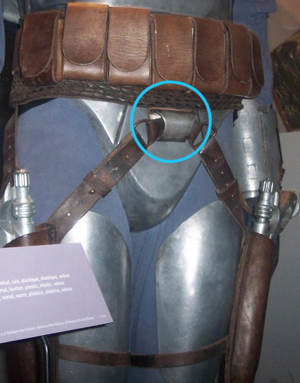

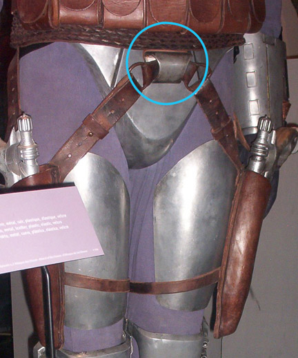

If you look at the pics I've attached from the exhibit in PARIS, you can see that there is no actual ARMOR that connects the holster rig loop to the the girth, but it is indeed a piece of leather much like the rest of the belt. And as far as color, these show much like AOTC Visual reference guide that the color of the holsters should be a more Chocolaty Brown. Cruzer, Go ahead and Hook a Broda Up!;) :thumbsup:
Yeah, it is a half piece of round with a backing attached by rivets(more than likely) to leather. I can make yours like that no probs with the way I fabricated the holder piece out of very strong epoxy and a series of lips and notches using the repair kit part. However, I think the problems occured when using a regular piece of pvc pipe cut in half and glued flat to a backing. The bond area between the two pieces wasn't enough. But the way I fabricated yours, I actually had to cut notches out and even cut the end piece at a 10 degree angle so that it is overlaped by the round part....that probably doesn't make a lick of sense in trying to describe it. But if you'd like me to try and rig yours up like that I'd me more than happy to, especially to see if it works.

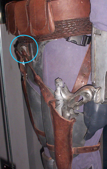

Edit: And what's up with that black clip on the one pic...what's that go to?

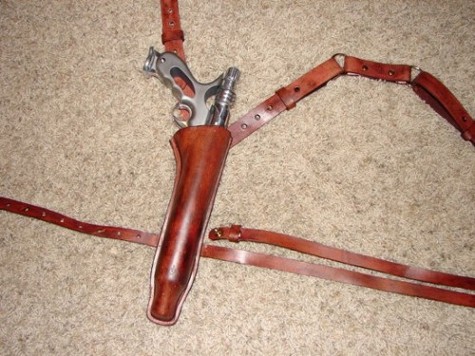

And also, the holster assembly I made was stained with dark brown...but for some reason the flash and camara seems to bring out red and orange. They are more brown in color. I'll try taking a pic without the flash. I had to use flash with these because I took them at night.
So don't worry, your holsters won't be a florescent orange when they arrive and you open the box.:lol:
Oh, and I like how in one of the pics you posted the jumpsuit looks blue...and in the very next pic it looks purple. Goes to show me the dramatic effects lighting plays in trying to photograph something. LOL

Yeah! Bro that would be cool! The more accurate, the mo' better!8) I think that black buckle clip is part of the holster assembly and it just so happens to be sagging down from underneath the girth, probably due to the fact that the manny has no Booty :moon !:lol:
All right, a pic of the hosters outside, out of the sun, to show the color without flash.
