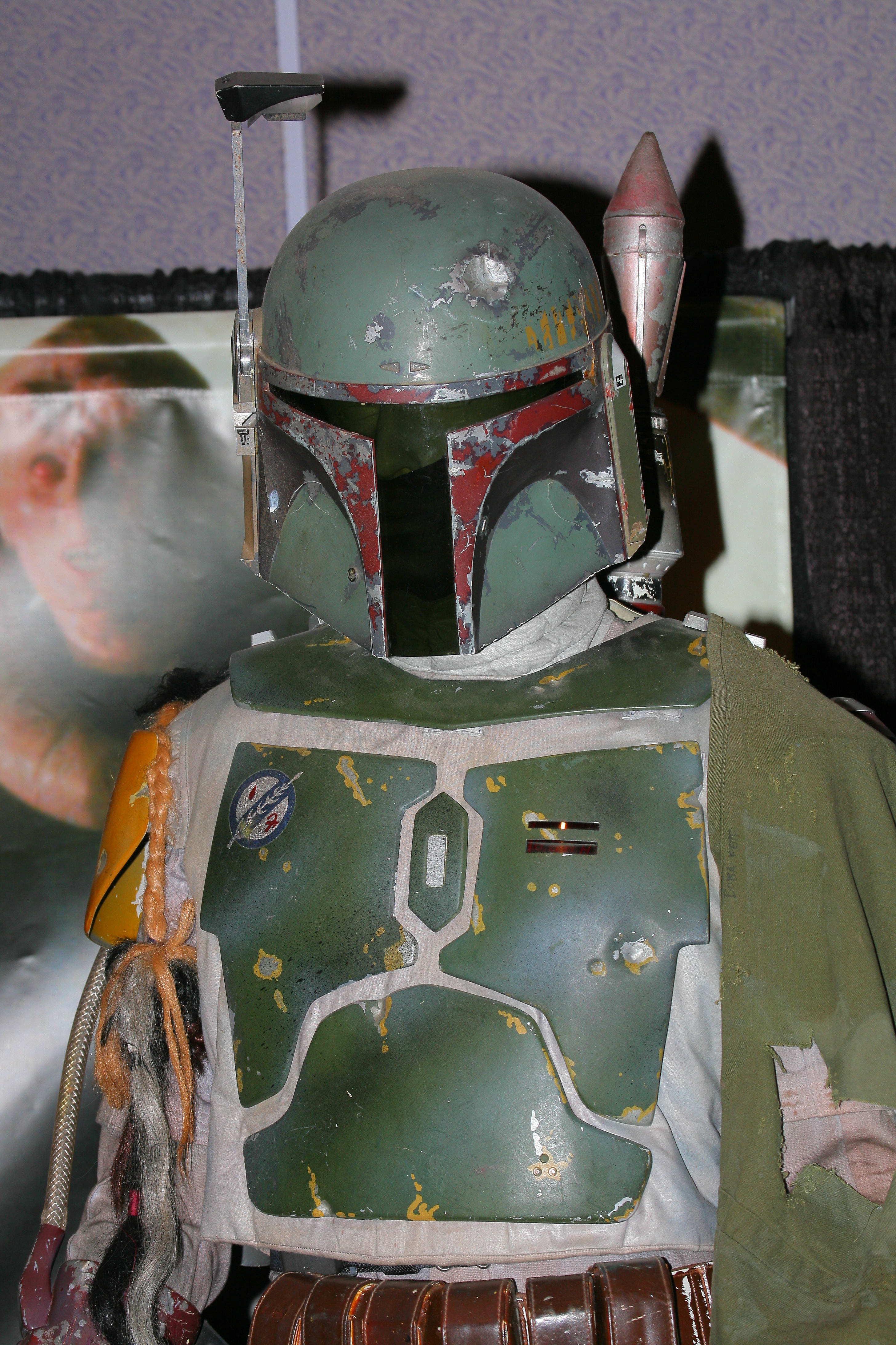

The jetpack 'rocket' is visible behind the helmet if the jetpack is positioned in an almost vertical position, which is possible only with a good jetpack frame with harness or any good substitute. But it also depends on the stance of the body, the viewpoint you look at the whole suit and other factors:
Note that the ROTJ jetpack is positioned much lower because the harness upper strap is much longer than the one on the Pre-Pro #1, but also the body position is different: the Pre-Pro #1 is leaning a bit forward while the ROTJ is in a straight position.
