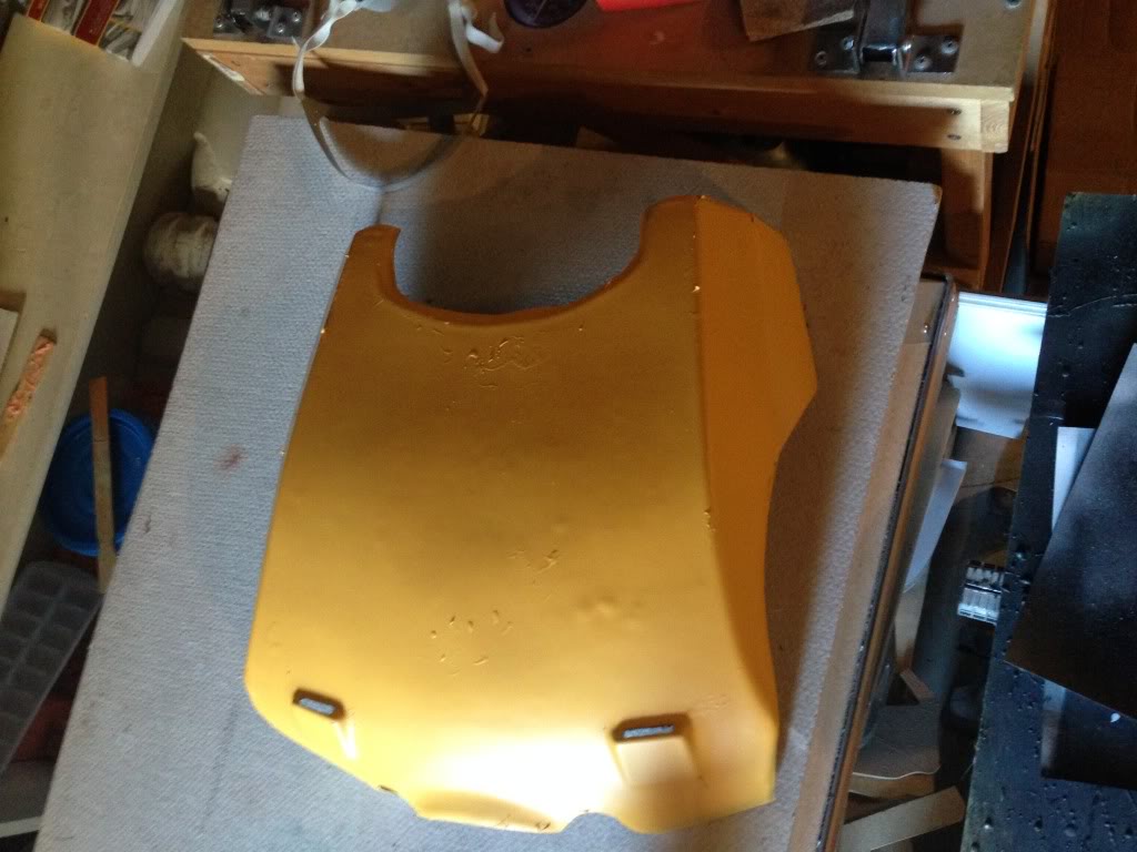

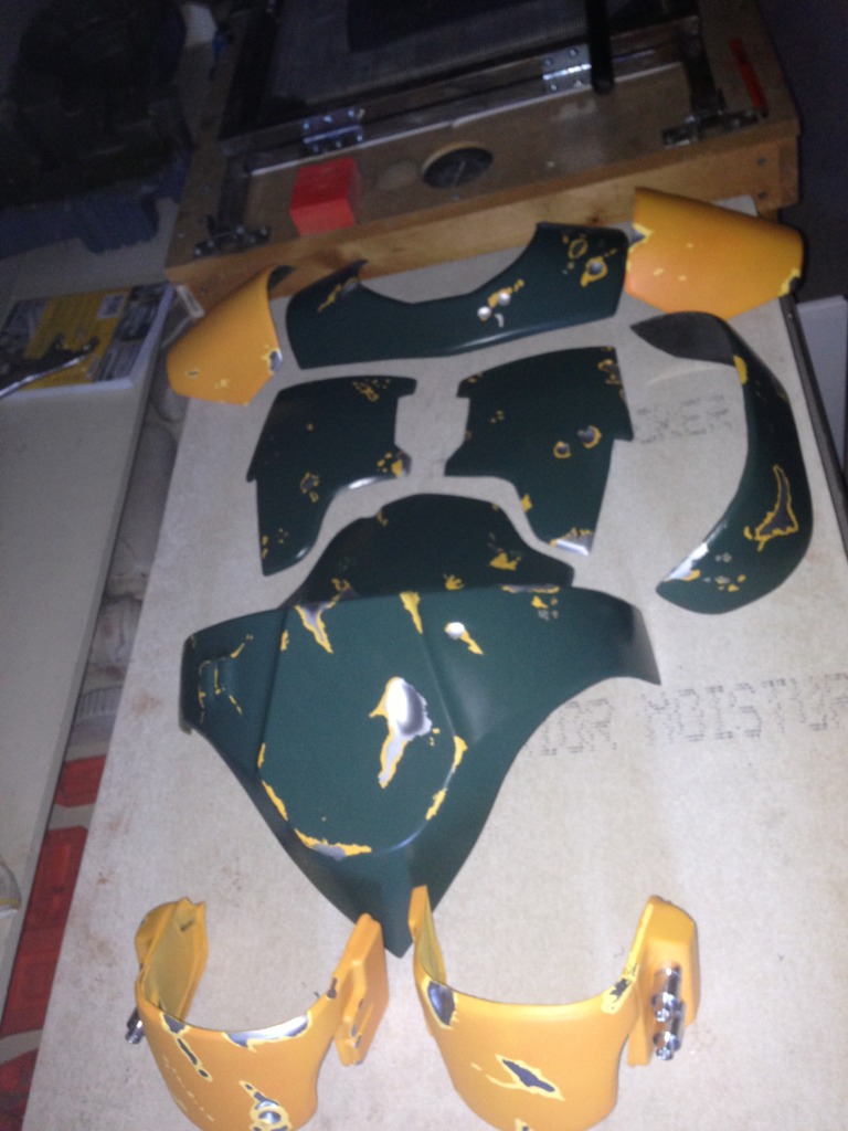

Here is the majority of armor parts pre final weathering.

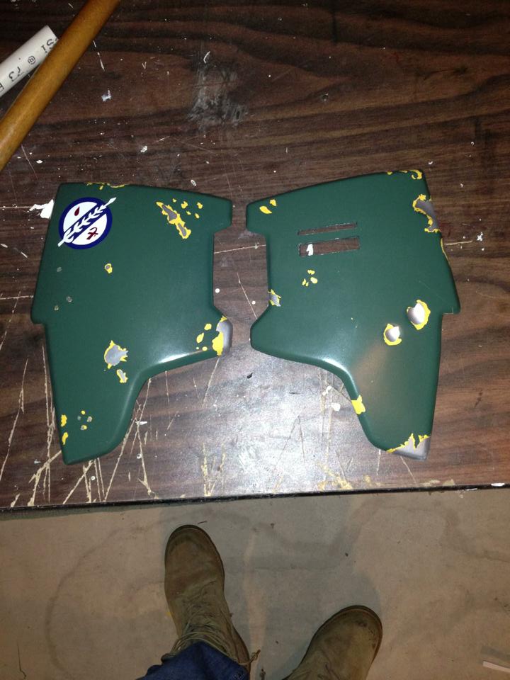

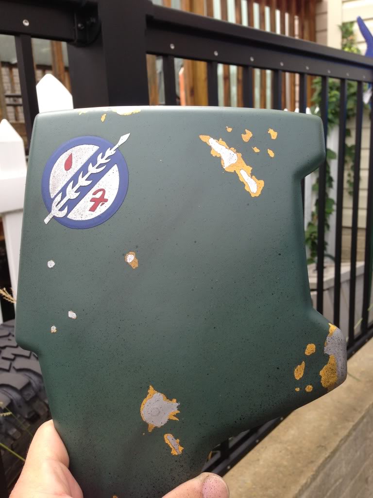

weathered the shoulders
Weathered chest, and sealed with clear matte.

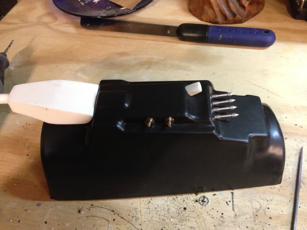

and started mocking up my gauntlets before paint
The weathered parts looks really good! Just a small comment regarding the right gauntlet: you should position the small white piece to be parallel with the gauntlet darts.

That is my goal. The white part is held in place with painters tape on the inside. I am still working on getting the fight to be just right. Thank you for the compliment.

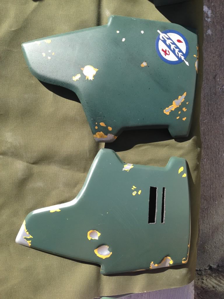

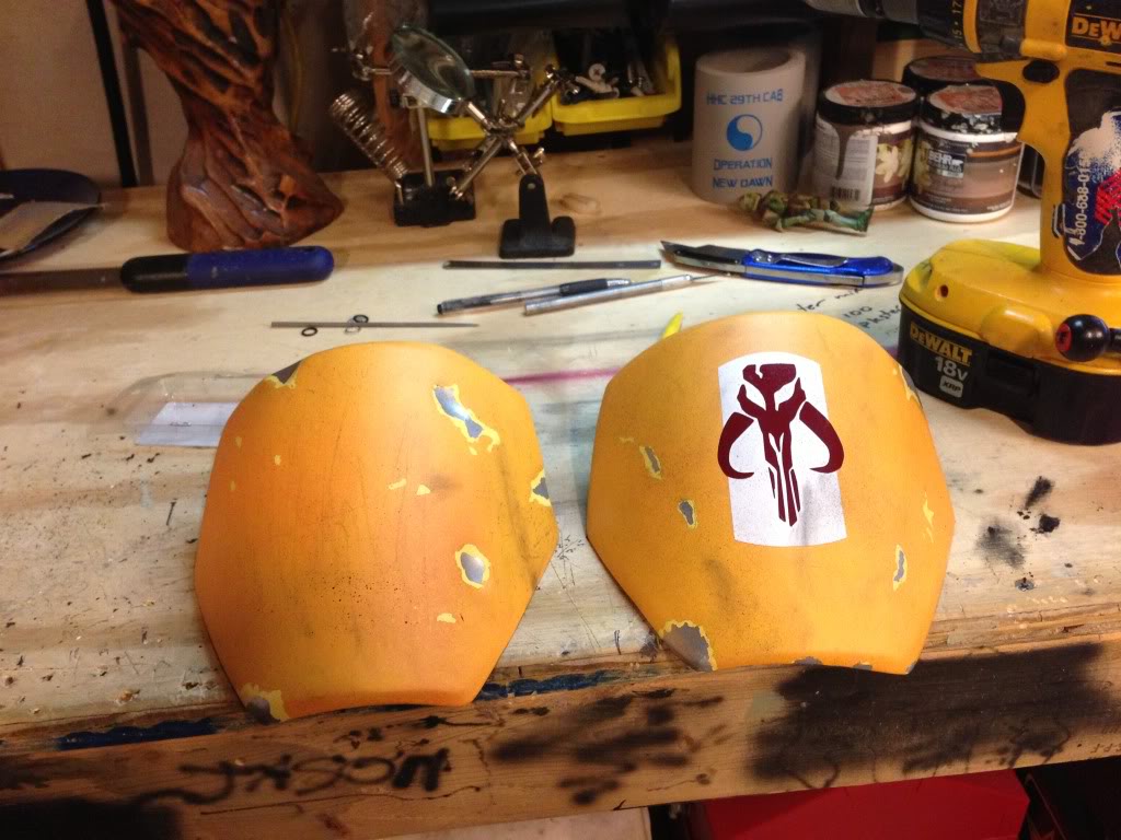

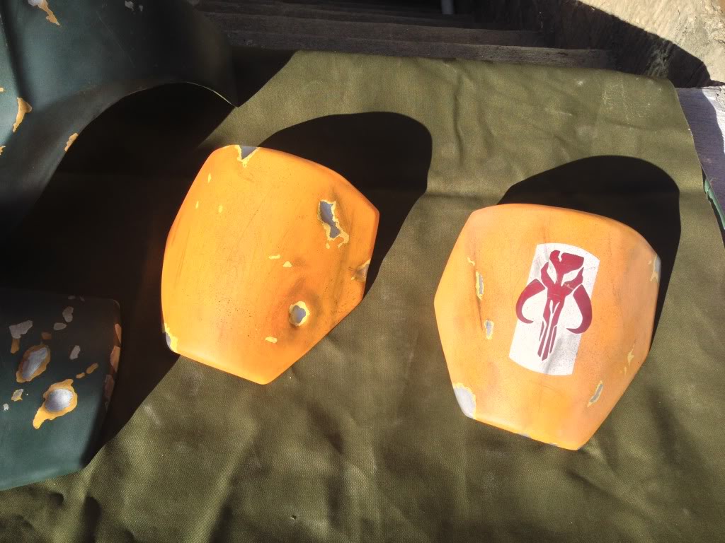

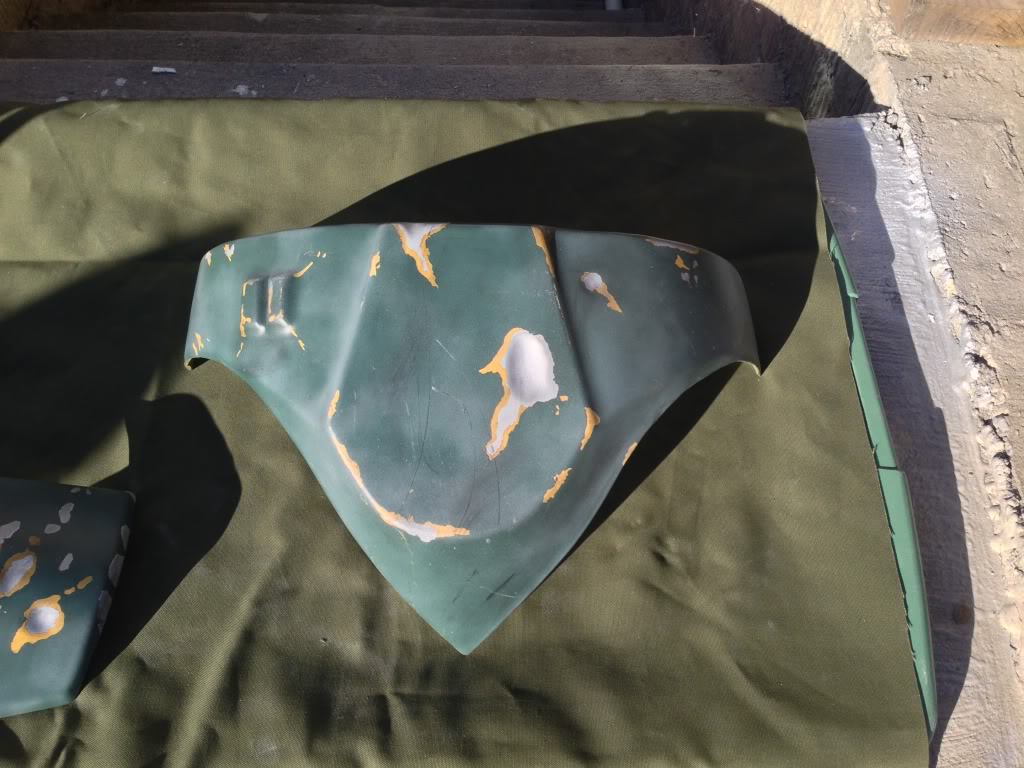

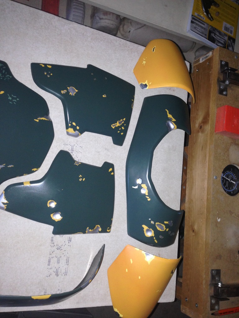

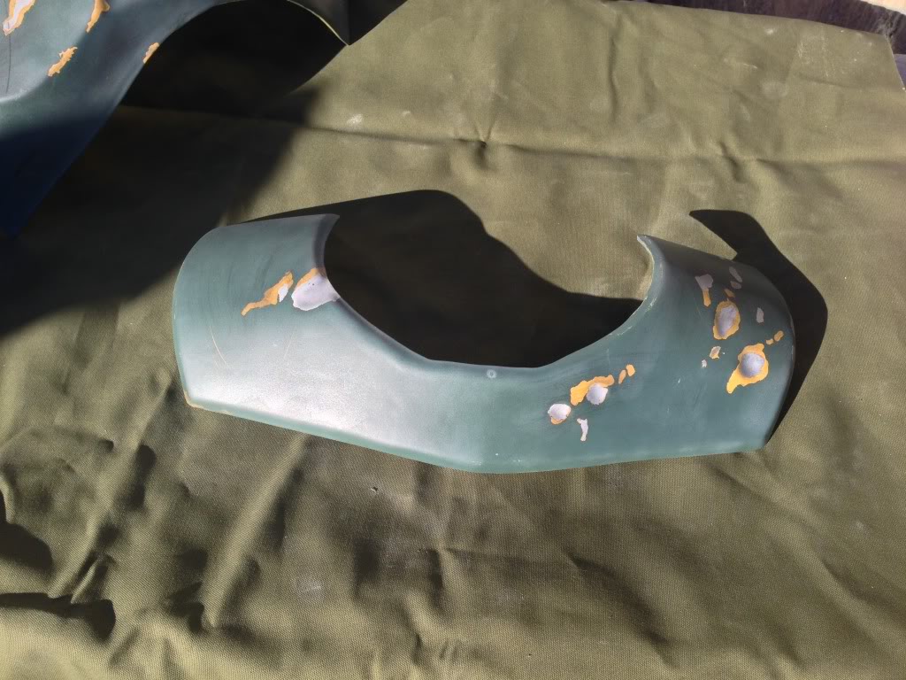

Just did some more weathering/sealing/painting.

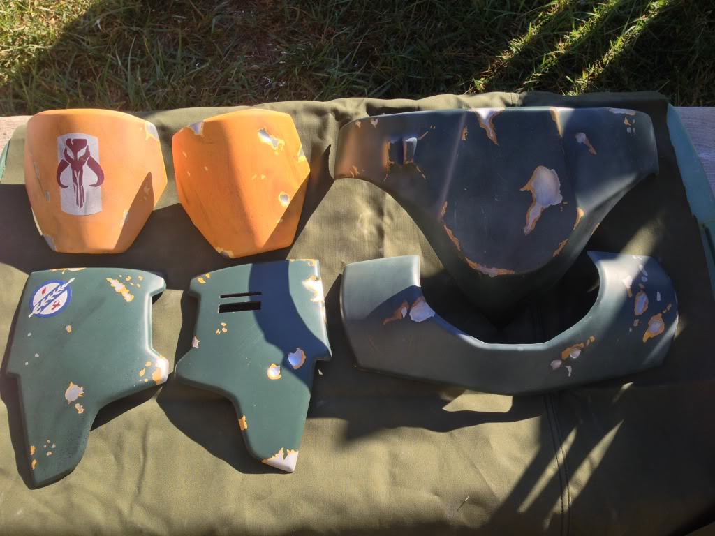

Please let me know your thoughts. Id like to be able to mark some of these parts done as I move on to the remaining parts. For color comparison, the parts are outside and on a OD green shelter half. I really hope to get this paint right with my limited skills at such a precise paint up. I really appreciate the feedback.

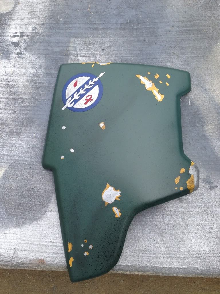

cod and collar- painted, weathered, sealed.

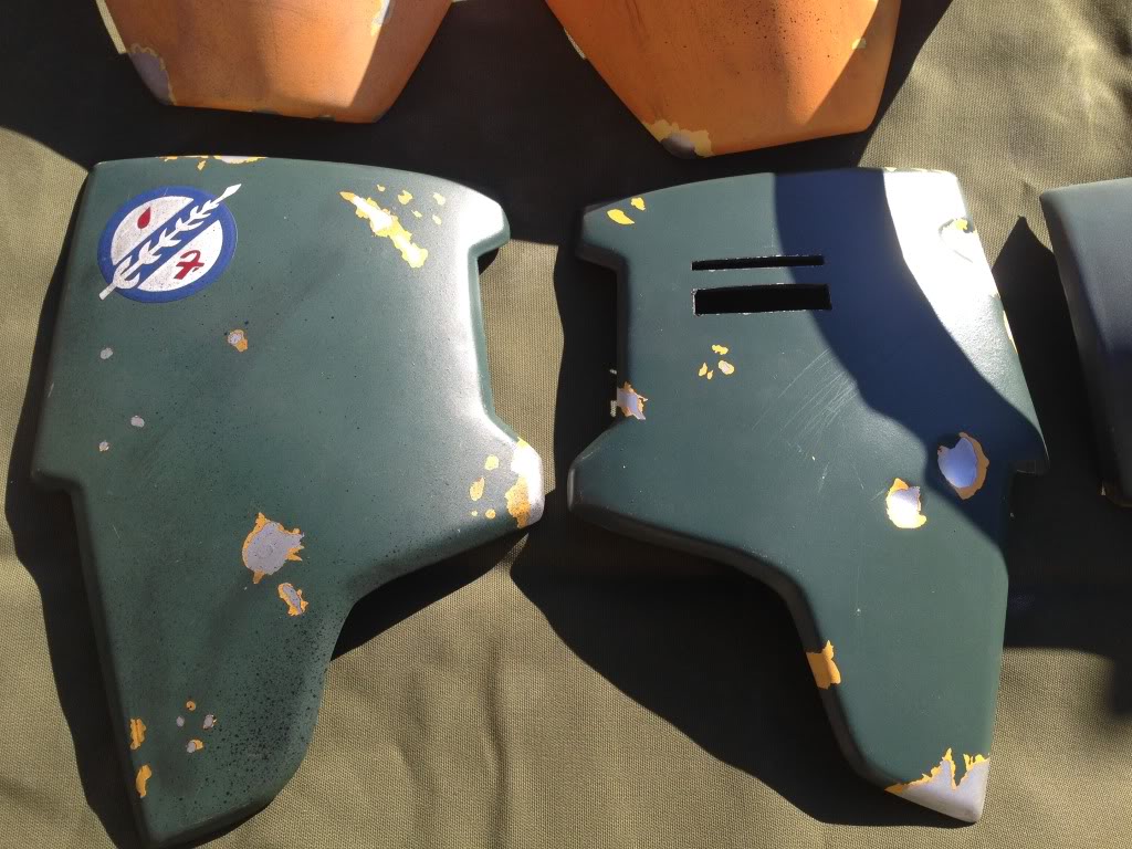

shoulders are reversed in pic, the one with decal(worn on left) is painted weathered and sealed. the other is painted and weathered.

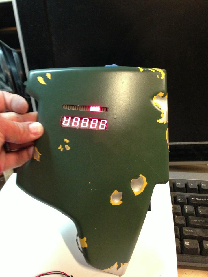

right chest, painted weathered, sealed
compared to other chest, still needs weathering by the display cutout.
All of them together

Looks great, man!!
Couple questions: What method are you using for weathering? How are you getting that fine scratch detail? I really like the cod, collar and shoulders. The right chest weathering looks slightly smudged in comparison. You can clearly see the direction of the weathering. Splatter looks good though!
Thanks, the weathering is a mix of techniques, black spray paint mist, charcoal, sand paper, x-acto blade, fingernails.

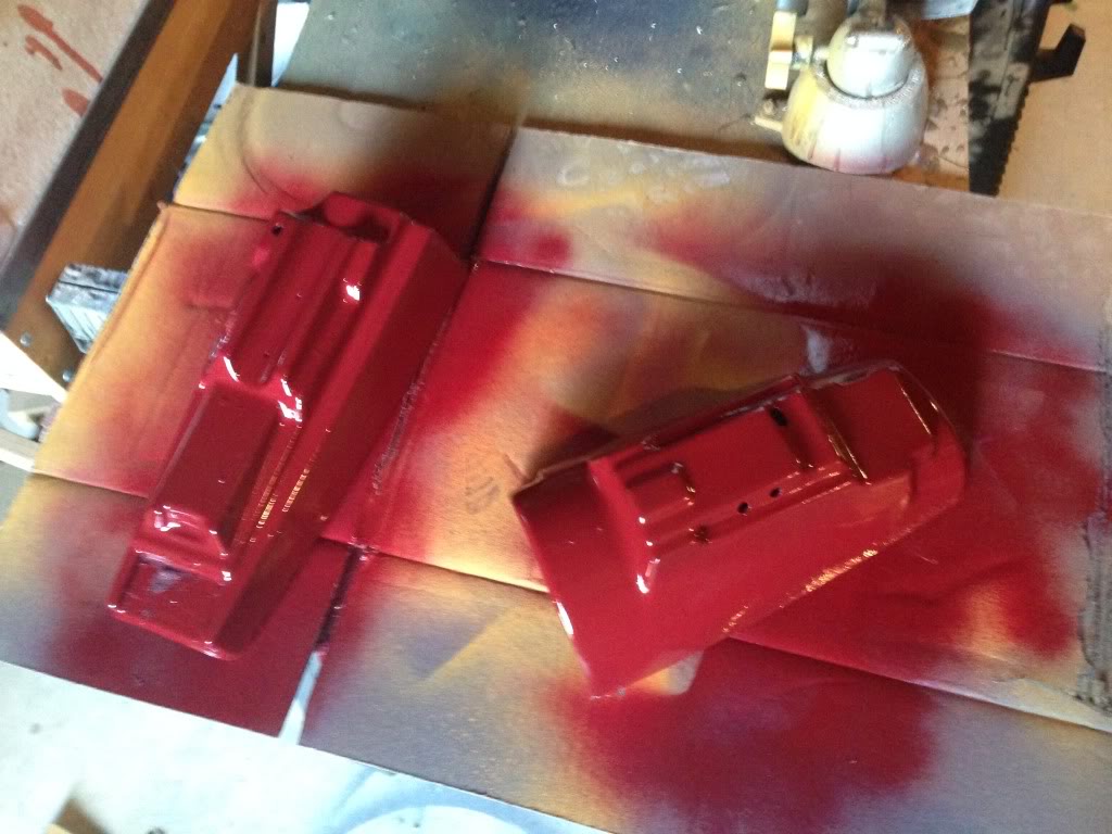

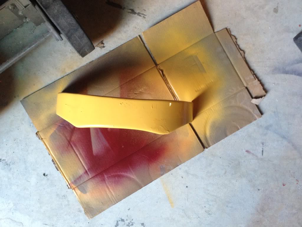

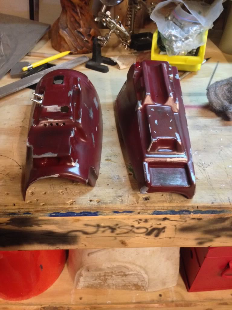

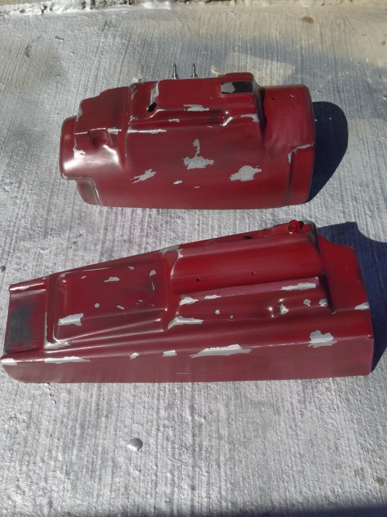

here is an update for gauntlets
I lightly sanded the Silver layer because it has a clear coat in it or something that makes it real smooth but only on the areas not getting masked off.
