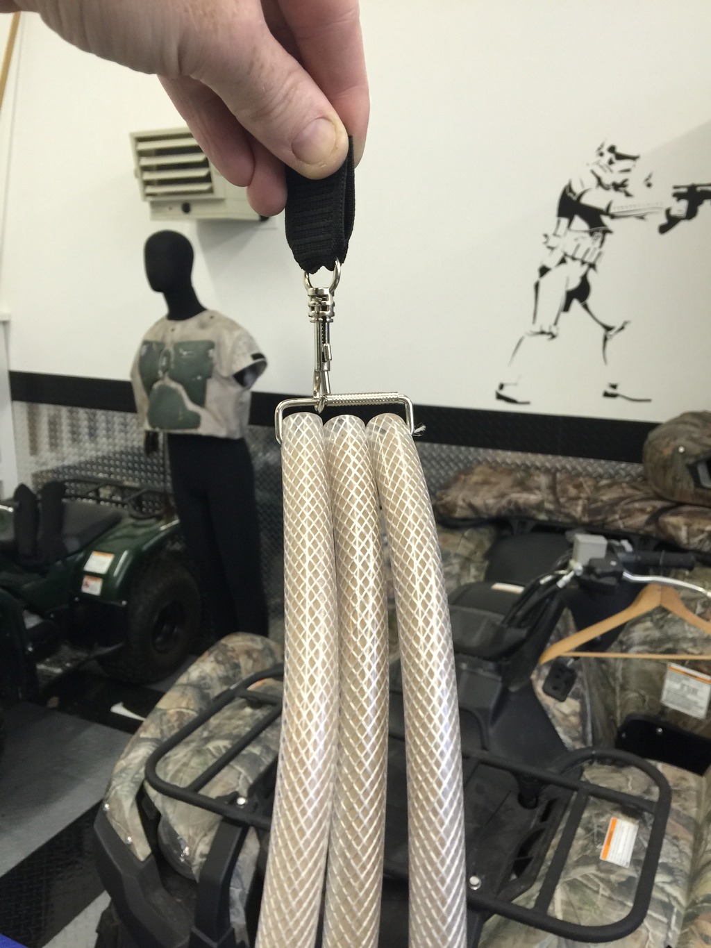

So got around to working on how I'm going to add my hoses. I had them dirtied up then decided this as my attachment method. The elastic will just be sewn to the flightsuit
