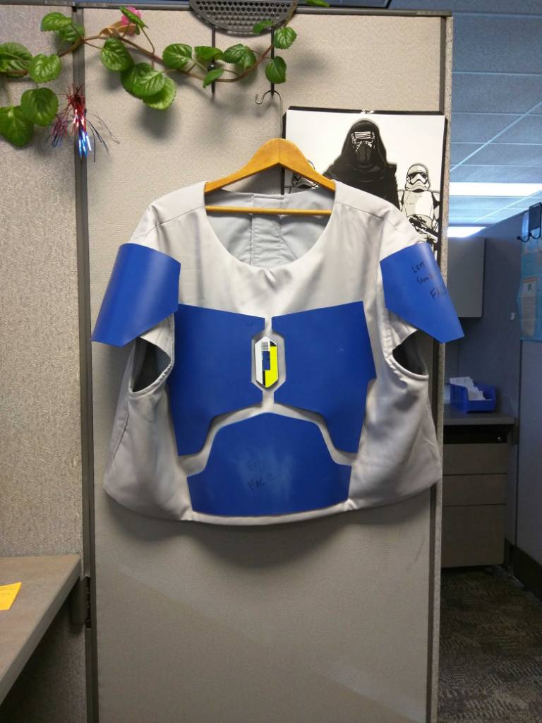

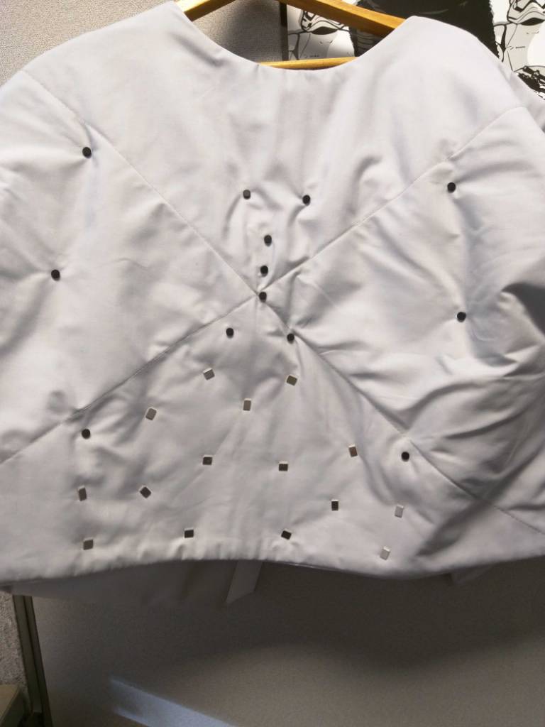

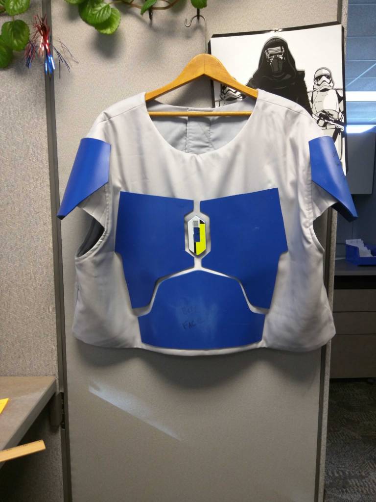

So I started a thread over on theBHG.net but thought some might not have acess there so I thought I'd throw it up here. I'll post updates here as well and try to put the other parts up as well but hey I just got my suit and vest from Arkady today and I'm Happy with it IMG_20160915_174438.jpgIMG_20160915_174503.jpgIMG_20160915_174214.jpg

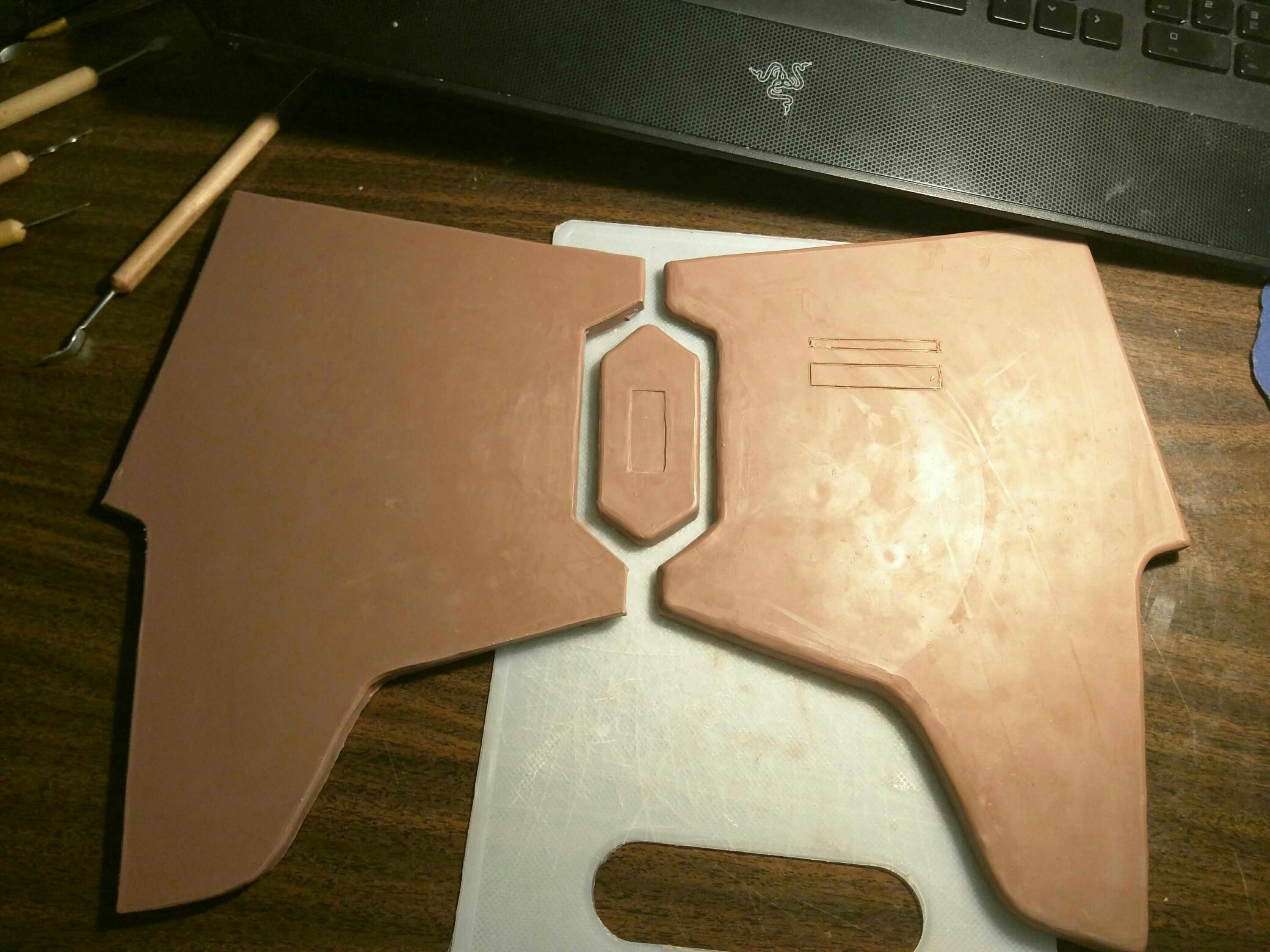

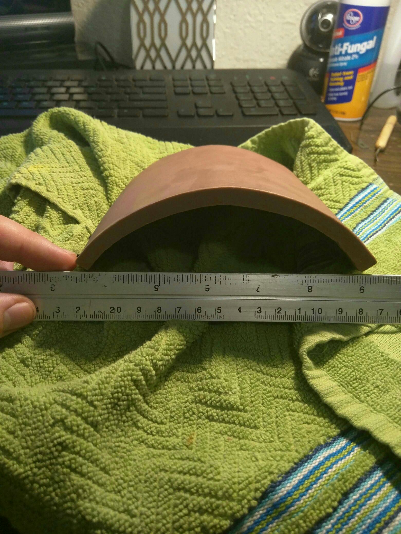

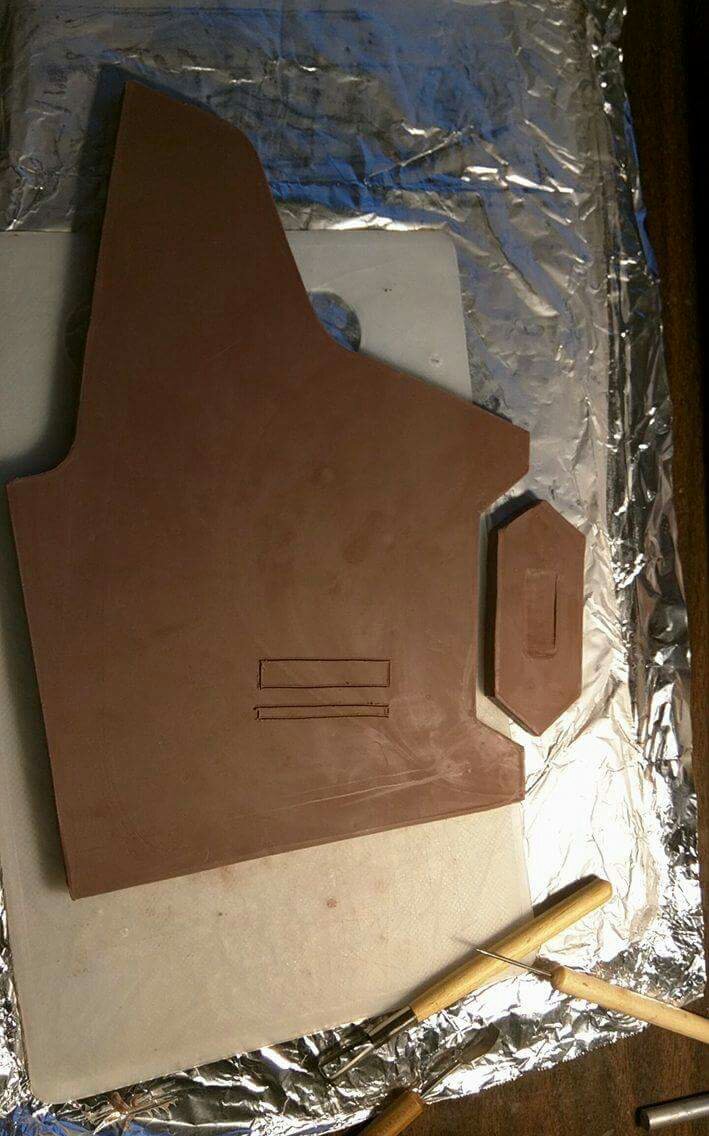

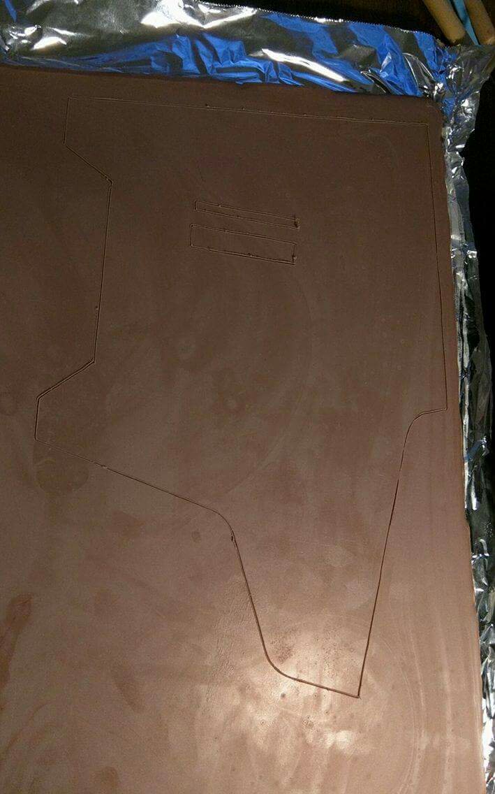

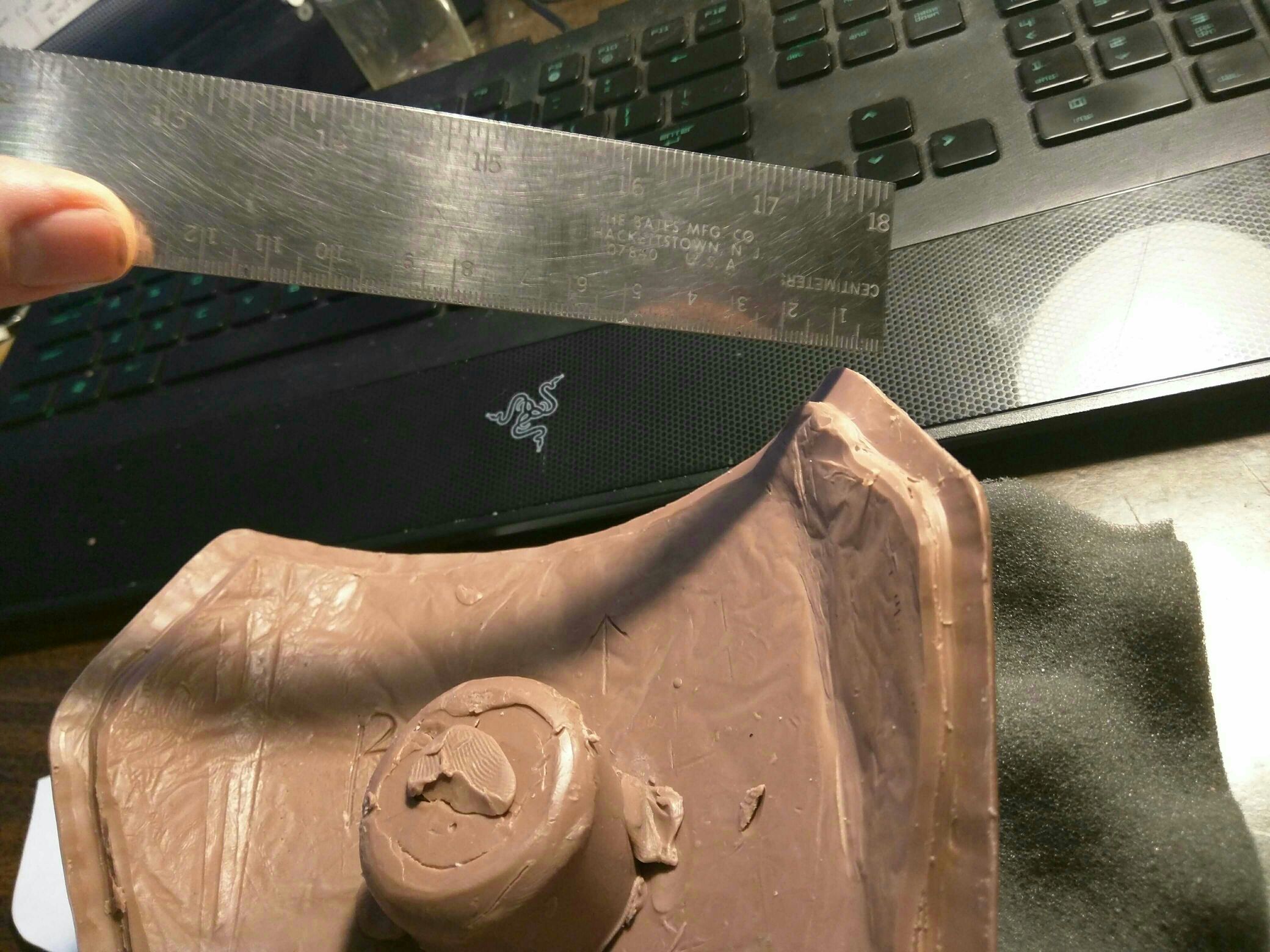

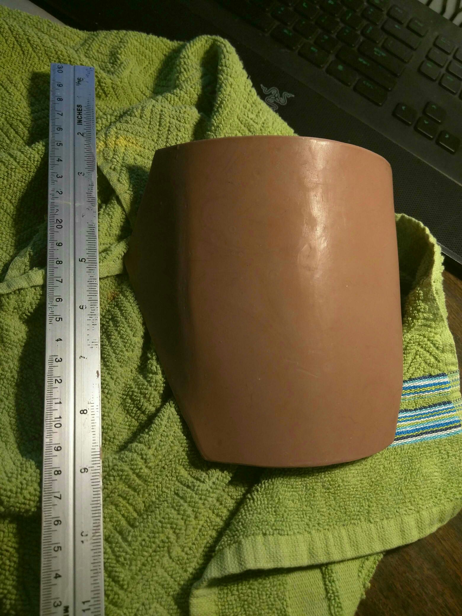

Made all the upper chest armor out of clay and ended up molding them in silicone and then cast them out in fiberglass Havent taken any beauty shots of the pulls from the molds.
tapatalk_1474267416599.jpegtapatalk_1474267454873.jpegtapatalk_1474267492420.jpegtapatalk_1474267506457.jpegtapatalk_1474267518776.jpegtapatalk_1474267552727.jpeg

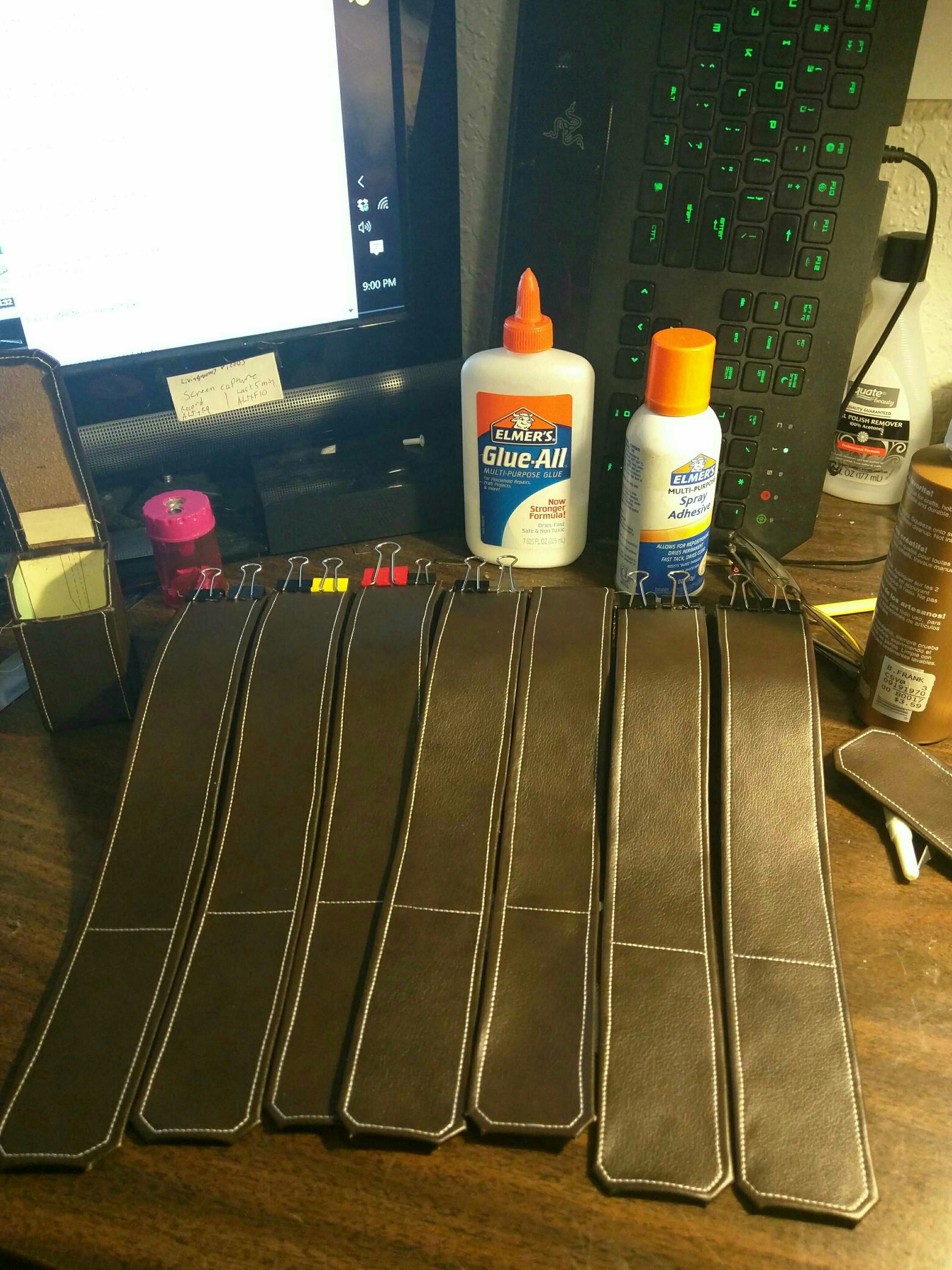

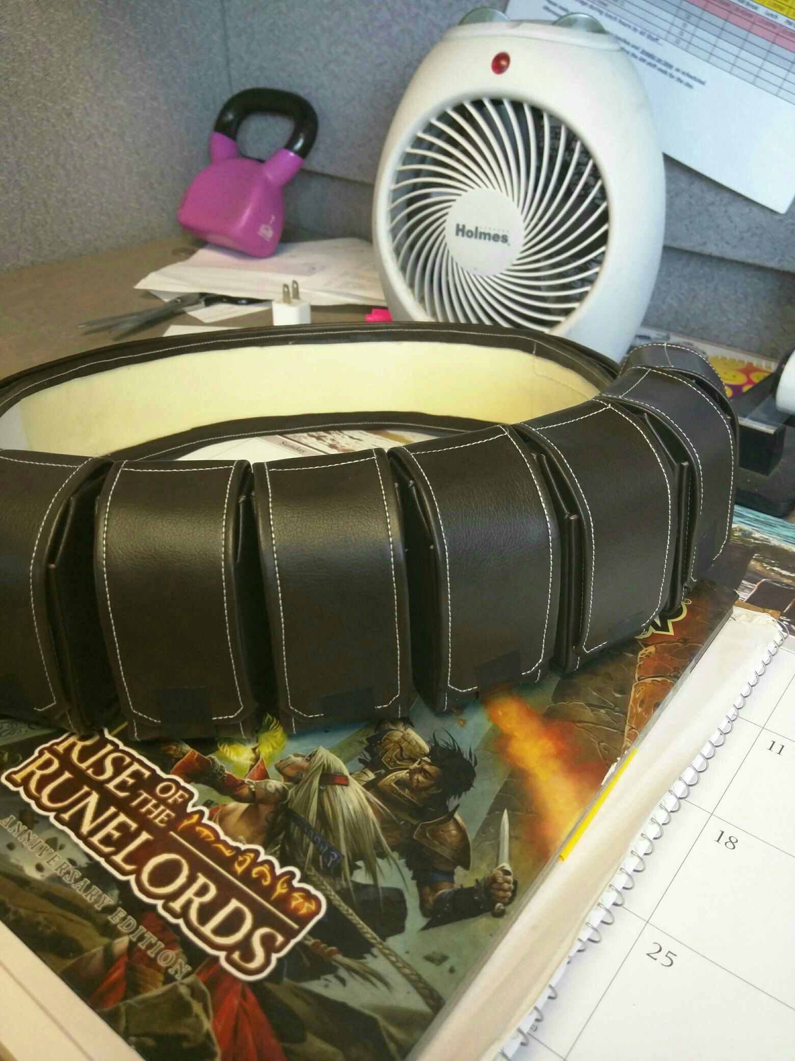

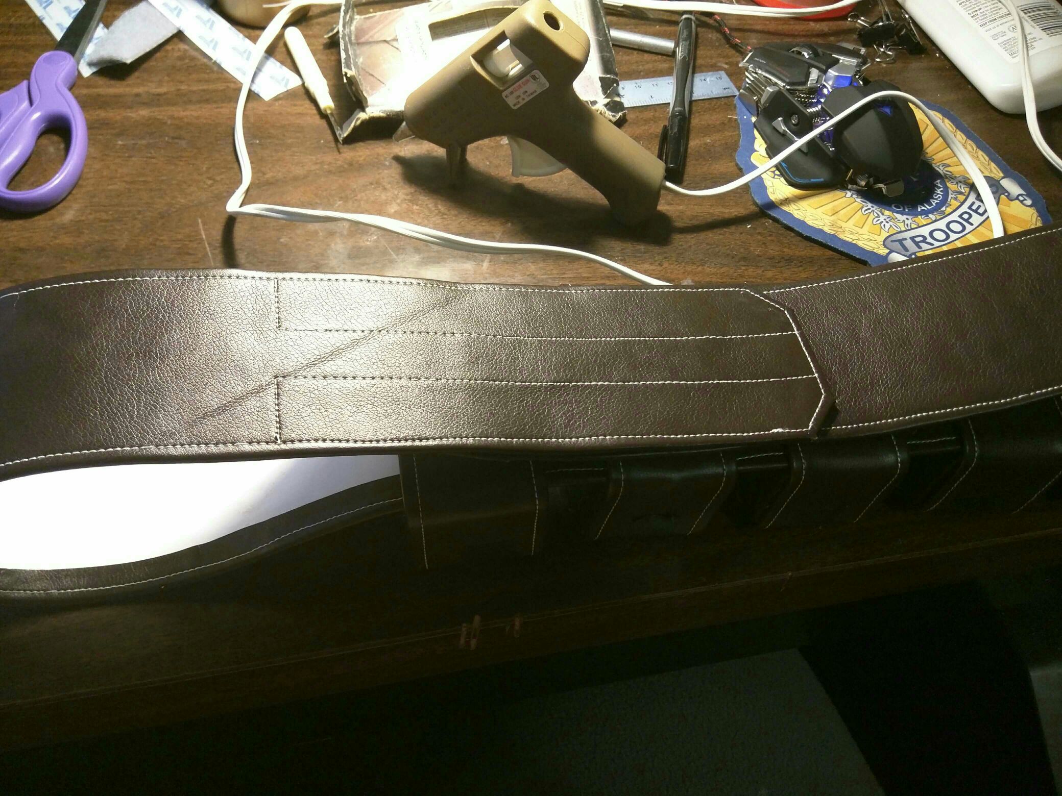

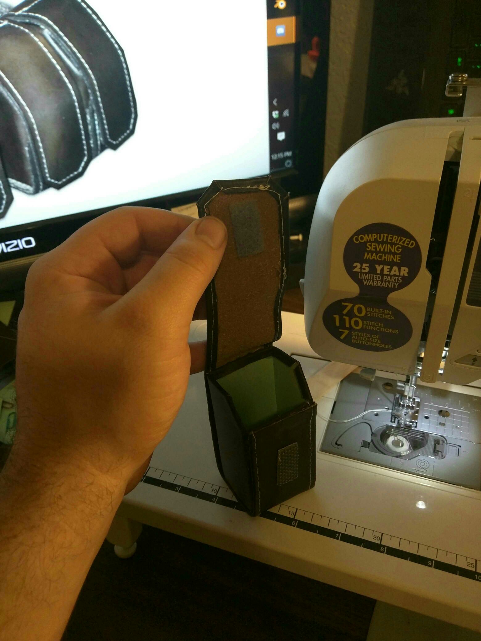

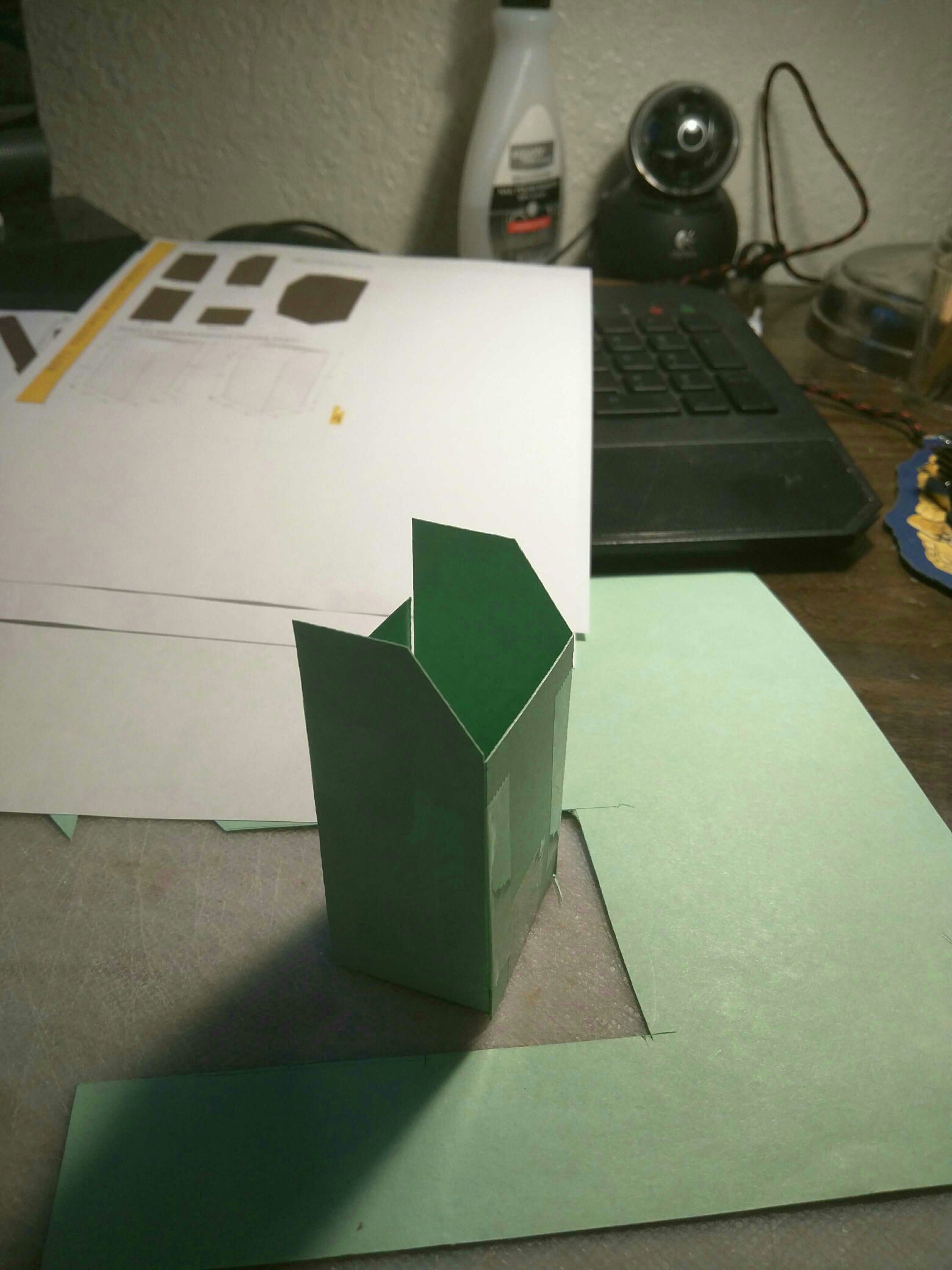

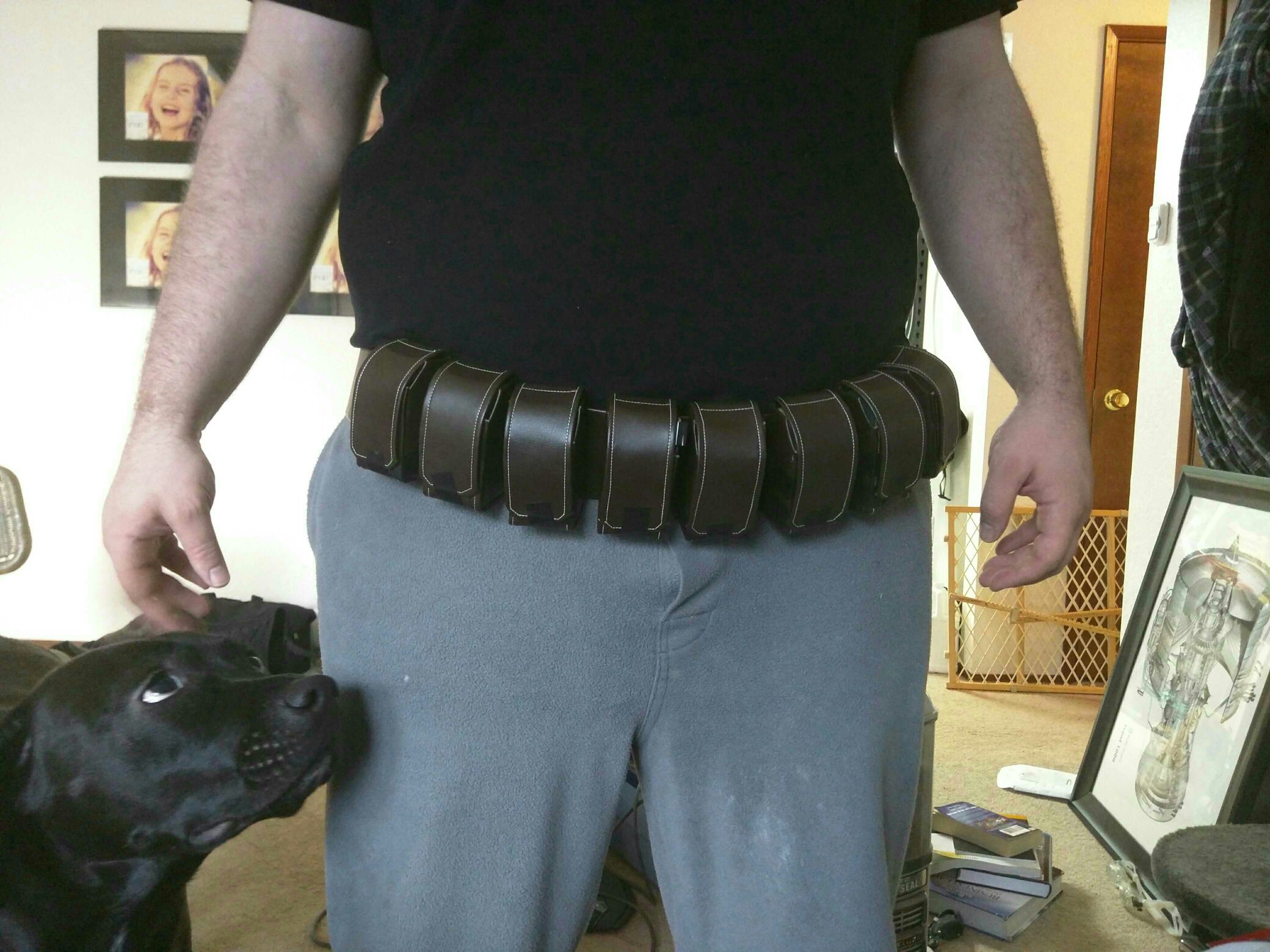

made the pouches more practical by wrapping cardstock templates in pleather and then assembling. FYI a sewing machine will punch thru 2 layers of pleather and 2 layers of cardstock. just take it slow
got the magnets in for the pouches will be attaching them soon

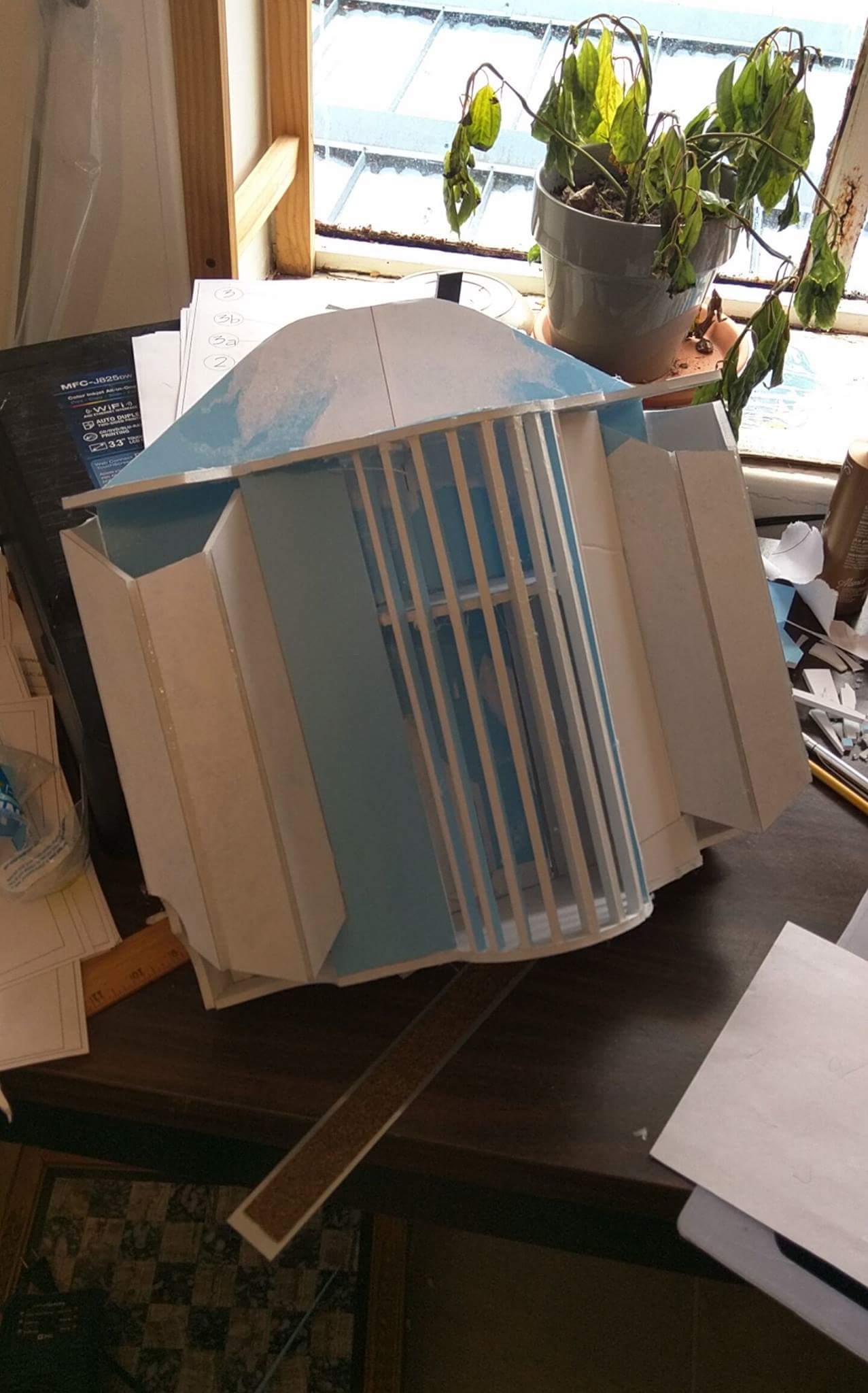

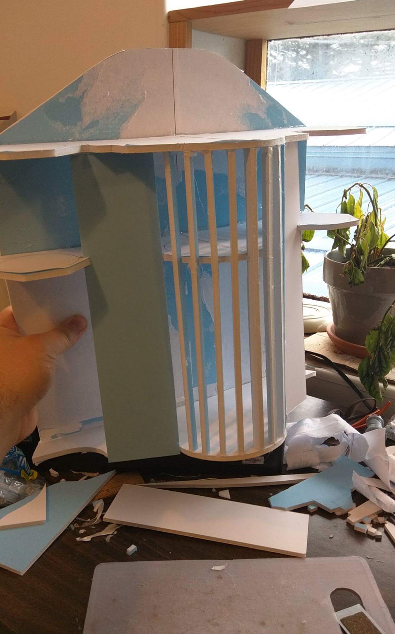

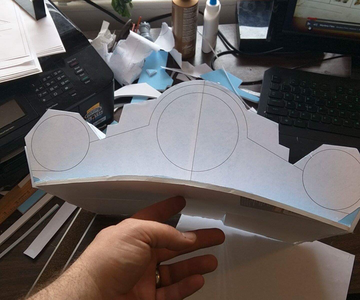

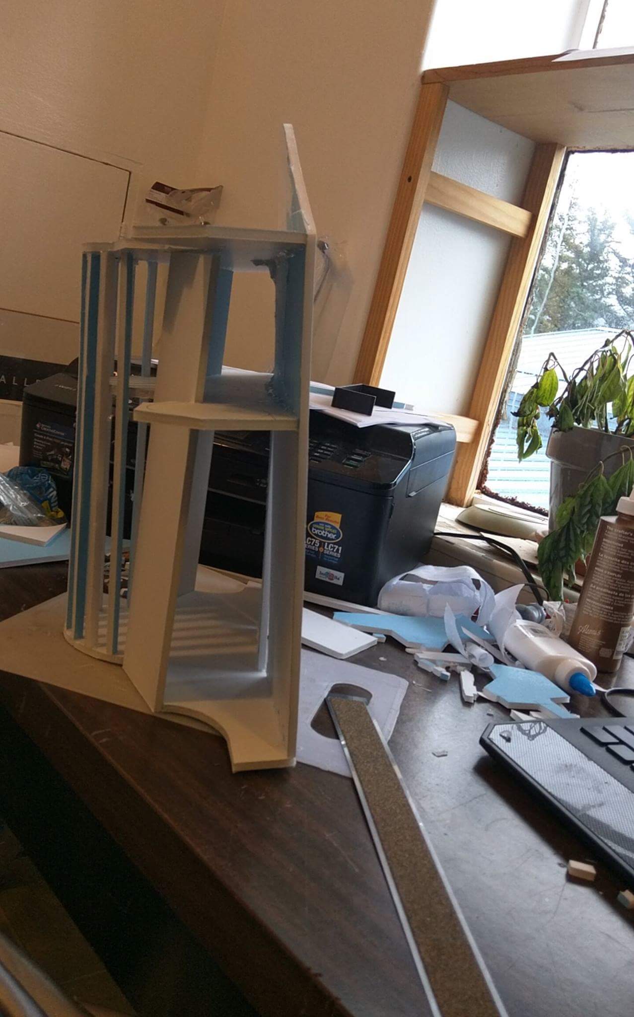

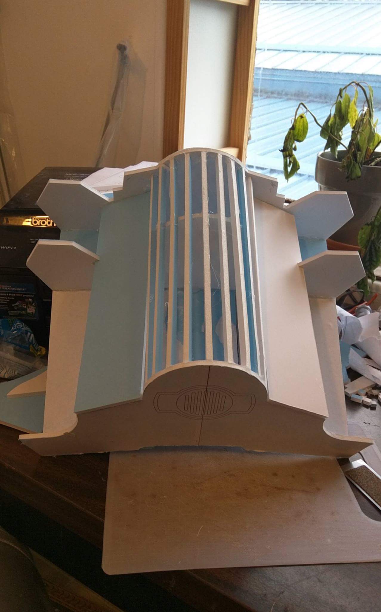

Beginning of my jetpack assembly using WOF's templates

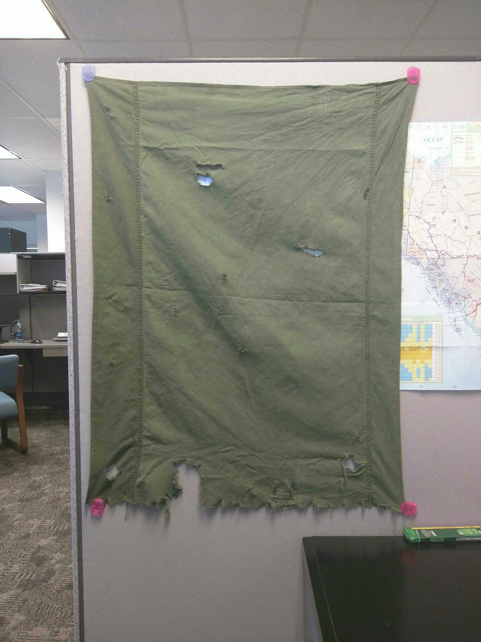

Physical weathering done on the cape now I get to make it dirty. going to do all cloth weathering at once though to make it consistant. other than the paint on the armor and helmet of course.

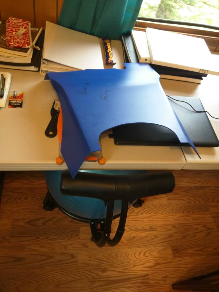

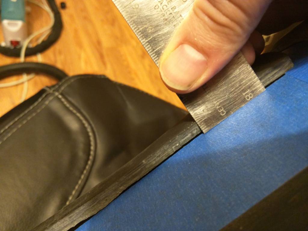

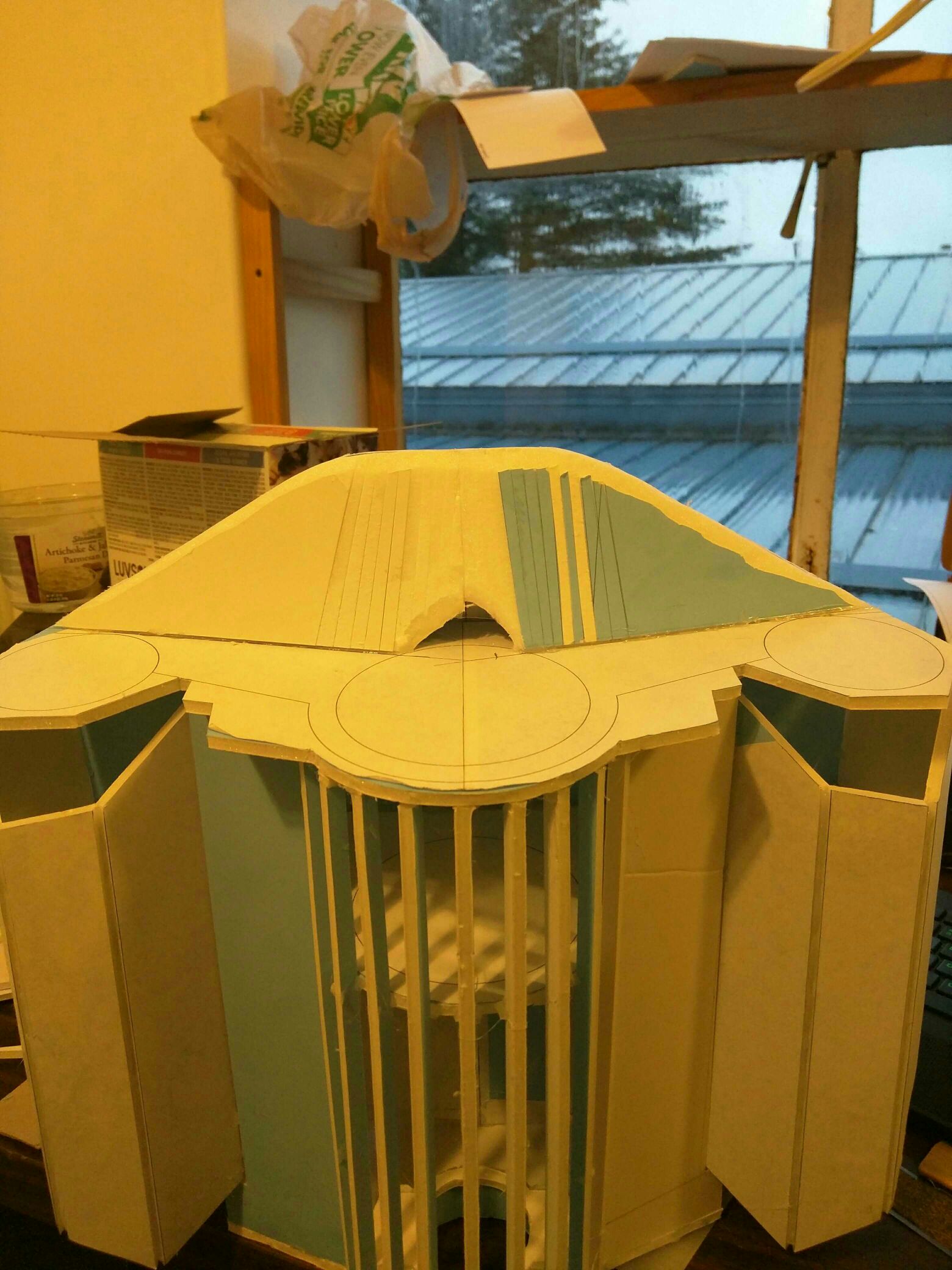

Kinda dreading the back panel of armor. got a trash bin and have it cut out. now to flatten it so that I can bend it into shape :(

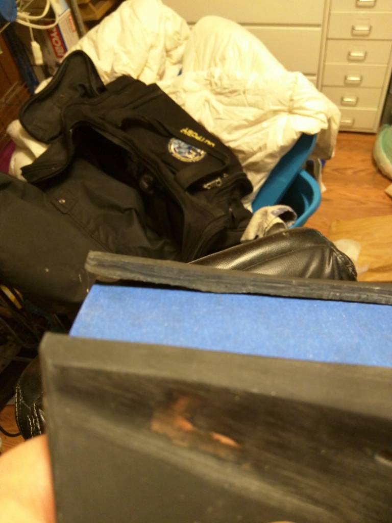

Made a good score at my local sign shop they happened to have a piece of 1/8" sintra that had a few dents in it like someone set it on the floor and a few nails had popped up. lots of fine little scratches on it. 4'x6' sheet of blue. gave it to me for free cause it is worthless for making signs!
I am one happy Boba right now!

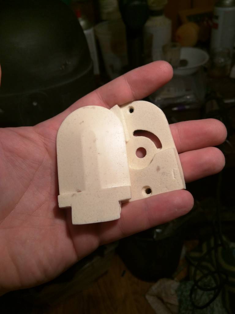

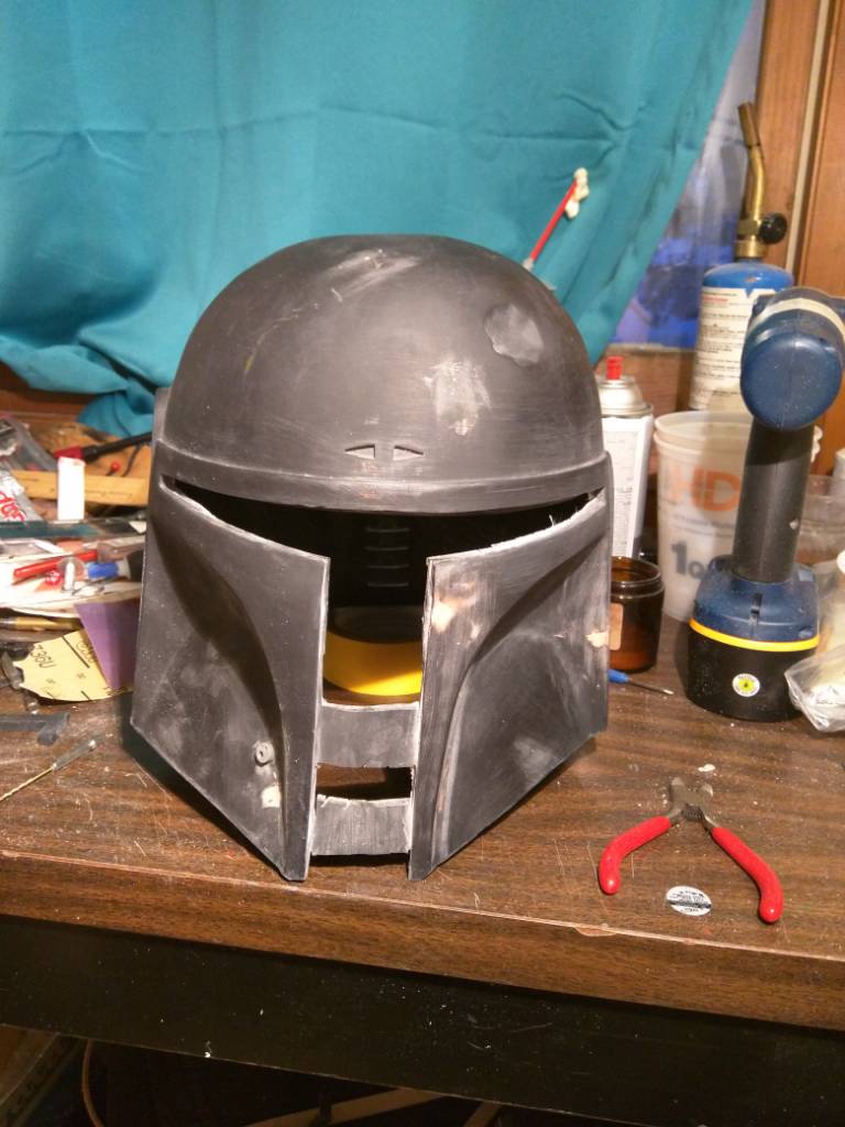

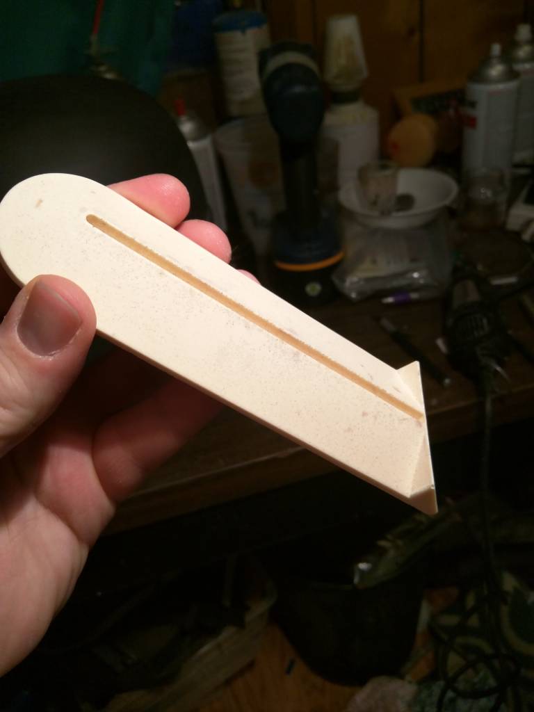

I recently received my DVH helmet and it looks awesome. I cut out the visor minus a couple of support bridges. and have started to bend the lens to shape. however im a little lost on the best way to attach things like the ears or the right ear cap and how to properly install the Borden connector. Also how far does the Borden connector sitck out????

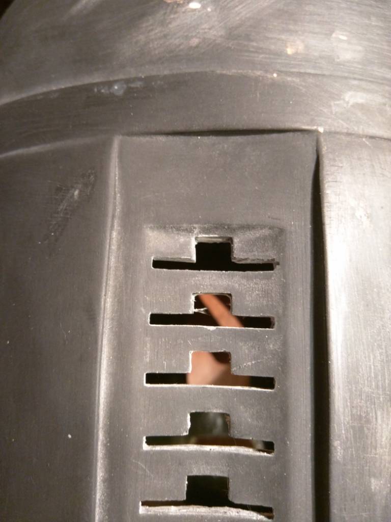

im kinda dreading cutting out the key slots as small as they are.
If anyone knows a good build thread with the DVH helmet id love to hear from you.

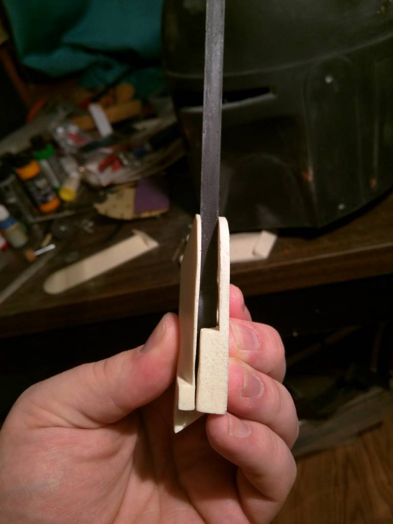

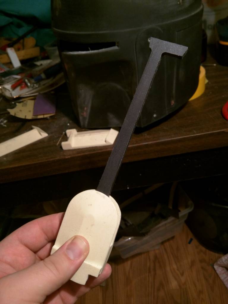

Gonna have to thin down the stalk a bit I think and I got the Borden connector "placed". Tiny bit of fill work on the helmet and a bunch of small pinholes on the ears to cover with a bit of bondo but otherwise I'm super happy with this DVH helm.
What do people like to do to take care of the fiberglass strands left over when you cut out things.

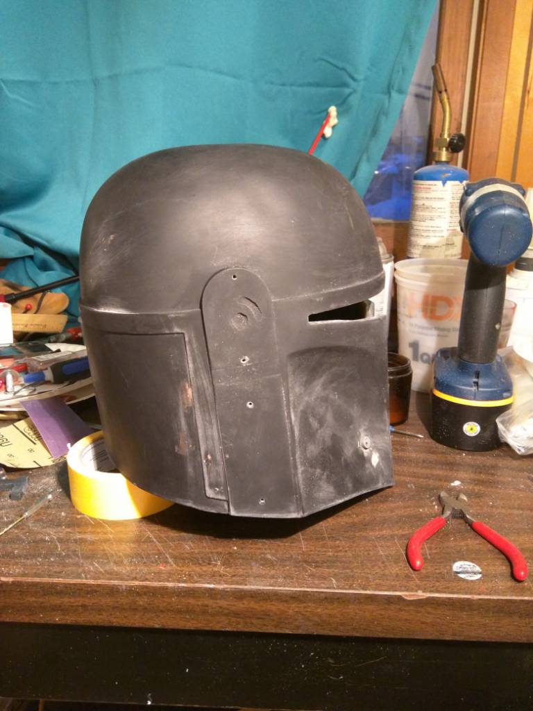

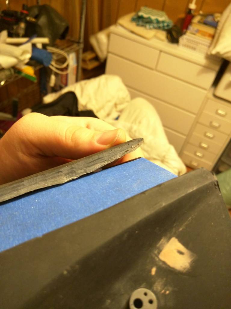

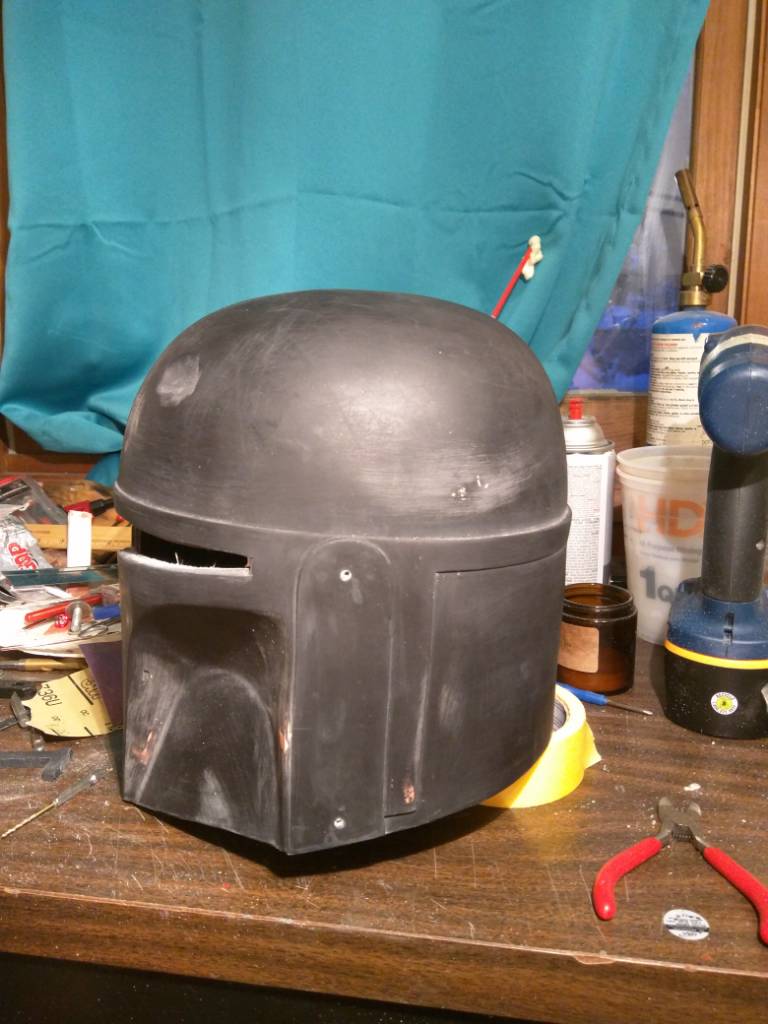

Got my dvh helmet in and the visor "installed". But there seems to be one issue. Idk if it's really an issue or not though or if I should just push some Bondo in the gaps and make it pretty. Thoughts?
Sent from my Nexus 6
Take some sand paper and sand them off. The leftover strands will sand away easily.
