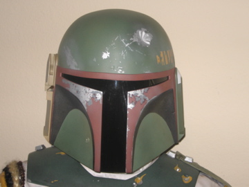

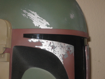

Thanks to my good buddy Spideyfett I am now the proud owner of his MSH2

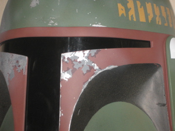

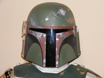

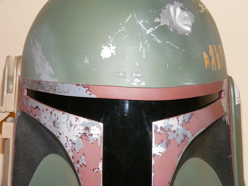

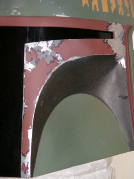

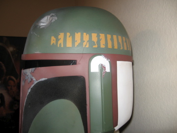

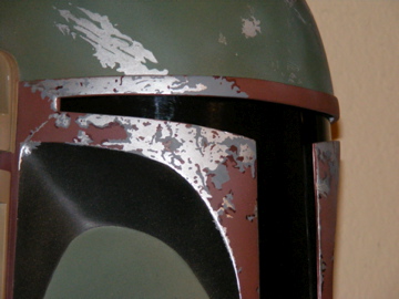

so I thought I would update this thread and show my progress on getting this bad boy painted
