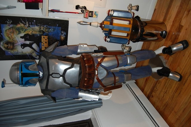

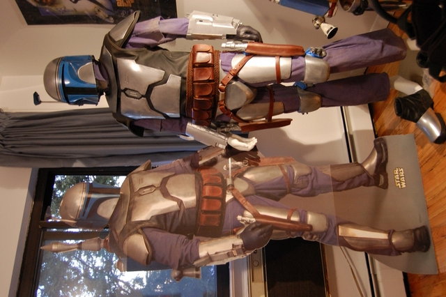

Got a good amount accomplished tonight. Filled the cracks on the MOW's (thanks Cruzer). Dressed the mannequin (DAK) with everything i have so far. There are elements being held up by tape. Here are some pics! This is the first time i have seen this much all up together! :)
95% done i would say.
Here is what i have left to do:
-weather r&b on helmet.
-finish westars
-r&b silver on boots and attach foot armor
-attach darts and accessories to gauntlets
-get other glove haha!
Parts I still need!
-BACKPLATE
-SHINS ($$ is low low low now that school has started back up for me and i don't know when i am going to have extra cash laying around to get the best stuff so this is where i might need to get some lower end parts. Not too big of a deal though. Any suggestions on where to pick these up?
ALSO! (might be a dumb question...) but how do i attach the holster belt to the cod? velro? or some sort of adhesive. I am also trying to figure out a good way to do the knees without having to put straps through the inside of the suit. Open to suggestions. Thanks again everyone!

I removed the nylon belt from the holster assembly, discarded that, and have 2 screwposts/chicago screws going from the front leather holster tab onto the inside of the girth belt. The two rear most holster supports are attached to the inside of my girth belt with snaps. I also used 2 of those screws to hold the cod to the girth belt maybe 2 inches in from each end on the cod. Place the scews carefully on the girth belt and they will never be seen tucked behind the individual cords.
any opinions on how to attach the holster belt to the top of the cod? velcro? or something like E6000 adhesive? I'm also curious about the best way to attach the thighs and knees. I was thinking velcro for the thighs.
The trick but most involved way would be to run a chicago screw through the leather d-ring holder stap and back of the d-ring holder. Position the d-ring holder in the desired place on your cod, outline, and drill a small hole. Then secure the d-ring holder to the cod with the chicago screw. I prefer things to be removable if necessary later on. You can keep the hoslters attached to the cod for storage purposes, and then you can use the webbed belt from the holster assembly to put-on your cod, holsters, and thigh pieces if you attach them to the holsters using the chicago screws from the holsters (another idea from Seeker). Placing the webbed belt from your holster assembly over your vest will help keep the vest in place and help keep it from untucking too much from under your girthbelt when trooping. Also, placing a chicago screw through your d-ring strap and backing will keep the d-ring strap centered and stop it from sliding back and forth.:thumbsup:
