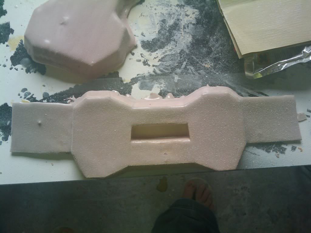

Now, basicly. You take 1 part filler(Bondo) and 1 part resin. Mix the too to make a grey(usually) thick liquid, then add the hardener which in most cases is the red paste. The red paste changes the colour of the filler/resin mixture to a dirty pink/red colour. This is great as you know when you've added the right ammount of hardener by checking the colour of the Rondo mixture as you stir it all up.

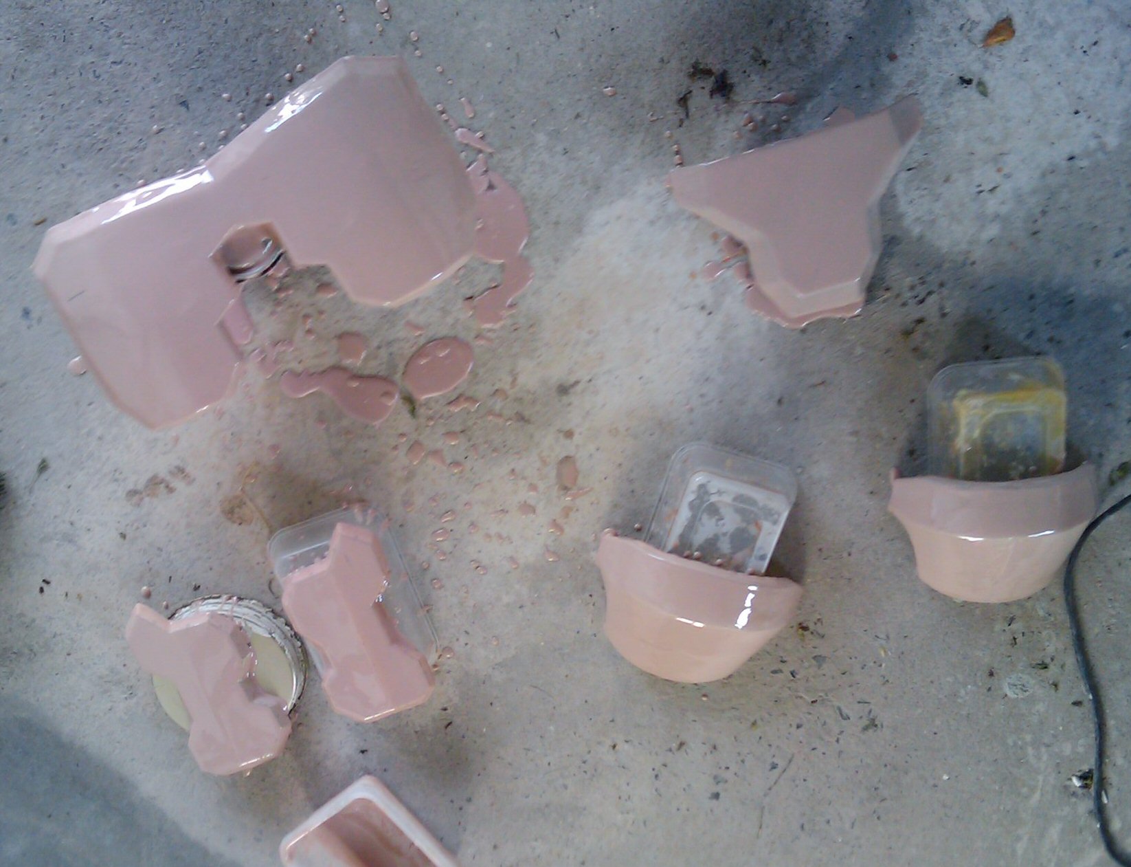

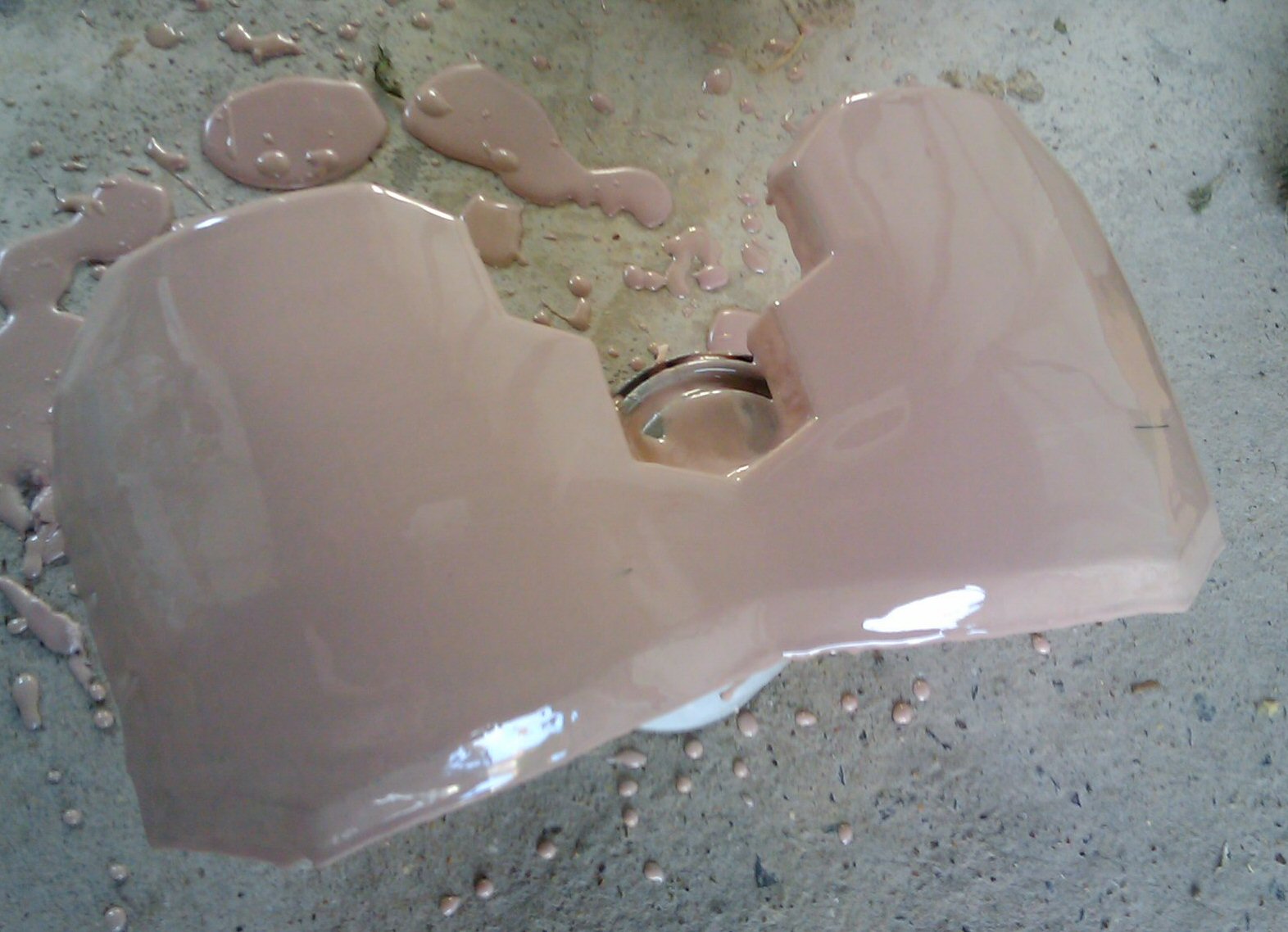

Now, the mixture is very runny so what they 405th guys say is to simple mask off any areas you don't want covered, then pour the Rondo over the piece to be worked on.
I tried the pour method first and although the result was great, I was very unhappy with the mess and waste caused by the excess run off. So I put the piece asides and mixed up a new batch of Rondo to continue with other pieces or my armor.

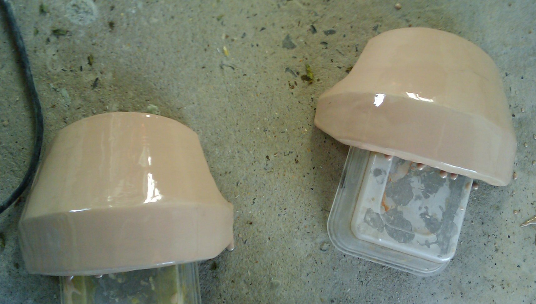

This time I applied the Rondo with a brush as it's runny enough I thought to be applied that way.
I started with my chest plate, coverage was good and because the Rondo is thick but runny, the brush strokes quickly vnished as the Rondo spread gently over the piece. There was very little run off and waste. I then continued with the same batch of Rondo to cover my ab plates, shoulders and cod!
Like I said, very little waste and mess, PLUS I covered a load more pieces whereas the first batch(both first and second batches were the same ammount) only covered my butt plate and I wasted loads!

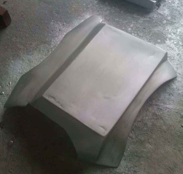

Great news!!!!
You can see the pics above of the butt whcih I've started to sand a little now. You can also see how smooth my other parts are after being Rondo'd with a brush.

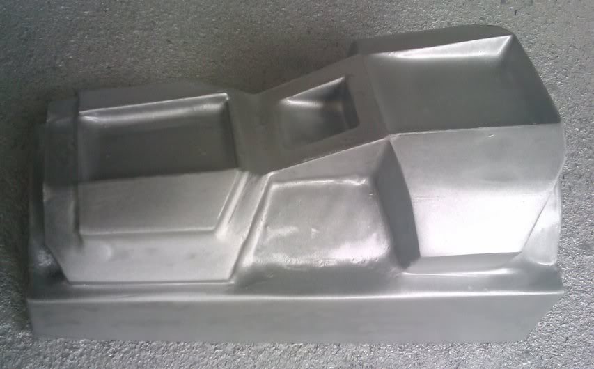

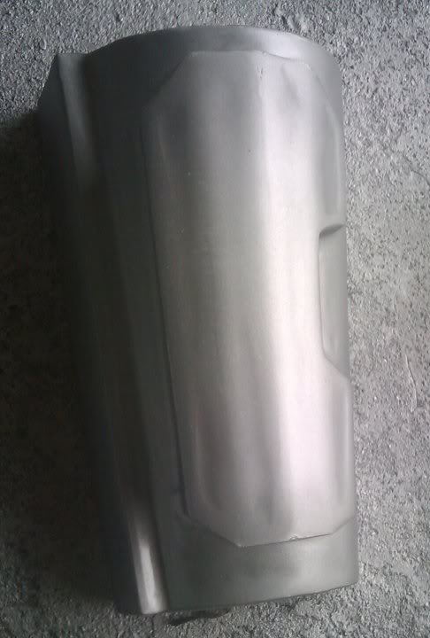

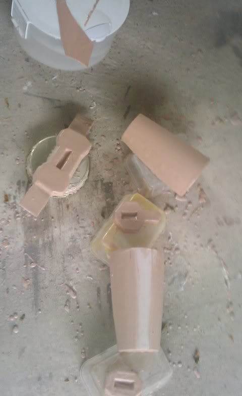

Here are some pics of the gaunts I'm making. STILL need some flamethrower housing parts for them guys!!!!????

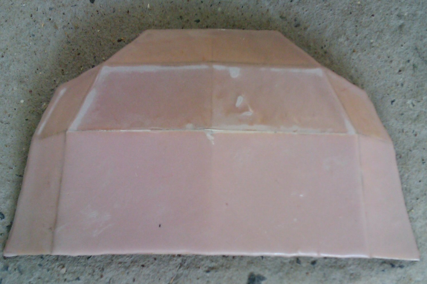

These need more sanding, hopefully my new sanding pads will arrive today so I can crack on?! some parts will need another layer of rondo too to finish smoothing them out. There's a pic of my lumber plate too.

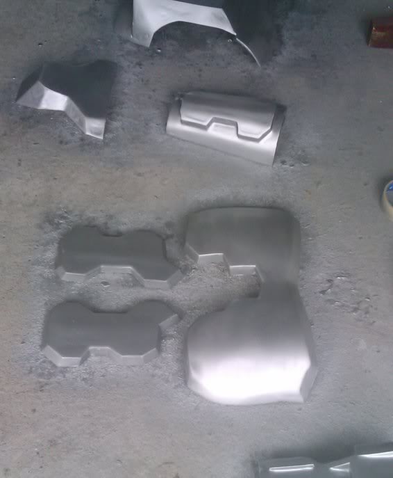

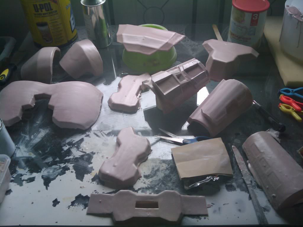

We're painting!!

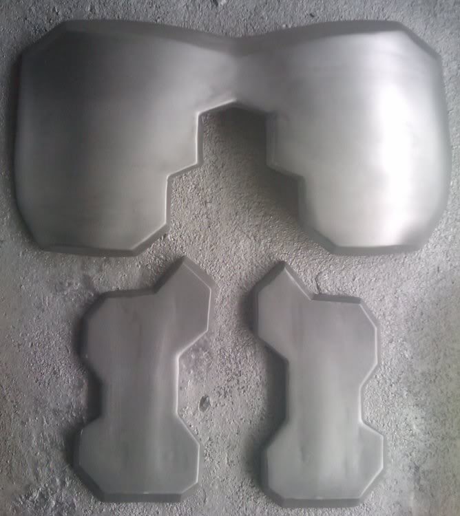

I managed to sand alot of the armor to a finish I wanted for it yesterday. My paint arrived this morning so we're good to go!
There are tons of surface imperfections particularly around the abs, back, cod and butt. I could have sanded them away but they'll add to the used, battleworn look I'm aiming for later! Same goes for the gaunts too! I could have spent more time to get them perfect but then they would have just looked too "shiny"!
Paint and further weathering should bring it all together. I HOPE! LOL! :D

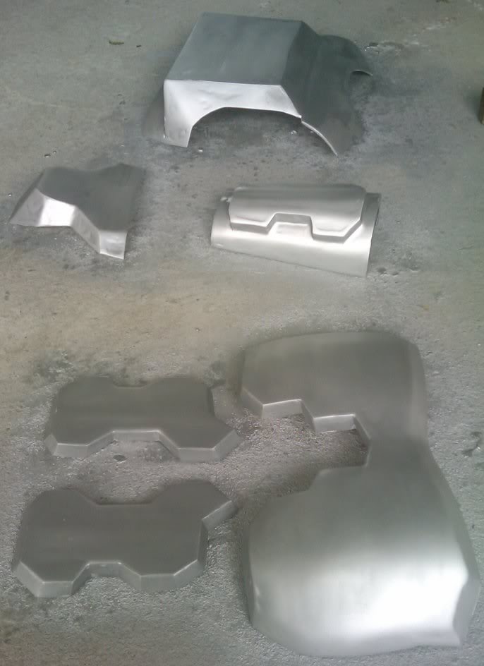

So far I'm just laying down the base silver, my color scheme will follow soon enough. Also, I managed to solve me flame housing problem thanks to a few people, and I should have some tasty knees soon too!
It's all coming together nicely now! Good thing really 'cause the wife wants to throw a Halloween party this year!! I wonder what I'll wear?
Onto the pics!
Last pic just show some parts that aren't quite ready yet. The shoulders need a bit more work too.
