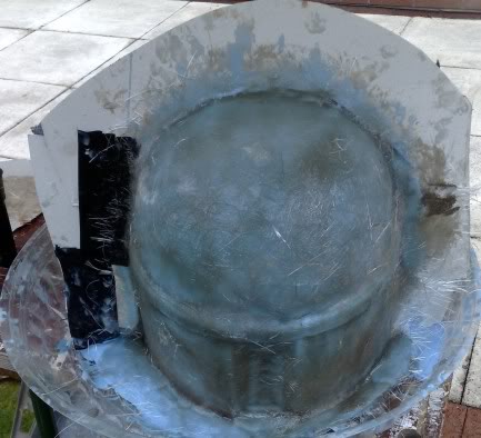

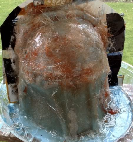

Well, the jacket is finally done, the British weather held off for me, though I put up an umbrella just in case.
So I started using this kit my dad gave me and was merrily wetting the fiberglass matting when I started to notice that my brush was getting stiffer and the stuff was coming out like jelly. One mad scramble later and I realised I was not going to finish up with this.
So I had to get some more matting and some of my casting resin and finish off... let's see if you can guess where the free stuff stops and my stuff starts... :)
Anyhoo, I realised I had to be quick with this stuff and stopped wetting the stuff on a piece of card, but wetting it in on top of the model, still had to pour another pot though when the first started to gel up. Used bigger pieces of fiberglass mat for the dome area to speed up the process.
I've found some bolts, but the resin hasn't cured on the rear enough to put the drill through. Once that has done I will be trimming the mold and bolting the bad boy up! :)

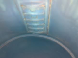

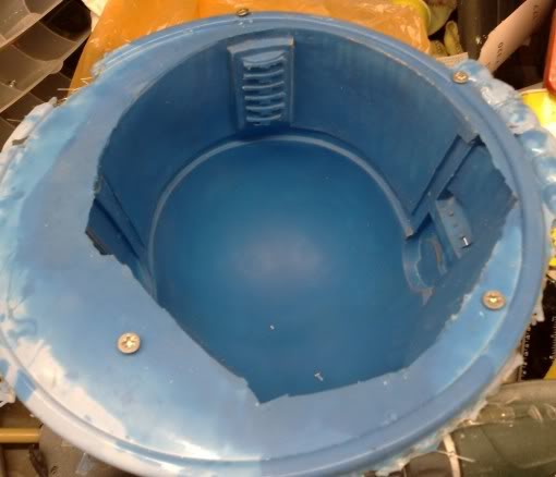

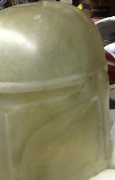

Yup, loads of progress now, I have pulled the shells away from the RTV and pulled the master out of the mold, as expected, some of the cardboard parts of the master didn't survive very well and I will have to fix it if I ever need to make a master mold again. That's not for today, so I've cleaned up the RTV but it is a little on the thin side, I will certainly be needing that thickening agent.
I also made a few mistakes with the fiberglass jacket, as the rubber is thin, it tends to fold away from the fiberglass shell when I am trying to fit it into it, so, next time, not only will I put bolts to keep the two halves together, I will place screws in at the base to ensure the mold is placed correctly.
I had to spend a good 20 minutes getting it right so I could place the screws in.

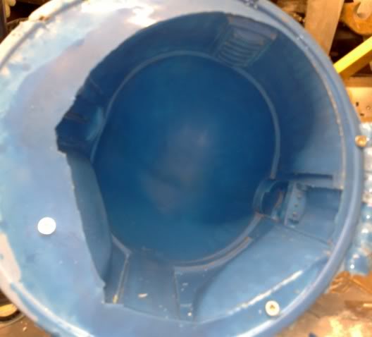

But enough of me, here's the master mold
I will have to make a copy from this mold and work on it I am afraid, as I found a bubble one of the key slots. I may try fill this in with PVA glue though, I haven't decided yet, but I want to make sure that the final cast will be perfect, so I need to have a master that won't fall apart on me.
I will be really careful when I give the process a go tomorrow to ensure that I get a perfect cast!
Edit:
I ended up using a latex based glue to fill in the two air bubbles, though it isn't the best solution, it will be good enough for the one cast.
I will also do my cold cast experiments with this mold too.

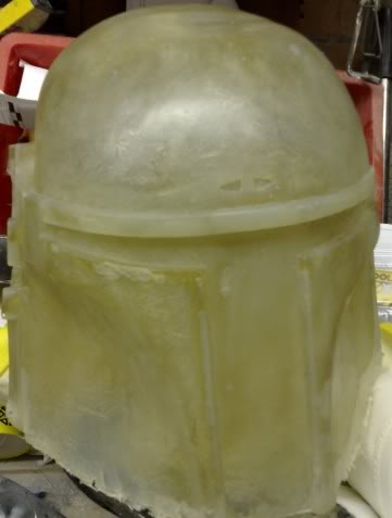

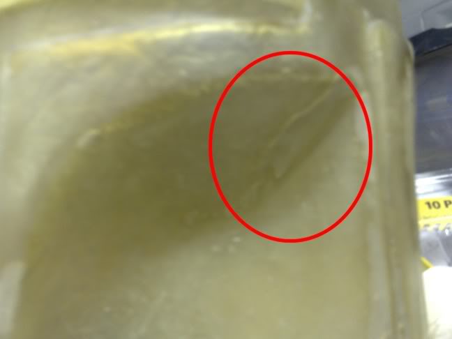

Hi guys,
Well, the first attempt was made, but it wasn't as successful as I'd liked. I don't think I fitted the rubber mold into the jacket correctly and the dome near the ear pieces warped.
I was also late for wrestling and I began to rush the job, the result? Airholes!
I didn't have any pigment to put in the gelcoat, but here are the shots, the red circle is a massive hole on the cheek plate, I think I did this trying to get a hair out.
If I have time I will make a second attempt tomorrow, but this time I will ensure that the mold is fitted correctly and I take my time with the process.

I'm having issues, the second one came out with a bump as well, so I'm going to have to go back to the drawing board with this and see if I can come up with a solution.
Problem is that the mold seems to sag into recesses in the jacket it appears.
Grr.

As for mine, I've realised that "somehow" the RTV has stretched and there is a sag, which explains the wobbly head part. I think I will repair the original and start again :(
