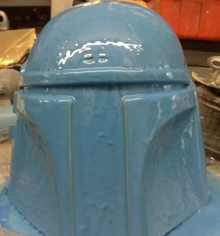

First coat:

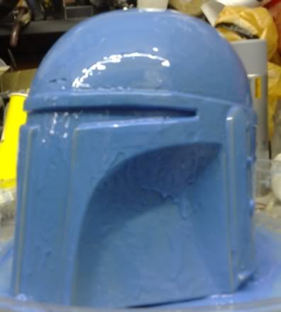

Second coat:

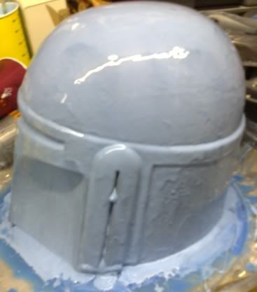

Third coat:

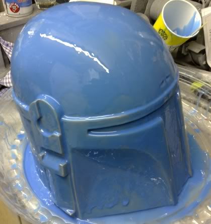

Gah!
Still got the lines where things are weak at the corners!
I do have some other RTV but it's a different type to the other stuff I used! Not sure whether mixing the two will cause any problems, but I don't think I have a choice, will really need to allow the mixture to thicken as well.

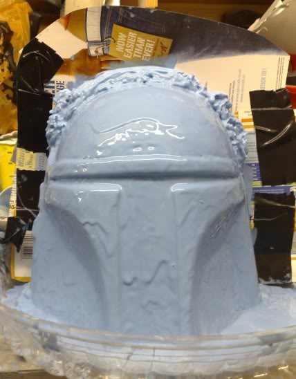

Right, well believe it or not but the cheaper stuff is like glue!
It's gone on much thicker and I hope that the two different types of silicone will mix ok.
If they do then I'll probably use the expensive stuff for the first detail layer and the cheap stuff as the thick part!
1 more coat I think and then it will be time to build a key.

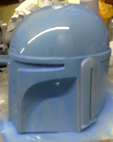

Anyhoo, here it is:

The RTV is still a little tacky in places this morning, so I may have to leave the jacket till tomorrow, if it dries ok later, I'll pop some mold release spray on it to prepare for the process.
Good news is that I got to it whilst it was thickening and filled in the gaps between the cardboard using a coffee stirrer and some of the off dribble, I even managed to fill the earpiece in too!
