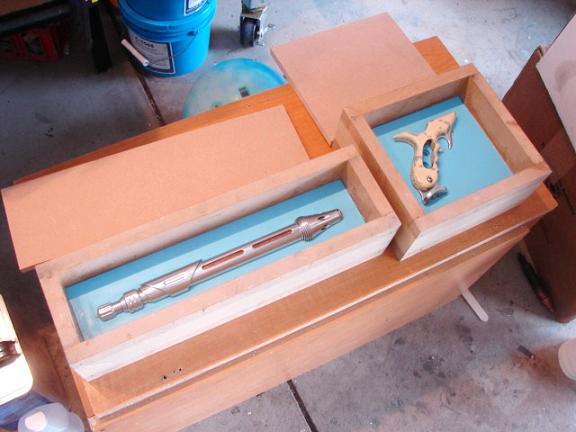

Well there was a small delay (completely my fault) in getting the catalyst for the silicone I received last week, but it finally arrived today. So I quickly got to work and poured the first sides of the molds. Tomorrow morning I'll do the second sides, and by Saturday I should be ready to make my first test copy. Looks like I'm going to need some guidance from the Sci-Fire guys, so I may travel to the shop this weekend in search of expert advice!:thumbsup:
Just out of curiosity, I cant see it too well from the pics, but the "heat dispensers" that are along side the barrel where you can visibly see the inner brass tube, did you fill that up before adding the silicone? I think that would have produced a nasty undercut for the mold
I actually filled that cavity with a piece of brass pipe that fit very tightly so there would be no undercut what-so-ever. I accidently pulled the barrel out of the mold and the one half looked very very good. All of the detail was captured perfectly!

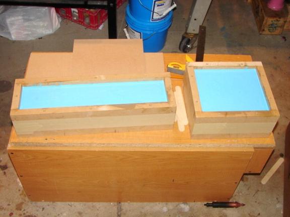

The second side is poured. I may have screwed up the barrel mold by allowing some of the silicone to seep under the barrel, so in 4 hours I will demold it and see if I indeed did. If so, I'll begin making a new one today, so no big deal.
Also, I found out the paint finish used on the handles is pretty much the equivalent of spray paint. The Sculpty clay I had used (last minute) to clay up the handle pretty much ate up the paint finish. It only does that to spray paint like paints...so MR really fell short when it came to the finish on the handles. A coat of paint and it's no longer a problem.:thumbsup:
