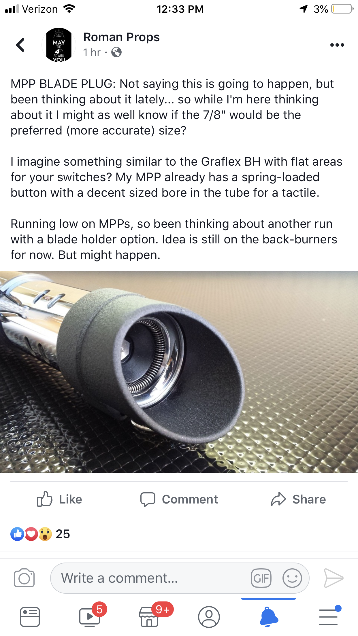

So Roman just posted up on his page. Idk if he’d be interested in doing it but now is the perfect time to voice interest to him about producing a MPP tube with all the correct sizes if people are wanting them. I know I do, especially where im not to keen on the idea of drilling those added holes in a vintage MPP if I ever get ahold of one. His tubes really are near perfect outside of that one incorrect hole size so if we can get him to do a run of 100% correct tubes thatd be amazing
I've sent him a few messages on replicating his flash tubes to be more accurate and to create a run just for Boba Fett...maybe he'll come around!
