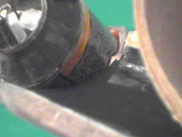

1 Before I sealed the mainbody I glued and taped the exhaust vent to it. I added two screws from the maintube through the backplate to secure it and give the whole construction more stability.

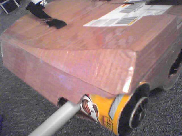

2+3 I refined the shape of the backplate by cutting the sides to get the same angle as the sideparts above and sealed them after adding some further restrengthing between the backplate and the outer backplate curved hull.
4+5 As I never would have finished before the DVD event, I fastly constructed a TEMPORARY rocketsection with two bottlenecks, the tubecap and some constructionpaper and cardboard. Which I testfitted on the now sealed body.
