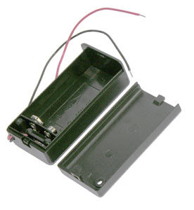

You are probably better off getting a battery holder with a switch. All you have to do is connect the black and red wires together and you're golden. The yellow wire is for RPM readings when it was hooked up to your laptop.
