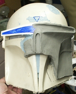

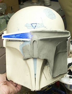

Here are some very early pics.I used a cast of a Dp deluxe as an armature and slopped some bondo in the basic shape needed.I cut out a visor/nose template from abs and found all my centers.Now I am roughing in the clay.
The face will be shorter than the regular fett but I will have to build the dome up a bit which will compensate for the face being shorter.
The pics are at an upward angle so the visor looks like it has a bend in it in the middle it doesnt it goes straight across like the figures does.
It starting to look like something.
I will soon cut out the lower mandible section and use flat stock sintra.Ill mock up the 3 aerators but will most likely have to cast them seperately.Ill post more pics soon.

It's hard to tell in the pics, but it looks like the mandibles on the original helmet are kind of "smooshed" together at the bottom. Would that make it too small to wear? Or do you plan to only make it as a display piece?
Cool! I'll be paying attention to this project as it goes along.
Yeah i cut a slit in each corner of the eye slot and squeezed the mandibles together and bondoed them.
It should be wearable because the clay sculpt will go back out to the area where the mandibles would generally be.The reason i did this was because if I sculpted over them in the original postiton the helmet would have been to huge and out of proportion.
