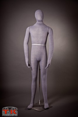

That looks pretty cool! Looks really wobbly (But that was before the guy had it on the stand). Also, this mannequin assumes you'll possibly have some space in which to attach the stand under a shirt. Being that Boba is a full flight suit, I'm willing to bet not too many folks would wanna cut a hole into their flight suit to have it mounted on the stand. And going up through the pant leg may look a bit awkward.

I don't think you want that manny with the pole that inserts into the spine. It's good enough for an abs TK, but not stable enough and not practical for Fett. The pole insertion point is right where the belts are. Also the head is very spongy and doesn't do well under the weight of Fett's helmet.

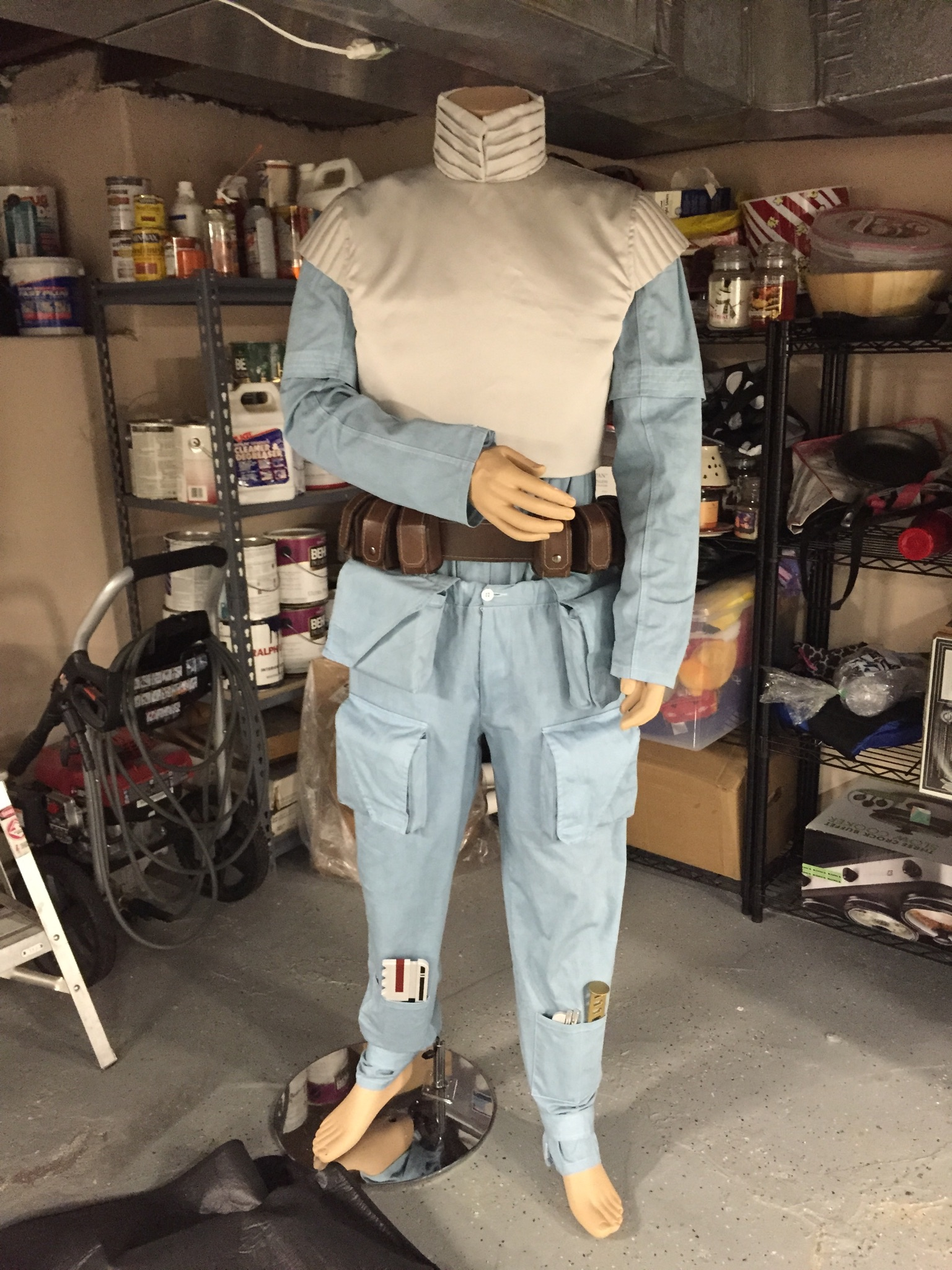

I have a couple of mannequins with articulation at the shoulder, elbow and wrist but not at the bicep, so I used a couple of wood blocks and lag bolts to create some bicep rotation. Rotation at the bicep is critical for those more realistic Fett poses. Here's a couple of really short videos from my Instagram that gives a quick look:
This is a bit of an upgrade to a rather janky method I used on my last mannequin with screws and rubber plumber gaskets. It worked but was difficult to fine tune the adjustment. The new mannequin is for a life size ESB build I'm working on. The old method is on the ROTJ life size I did last year in the pic:
