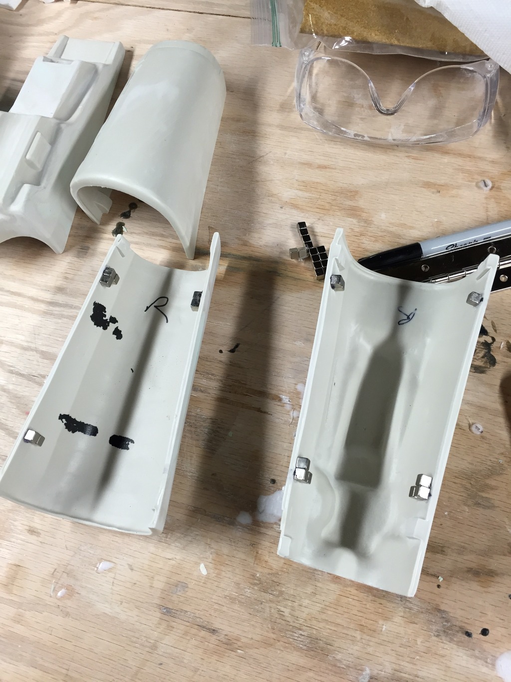

Is there a reason 4 " bar type magnets wouldn't work? I bought 1/4" N52 cubes and they really aren't holding if I flex my wrist. I only have 2 on each side but I can't imagine another would fix it

I think if I had a hinge on the one side they would work fine. These are rare earth ones and are N52 which was one of the highest in the range. I think fighting the shear seperation will be an issue. I am going to play around with them this weekend. I am going to add ABS or metal tabs to each one on opposing sides which will eliminate any side to side seperation ( I hope). Was considering trying that with Velcro as well.
I know the simple ( and seemingly most common) way is hinging them but I really prefer a smooth look if possible. The dual internal hinge would work and I bought 6 ft of it so that may be my ultimate path as well.
I was thinking an overlap tab on the inside as well for you but submitted my post before I thought of it. Just something the keep the shells lined up. That would most likely be the easiest and quickest fix to your dilemma.
I was just downstairs staring at them and think the tab will help. I am going to make a opposite side piece that the tab will slide under/into with a bit of tension on it to keep it in place. The people at Lowes must think I am up to something when I go in and just wonder the isles looking at random things for ideas lol.

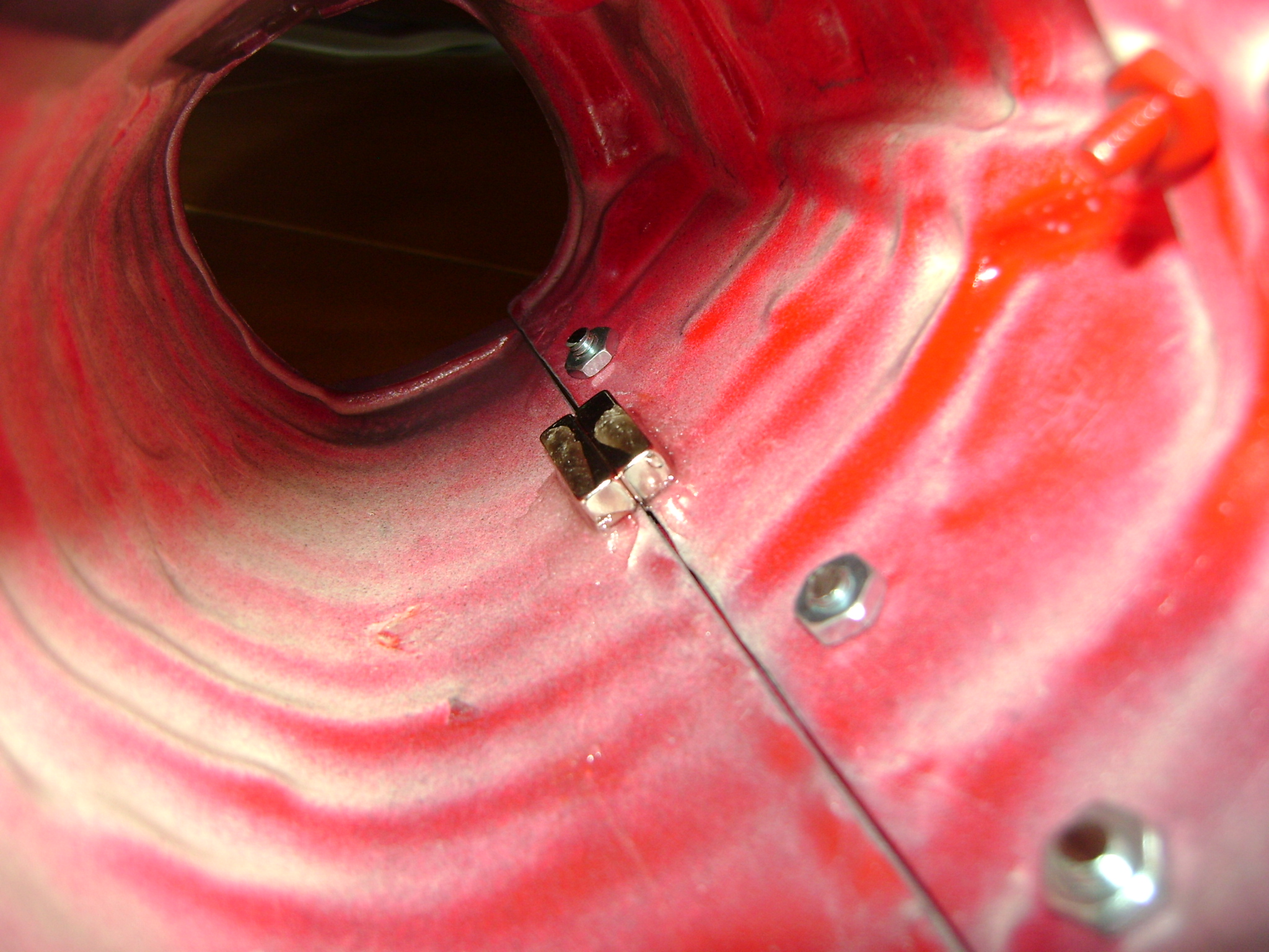

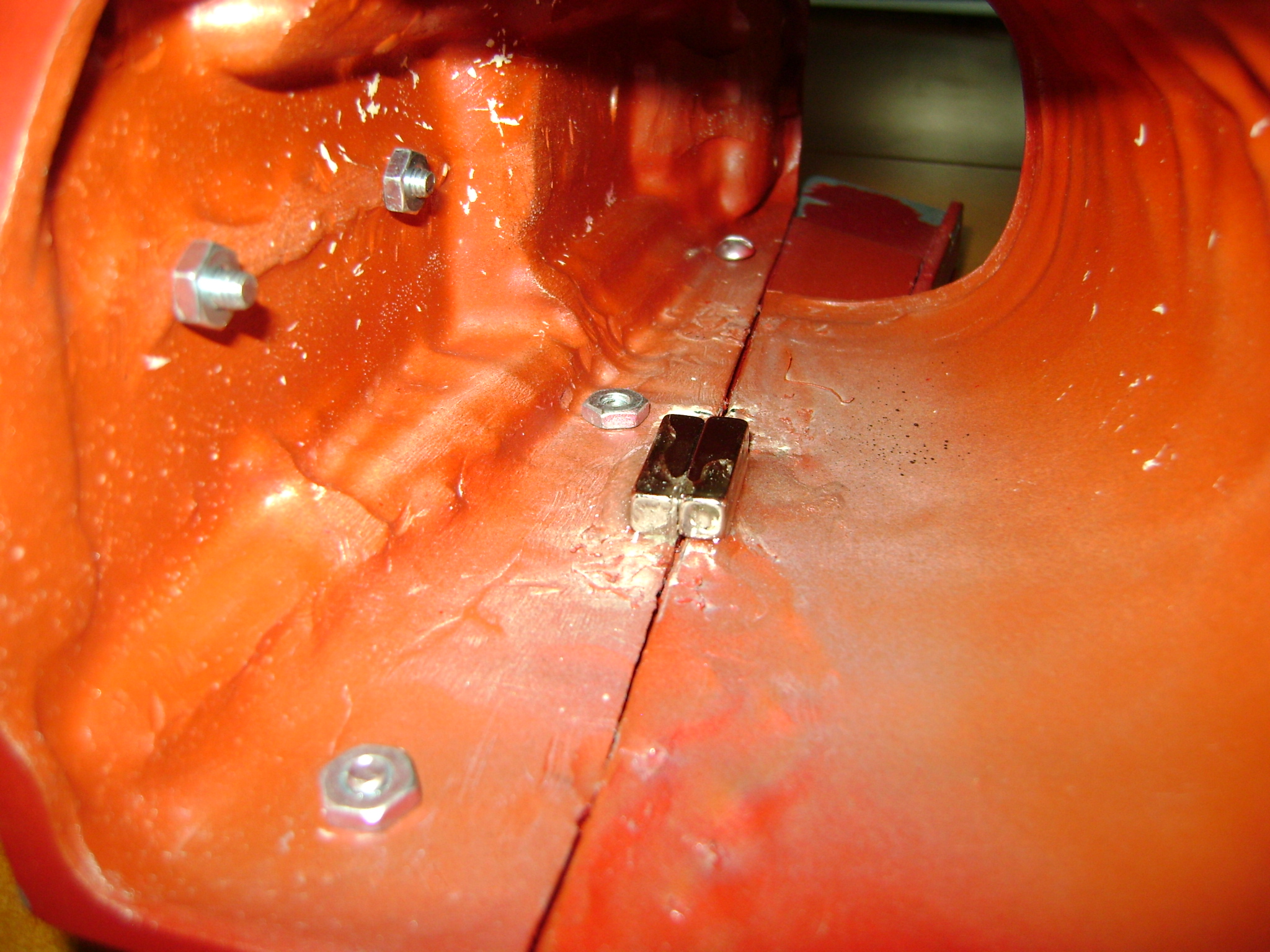

Check out RKDs tutorial on how to do the magnets. Its a different method but utilizes magnets and they do not open.

This will work for gauntlets with vac'ed bottoms, or full vaced shells. I used this method and they DO NOT open and i wear mine pretty snug. Full resin or fiberglass this wont work because you need to be able to flex the bottoms and/or top to open/close them.
I like my gaunts to open/close from the outside, so the inside side of my gaunts is glued since these are full vac'ed. I overlapped top ove the bottom, but you can do it so it sits flush using a "tab" glued on the inside.
