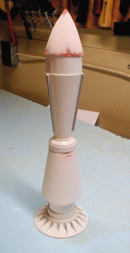

Just started my jet pack- as with the rest of my costume I'm trying to build it using only what I can scrounge in my garage or get for free. The majority of the jet pack will be constructed of foam and cardboard.
I just started the missile tonight- it's being constructed from styrene sheet. I've got to hustle if I'm going to finish by halloween. :lol:

That is just amazing work... I know that after seeing this piece, the rest of the jet pack will rival some of the best makers.
Wow! Looks GREAT! :)
Edit:
Oh I doubt that! The seam on the back side isn't so pretty but it should clean up OK. My requirements are make it cheap, fast, light and reasonably strong. Then comes accuracy!:lol:
I have the seam on the back of my rocket too, I used the CNC laser to cut my WOF pieces out, they formed fine, and bondo covered up the seam once it was smoothed out and painted. I'm sure the styrene was easier to form, it looks to be 1/16" thick.
I originally wanted to make mine from thin gauge sheet steel and use my laser welder to weld it together. It would have been exceptionally light and strong. Unfortunately there just isn't time- maybe after Halloween is over.:D

the rocket is the hardest part.

That missile is pimp dude.Got any progress pics?I am going to try and tackle one of these in metal as soon as I get some free time.
Those are the only pics I took- I was just in too much of a hurry to get it done! I had thought of laser welding one out of thin sheet metal at my work- it would have been awesome but it just would have taken too long to make.
