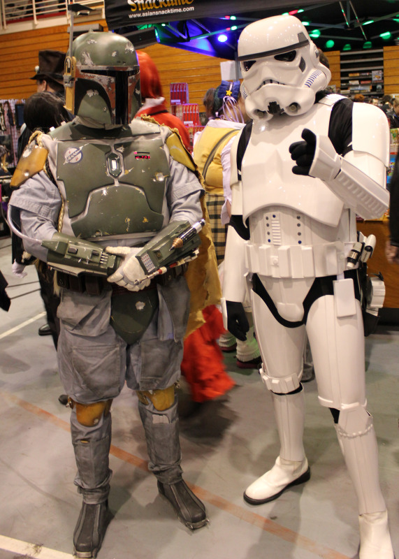

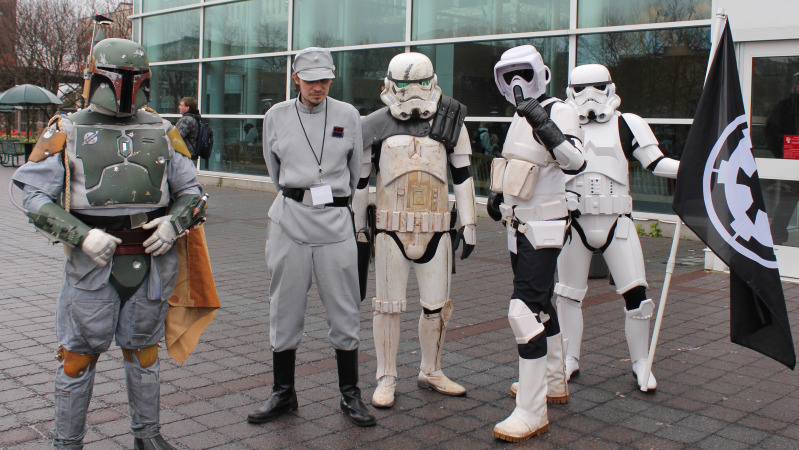

Rustoleum Satin Spruce green VERY LIGHTLY Misted randomly (not all over) with rustoleum hunt club green and krylon black primer. Then matte clear coated.Thats what i used on mine. Here are 2 pics from the same event, one indoors under incandescent lighting and one outside in cloudy weather:
I also discovered Krylon "Italian olive" Which is a tad more yellowish/greyer. I plan to use this to alternate the color on some parts when i update my JP and gauntlets to the newest MOW parts.

The helmet colors are actually the airbrush colors.
The shoulder bells i did both with krylon signal yellow. Then i misted the right shoulder (and knee) with testors go mango. Kind went back and foruth misting the signal yellow and go mango till i was ahppy with the shade. Then i misted both shoulders and knees with the krylon black primer to tone down the signal yellow and give it an overall weathered look
the reason i use the black primer to weather rather than "flat black" is becuase its more a greyish tone which looks more natural soot/dirtlike than flat black
Oh yea i forgot to mention, the center diamond on the chest is hunt club green with a matte clear coat and a dusting of the black primer.
