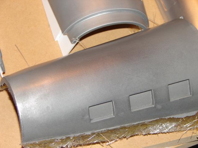

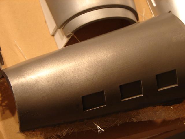

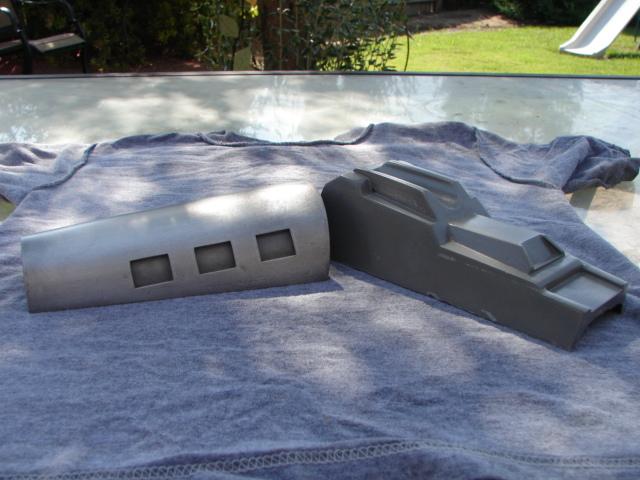

I received the cold cast materials yesterday and got right on doing a test run. They came out a little dark so it looks like I need to up the proportion of aluminum powder quite a bit more.
Pics are with flash and without.
Did you take some steel wool to them yet or are they just freshly pulled ?
I'm pretty sure you can "buff up" the pieces quite a bit with some steel wool.
Yes, and yes, but I only took the steel wool to the top parts of the piece because I didn't want to waste too much energy on them if the aluminum content wasn't high enough in the first place. This was at 66% proportion aluminum to resin. The next test run is at 90% and the first coat is already drying.
I can't wait to see the finished ones when you get the level of aluminum powder correct!
Yeah, I'm confident the second test run will provide much better results because of the higher aluminum content. Right away I noticed the wet mixture was lighter in color. However, I've already started to contemplate how I'm going to get that toned down/whitish finish that's seen on the original Jango gauntlets. I'm probably going to do a test run with some white casting resin and the same 90% aluminum ratio mixture, and see what I get.

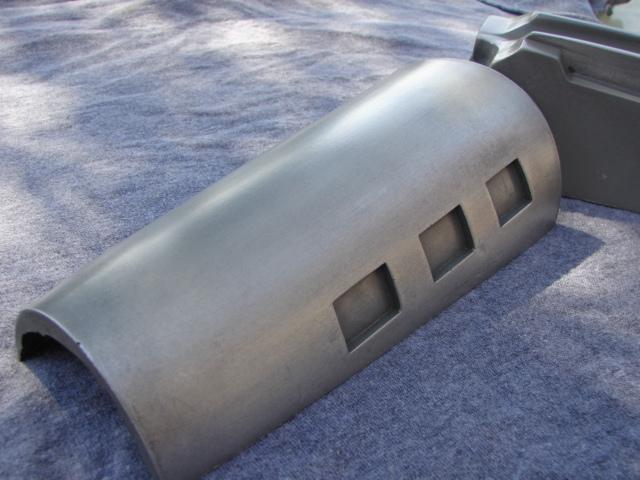

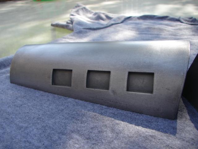

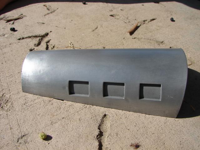

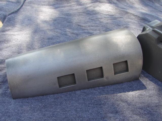

Here are some better pics taken this afternoon outside in the daylight. The first four are in muted sunlight and the last one in direct sunlight. The top shell hasn't been touched with steel wool.
