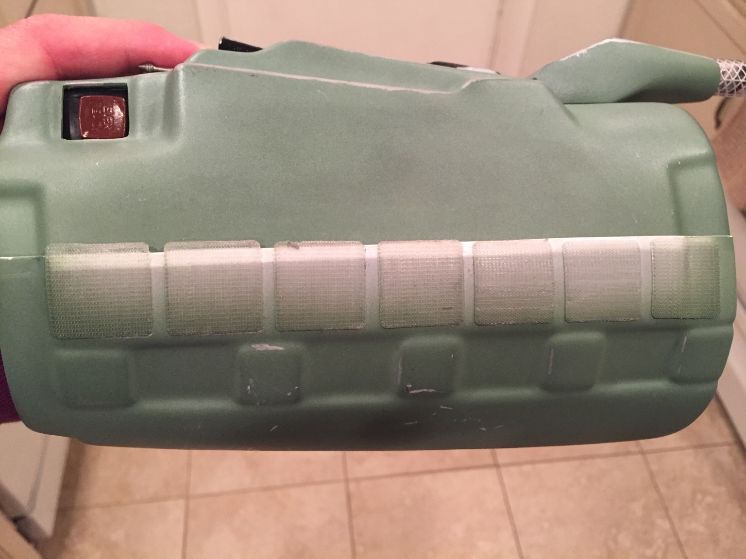

i use Velcro brand low profile squares on my FP gauntlets. very secure, in fact, i need help putting them on and taking them off. ZERO budging and no bulging.

I though of velco, but I find the Velcro attraction is higher than the glue attraction and I just pull off the Velcro. Should I use crazy glue on top of Velcro glue?

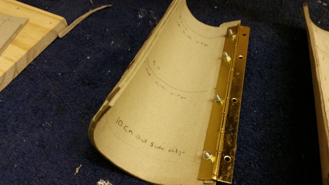

Use a hinge... chop the ends off so you can pull the pin out and separate the two half's, close the gauntlets, glue the hinge in let it set, pull the pin out to open....
something like this,
you will only need about 50mm of hinge there is no need to run the hinge the whole length
if you would like better description I can get some photos of how I did mine just drop me a message :thumbsup:
