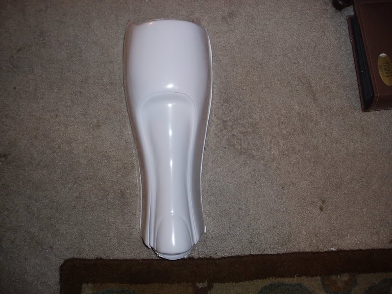

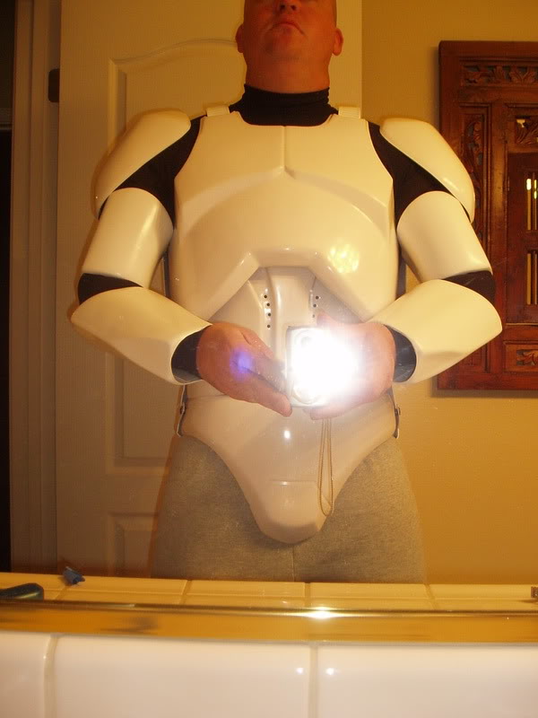

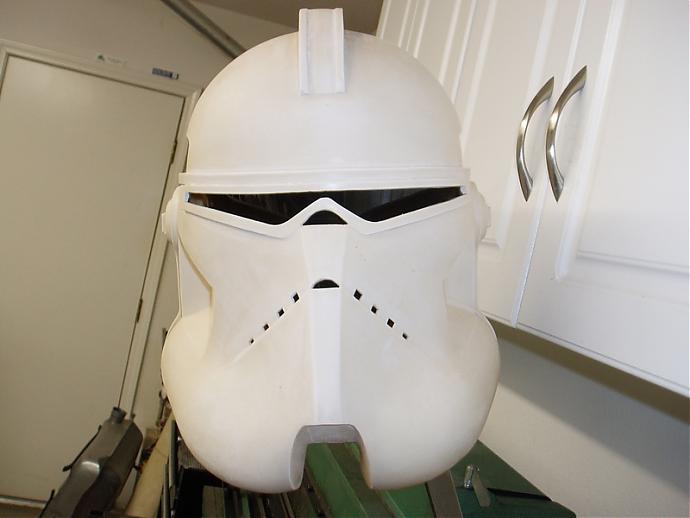

More pics. A little more work:

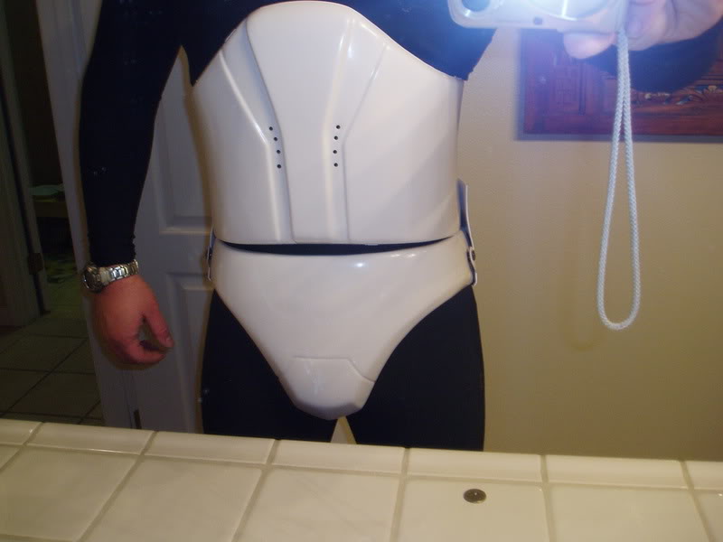

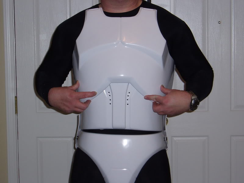

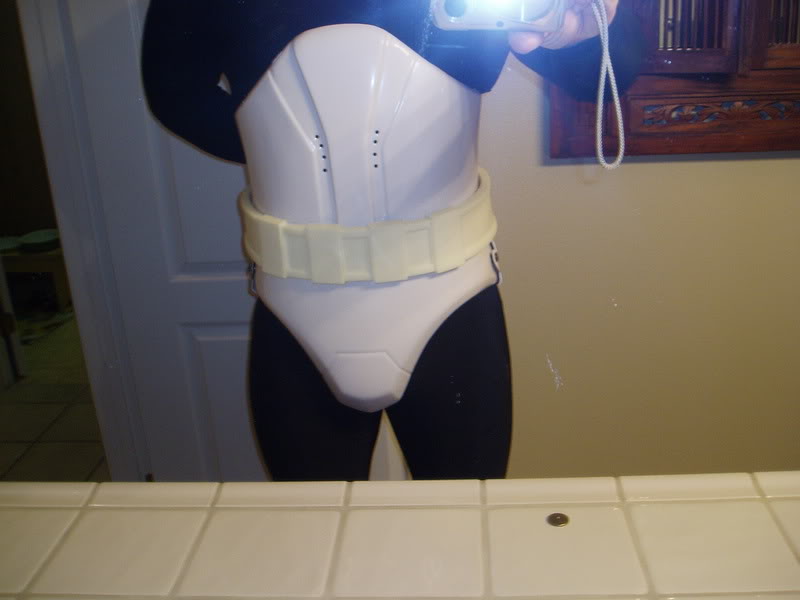

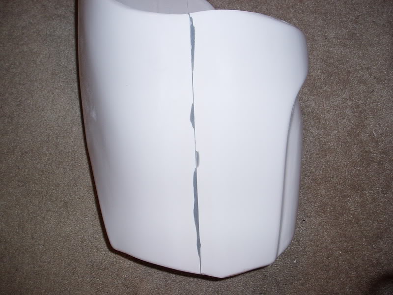

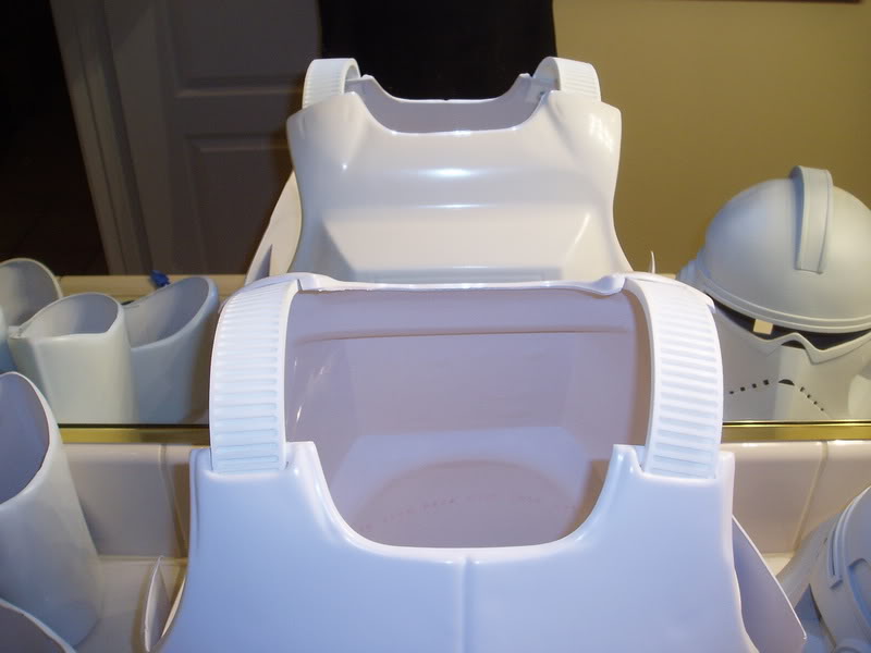

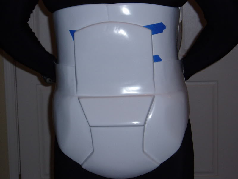

The armor looks great 5204. :thumbsup: I have a few questions.

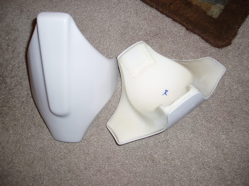

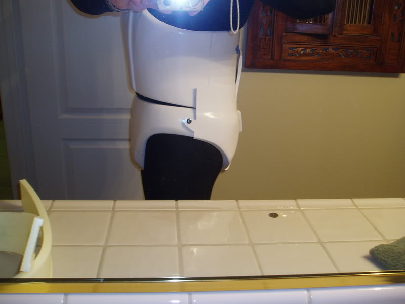

How did you connect the cod piece to the butt plate?
Looks like you also cut some of the butt armor away from the kidney area, and just left the middle piece sticking up. Why did you do it that way?
I did not know that OSCS was providing a seperate kidney piece to connect to the abb plate. Can you provide some pictures of how the abb and kidney plates connect?
Thanks bro. I'll be following your progress, so be sure to keep us posted.
Gator

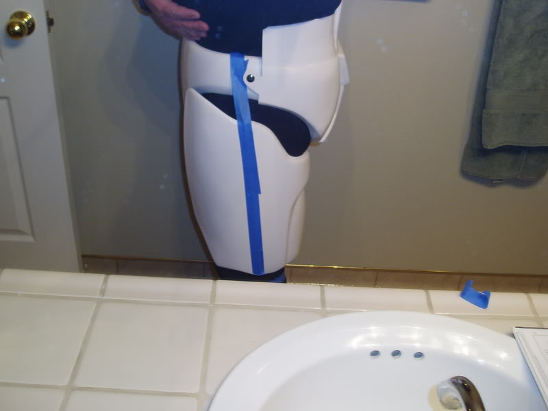

The butt plate is tall in the back. Kevin designed it that way, I'm following his directions. The small amount you see on the butt plate on the sides, above the waistline will support and be covered by the belt. I used snaps to attach the cod/butt. Per the directions, the ab/back piece are butt connect/ glued on the sides, then cut down the center of the back, to be mostly covered. Blue tape holding it together. Compare the last pics in post #23 and you'll se belt covers that side plastic. Just for support I guess. I'm working closely with Kevin as I go to make sure I dont mess it up. I confirm what I'm going to do before I cut.

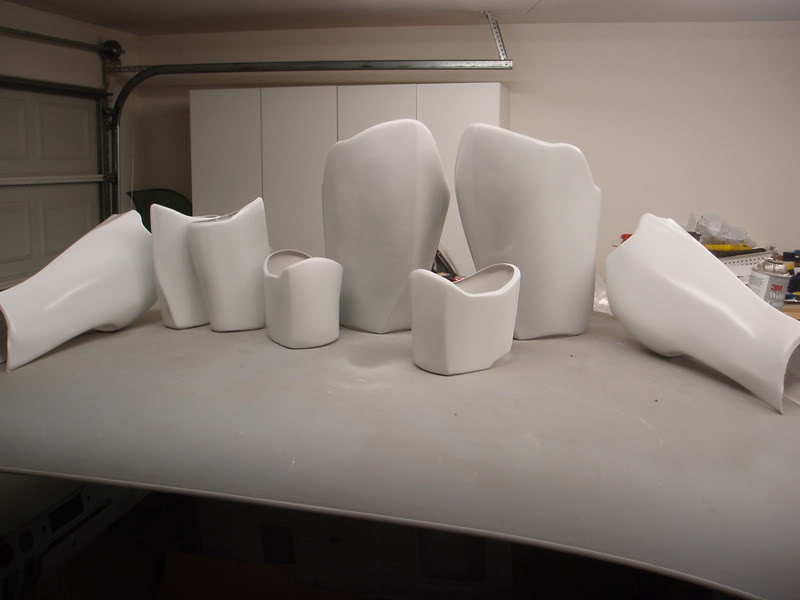

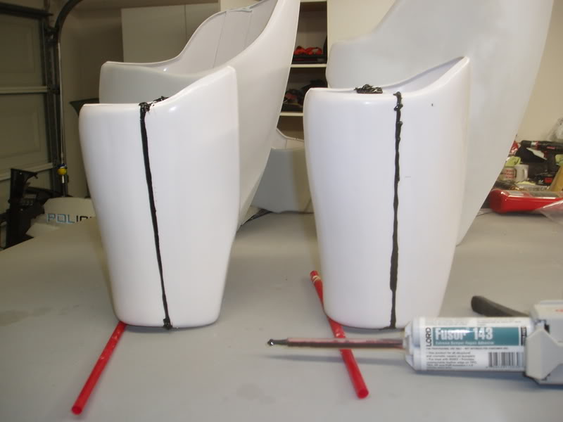

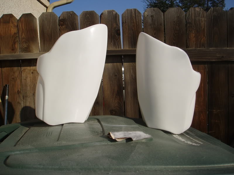

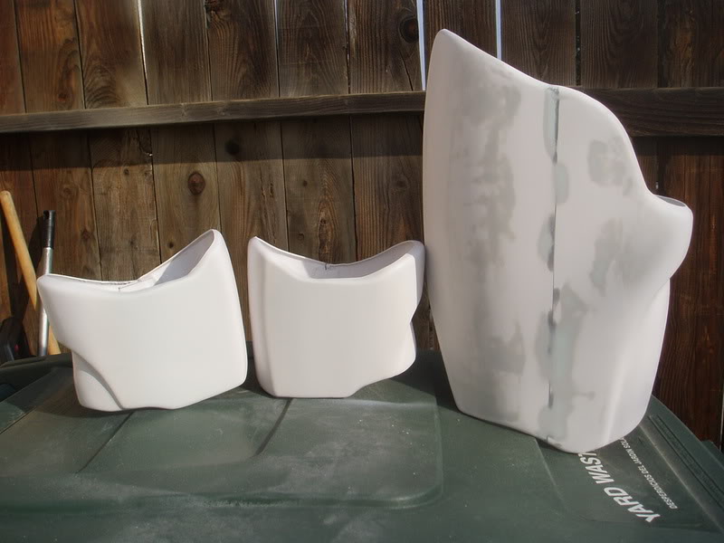

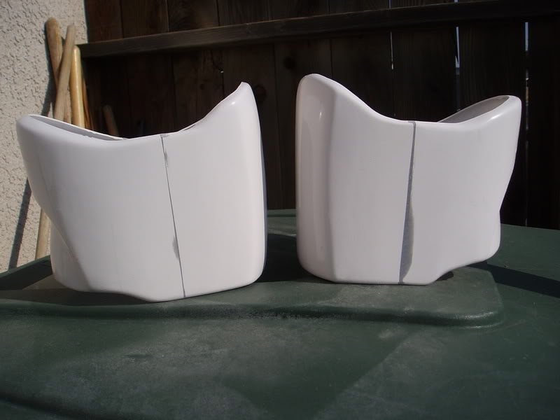

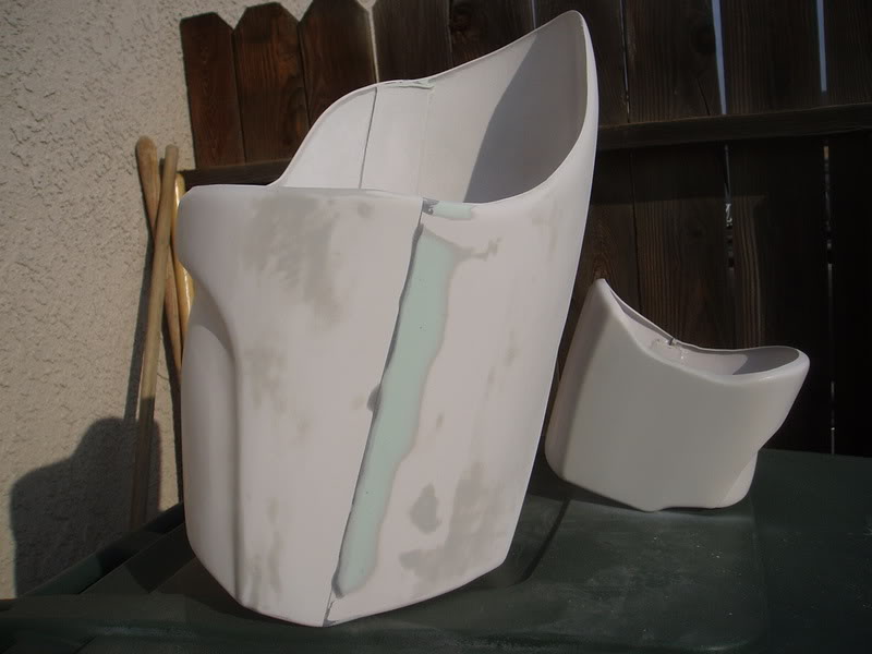

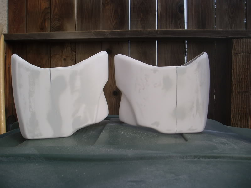

I had all day today to get some work done. Here ya go. I really tried to not use any body filler. I use a black, plastic bonding, bumper repair filler to cover the seams. Also used a good quality Dupont filler primer. Although you see the edges, I assure you, you can't see or feel them.

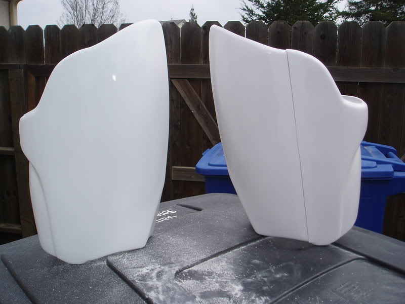

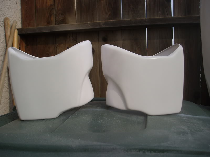

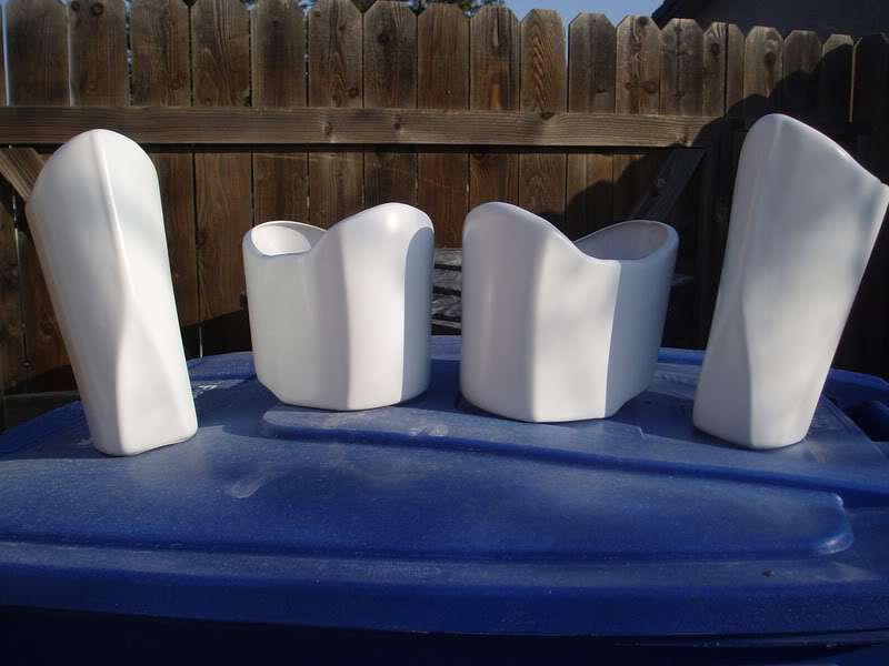

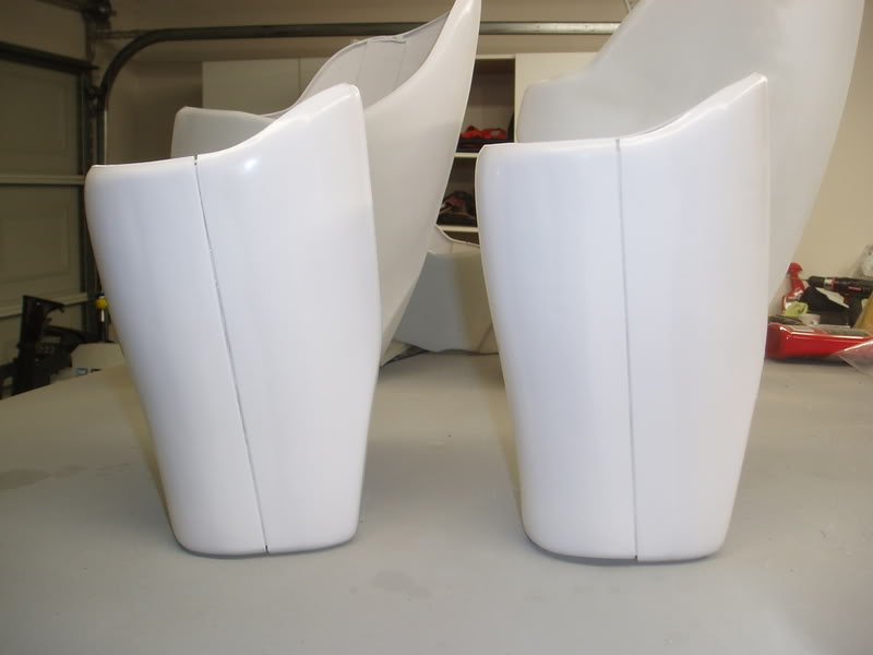

Done for today. I'll let this set overnight and sand on them tommorrow night.
I went with OSCS suggestion of Dupli-color for Truck SUV Pure/Linen white. Got it at Kragen. The spray tips are nicer, not like regular spray paint.
