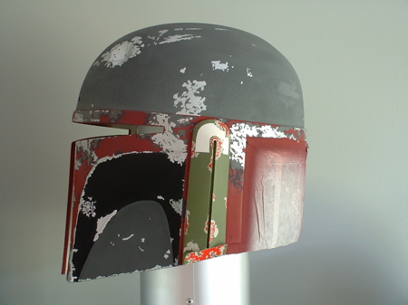

Just applied the black to the upper cheeks, i'll leave for 24 hrs and then mask for the green on the dome and lower cheeks.

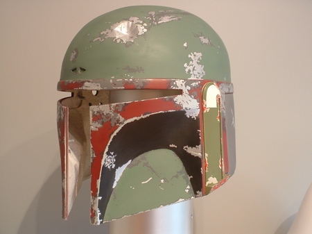

Spideyfett gave me a good tip some time ago, i will buff the final painted surface with 0000 wire wool, this takes the texture away in some areas and seems to polish the suface deepening tones, giving it a slight sheen also...
Just masked the silver and grey on the dome/lower cheeks. The whole helmet has been gently buffed with 0000 wire wool, gives the colours a nice sheen and reduces the raised edges between layers, also it exposes some real damage on certain edges. The red on the mandibles has really changed hew since i applied it, possibly the contrasting green and the buffing? The damage on the L/H lower mandible was done last after some of the green i use on the back was mixed with dark grey and applied...

Thanks for the comments...I'd probably give this helmet about an 85% so far, looks like i need to start another and refine the technique more... basically the idea behind the paint up was just for me to nail the process, only problem is you learn something new every one you do, oh well...:lol:
