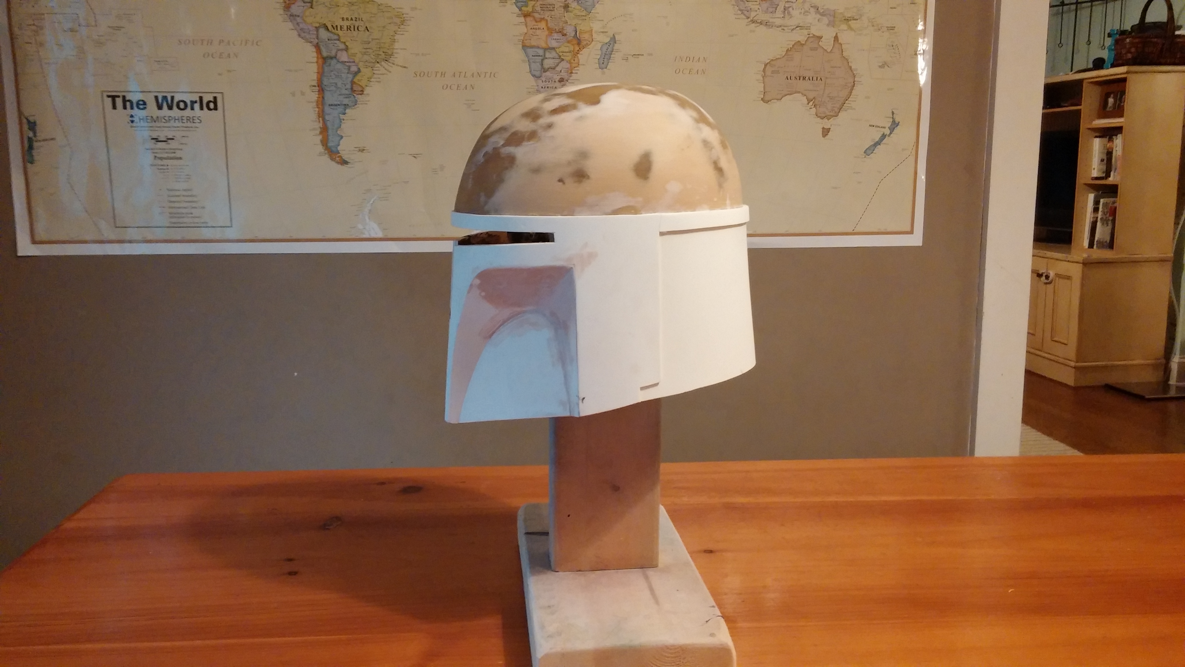

...and where I am currently.
I had to modify the key-slot configuration to match the Jango with a little more spacing....and the back-bottom portion of the outer-cheeks had to be widened a little. The dark stuff inside the helmet is Bondo Glass, which is thick resin premixed with fibers. I use it to give extra support to the stress points before I lay the inner fiberglass. I also JB-welded my T-nuts in beforehand so I could use the bondo glass to help reinforce them.

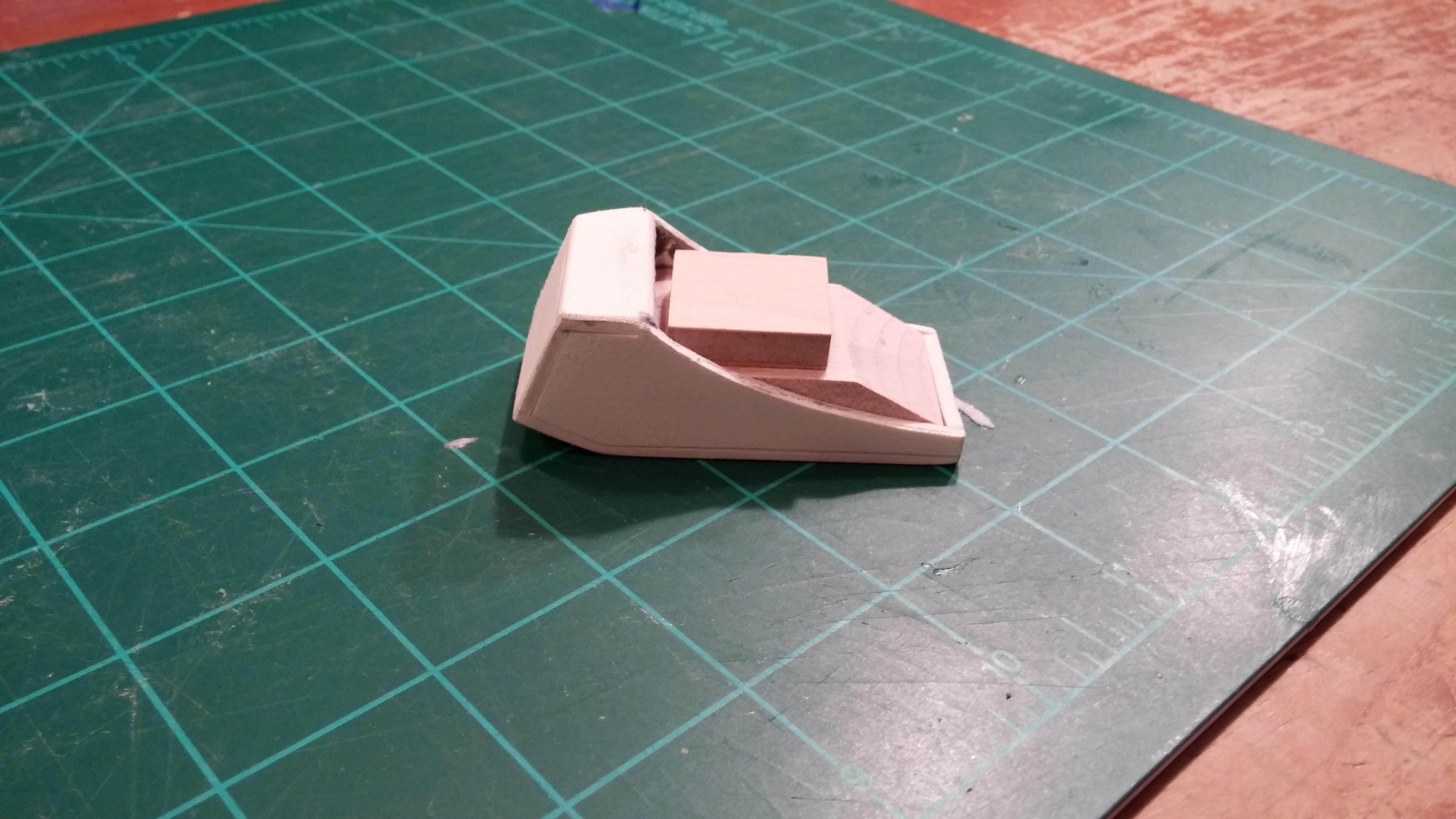

Here are my CNC'd ears. I use hard maple because it happens to be what I have available. The programs are from RafalFett's (rafalworks) 3d warehouse models. I sized them down and moved the top and bottom right ear into one piece, since the Jango helmet is nearly connected anyway.

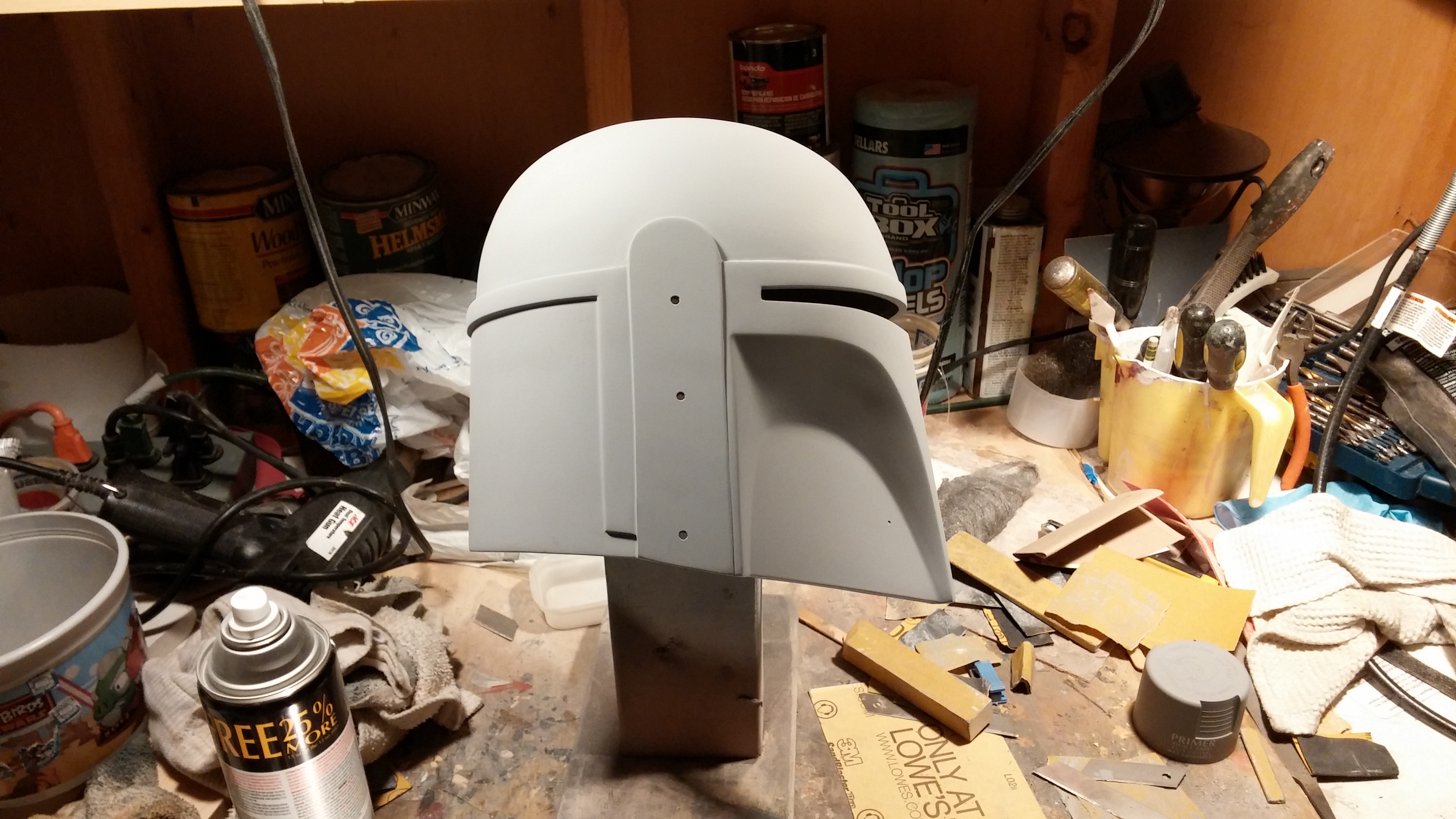

Rustoleum primer has been giving me a bad skin reaction from the overspray and fumes, so I tried to use some Valspar spray paint as primer...let me just say DO NOT USE THIS CRAP. It would not cure and I had to use Naptha to get it all off...plus a ton of sanding. It says on the can for wood/metal/plastic, but no. It just wouldn't cure.
Hear are some pictures I took before tearfully removing the paint.
Meanwhile I donned my hoodie, respirator and re-primed with good ole Rustoleum.
Finally after much wet-sanding I have some Rub-n-Buff on the back panels. I've never used this stuff...it was really fun to see it shine up!
Valspar is garbage from everything I've experienced. Unless you rub it down with wire wool prior to your next paint app. Otherwise it leaves a film that will only peel.

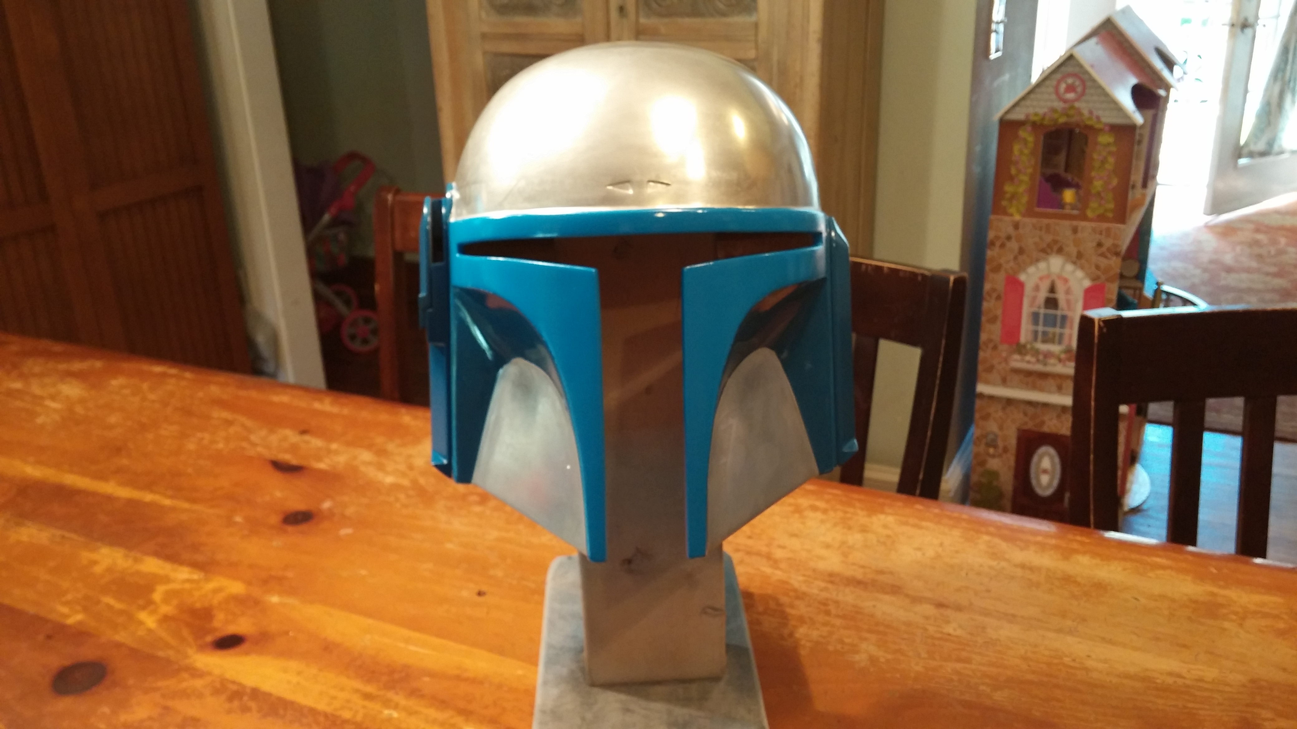

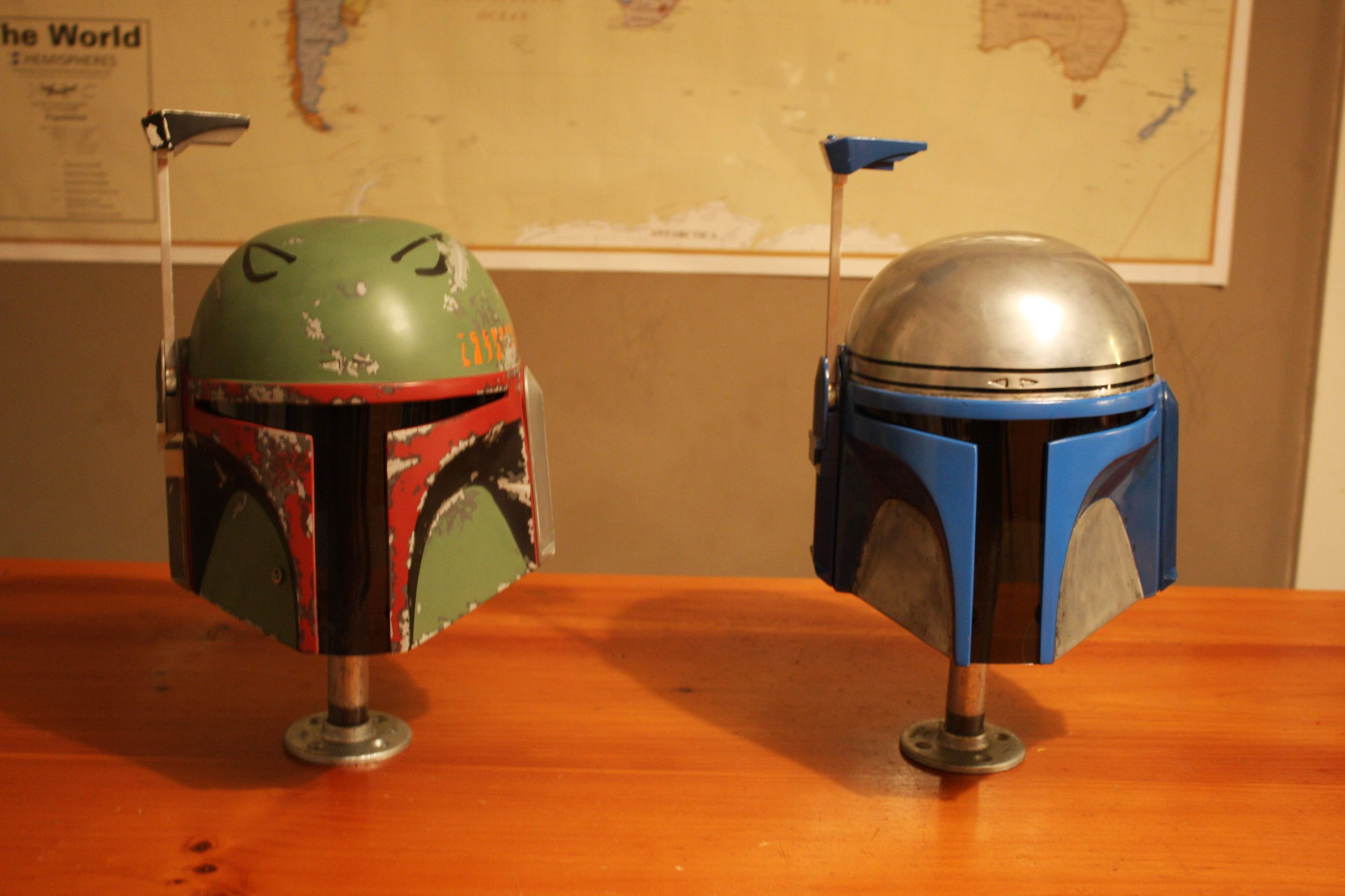

I sprayed Rustoleum Royal Blue and Krylon Ocean Blue for the dark and light blues plus some rub-n-buff. This is right after removing the masking so I haven't done any touch-up to the paint or rub-n-buff yet.
