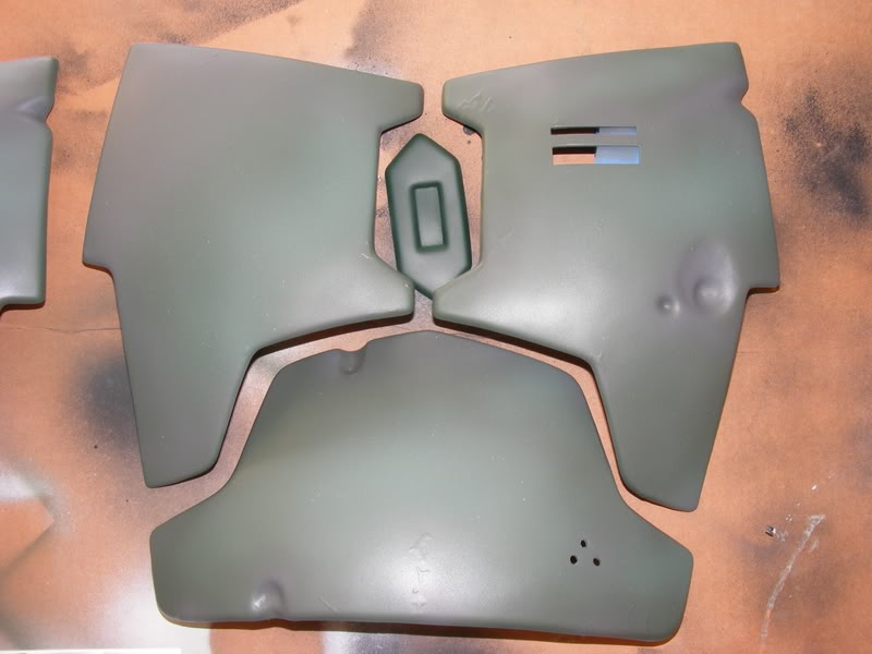

This afternoon I made a trip over to our friendly neighborhood SPIDEYFETTS house to get some HELP on weathering JB's armor.
I must admit that yours truly has never done ESB armor...only ROTJ...and since OLD SPIDEYFETT has done some excellent ESB I felt the need to get his help.:thumbsup::thumbsup::thumbsup:
So to make a long story short I simply handed over the armor to Alex and watched him do his magic. The pics you see below really does not ever come close to showing off the GLORY of the weathering that was done. In person it is INCREDIBLE. For those of you that will be coming down to Dallas for the JB presentation you will get to see what I mean.
Spidey...thanks man..today was a educational experience for me in the ART of ESB armor!!! :cheers:cheers:cheers

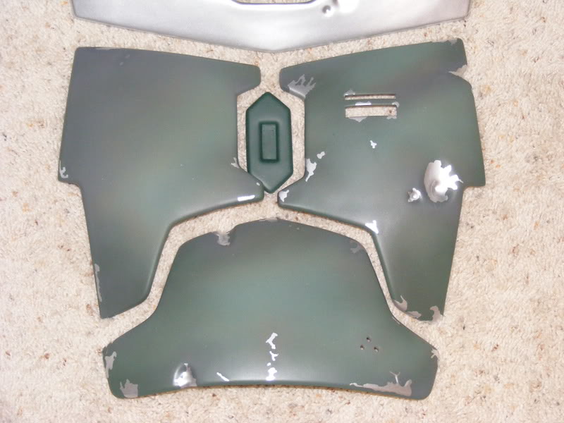

Tomorrow the Masking comes off and we will take a look at our SILVER!!!
then on to the Yellow!!!

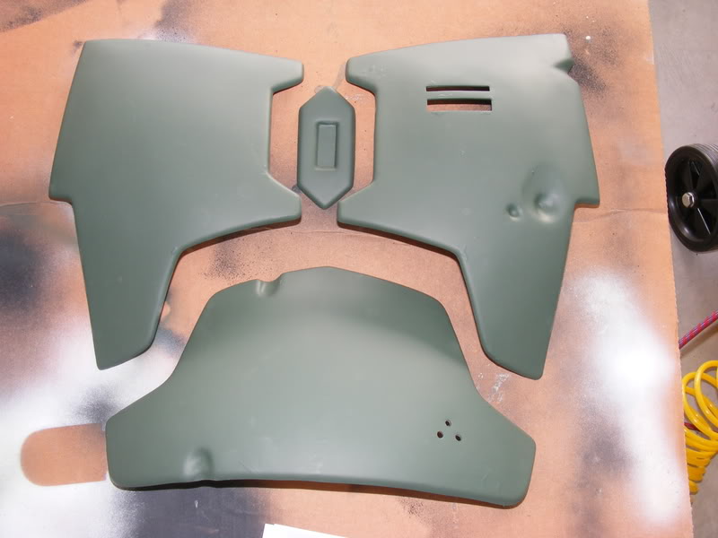

color update....
The base color was US medium green
then we used a super secret Spideyfett mix....Alex can you do the honors and post these
