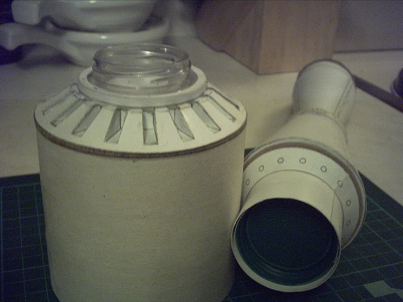

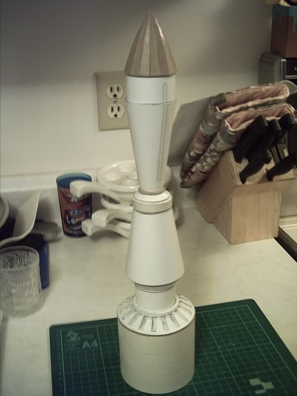

The wedge bits are made from folded cardboard, using the templates. Tedious to make, but not too bad if you make them when you've got nothing better to do. ;)

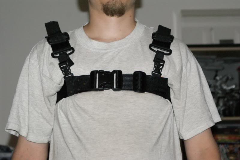

Another question... as far as what is actually attached to the Jetpack itself, how is it harnessed onto you? I'm nearly completed my Jetpack now too and I don't know about this part... did you just glue hooks onto the back of the pack or... ???
Thanks!

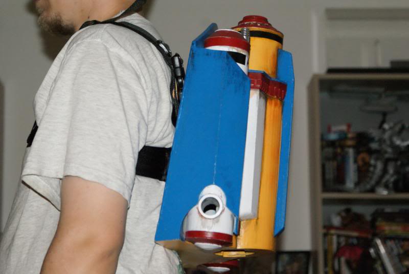

I rigged a wood dowel inside the jet pack, with nylon webbing straps routed through slots in the back plate and into/around the jet pack and dowel. Then it is securely attached to my home-made harness ala Fettdad and Bobamaker with parachute clips.
Here's some pics to better illustrate...
I could wear this rig all day long, and never notice that it's on my back! :jetpack
Thanks for the informative pics! Due to the use of PVC piping in my pack, mine is unfortunately not so hollow and I didn't think of using wooden dowling... :( Perhaps I'll try it on a pack in the future :)
