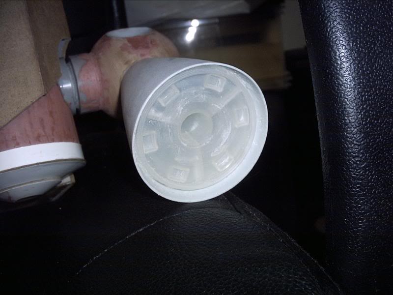

As for the inside of the thruster cones... those were the bottoms from the Glade Air Wick air fresheners that I used to make the thrusters. I simply cut them down so that they would fit just inside the bottom. ;)

The thrusters... were made form an air wick air freshner, a wooden ball, a ping pong ball and two thicknesses of ABS conduit to attach the thrusters to the pack.

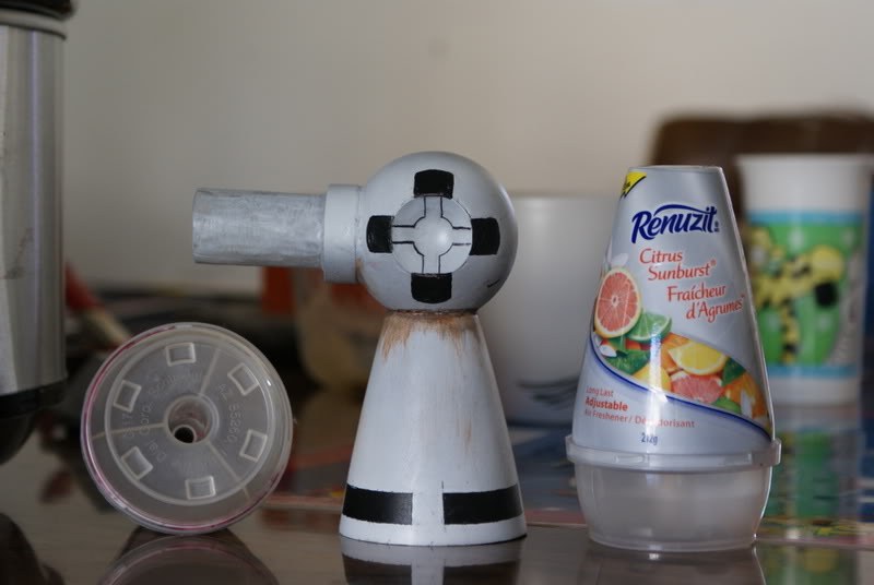

Hey, Question for you. Those thrusters look terrific made out of air fresheners! What kind are they? do you have a staged view of making the thrusters? I'm curious to see how that all went together! I've only yet completed the rocket, but have not started the pack body yet. Looks amazing!
The thrusters are made from Glade or Air Wick air fresheners. The kind that you pull the top up a bit at a time.
I've got two more at home that I haven't done any thing to yet. I can take a picture of them next to my finished thrusters if you'd like. ;)

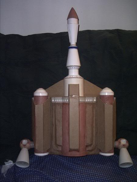

At long last, I can call this one finished... save for the painting. ;) :thumbsup:
I've slaved long and hard on this pack, and I'm darn proud of it too!
Here's the long awaited pictures...

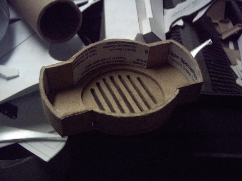

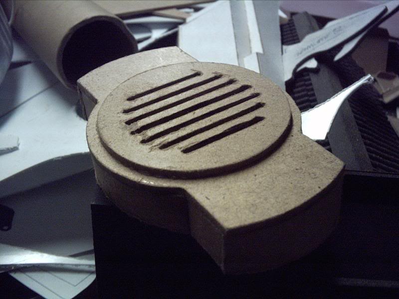

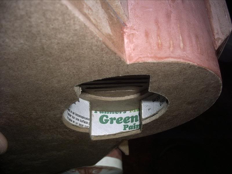

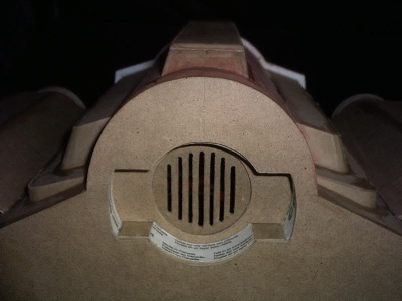

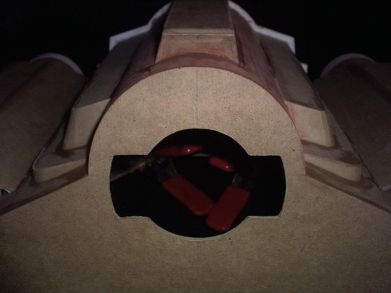

Bottom vent finished and ready for install
The hole where the vent will go naturally...
...and this is the vent installed

And last but not least, the finished and ready for paint jet pack...
I'm with holding pictures of my harness set up as I haven't completed it yet. ;)

As for the thrusters, they were made using a wooden ball ( found at a Micheals craft store ), a ping pong ball ( for the small dished portion ), two diameters of gray electrical conduit ( to attach the thrusters to the jet pack ) and the Renuzit air freshener pictured below.
Just use the WoF templates as a guide on where to cut off the bottom of the cone ( so it's the correct length ), then sand off the swirl design to make the cone nice and smooth. I then trimmed off the bottom of the air freshener ( the clear part seen in the photo ) so that it would fit just inside the cone and glued it in place.
As awesome as the idea is, I can't take the credit. I don't recall off the top of my head who initiated the air freshener idea, but it is an excellent one. :D
