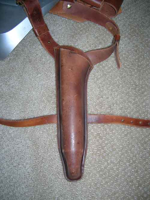

hey guys, for those of you that have made your own leather jango gunbelts, on the thigh straps off the bottom of the holsters, how did you attach them? mine are glued, and they're on there pretty solid, but I notice when walking with them that they're slowly starting to pull away from the back of the holster. I don't want to rivet them and have the nubbin of a rivet either inside the holster to scratch up my blasters, or on the backside to tear up my armor. heres pics of my rig that I made. I'd appreciate suggestions on a different way to engineer this? thanks.

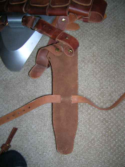

One solution is to STITCH the strap to the back of the holster BEFORE you stitch the front & back halves of the holsters together. If only you had asked sooner...sorry bud.
Could you cover a rivit inside the holster with soft cloth? Maybe attach the cloth to the rivit...

yeah, I wish I'd thought to stitch before. and I don't wanna undo the existing stitching to try it. thanks for the compliment though :) . so far I've tried goop, epoxy, ca glue, and this wierd leather glue, all with 4-5 days cure time, and when I cinch it down on my thigh and walk it starts to pull away a little bit, and I figure with enough time it'll pop loose. NOT what I want to have happen at an event, know what I mean? :lol: as for a pop rivet, theres just not enough room for the nubbin inside the holster without scratching my blasters all to hell. I carved wood moulds of my guns measurements to stretch the leather over to make the holsters, so they fit nice and snug with no room for anything else. I'm fresh outta ideas at this point. :( anywhoo, I hope someone else comes up with somethin I havent tried. :D
Use leather cement to glue the strap in position, drill a couple of small holes for stitching & use a curved needle to pass the thread through the holes. Use a waxed thread & with a little perserverance you should be able to get the reinforcing stitches in place.
OR
Dremmel two slits in the back of the holster & pass the strap through these. This method has the benefit that you can move the strap forward to do it up while in full costume. It is the method that I use but I use a punch to make the slits before I assemble the holster.
Here are pics of what I am talking about. The benefit of doing it this way is you can slide the strap around so you can adjust it & then move it back into position.
