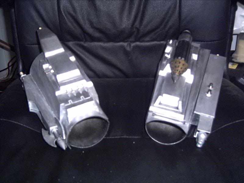

I'm awaiting arrival of the Jango at the moment. While waiting I'm looking for some parts I wish to add.
One of the things I need is the blades that are supposed to be on the right gauntlets grappeling dart.
Anyone have any blueprints or measurements for these blades?
I found this image in another post, and the gauntlet on the left side has the grappeling dart with the blades.

Chucko if I'm not mistaken the link you gave Mr.Stevens was for the Kamino Saber Dart.He wanted the grapling dart on the right Gauntlet of Jango.Mr. Stevens I found some close up pictures of the dart.And I also have a 1-1 scale of a Kamoino dart.I made my own side grapling dart.I'll find the pictures and attach them.Hope this helps,Jeff
