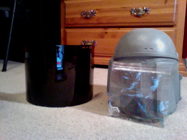

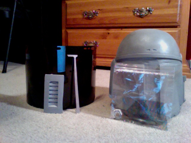

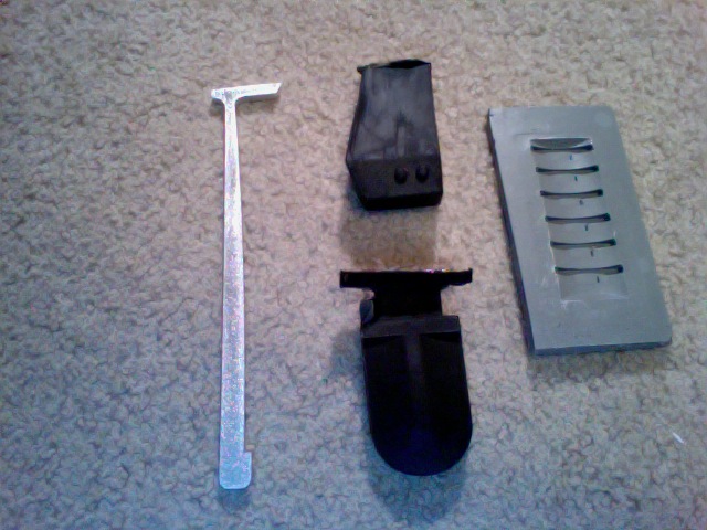

Asok Helmet kit arrived!!! WOW! It is absolutely amazing. Beautiful. Insane shape and details. I've got all the parts. Now comes the fun part.....Finishing it. That will be a ton of work. I'll post progress pics. Here is the kit just out of the box. ;-) Thanx Asok! It's amazing.

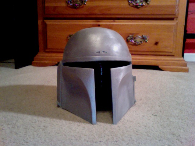

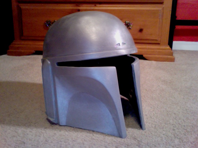

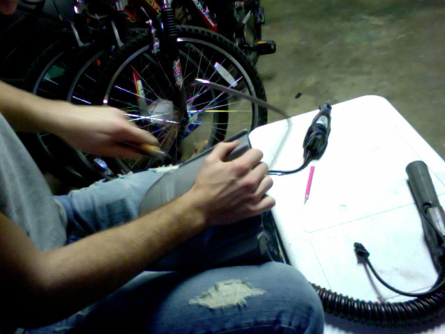

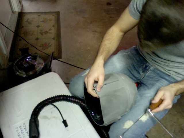

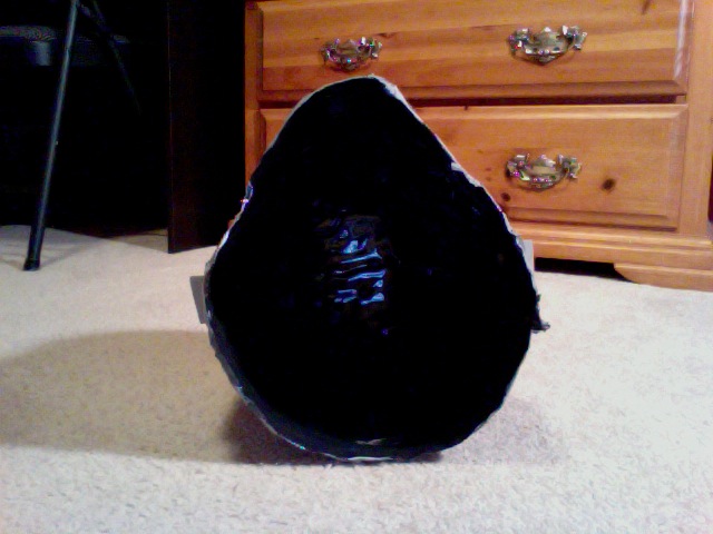

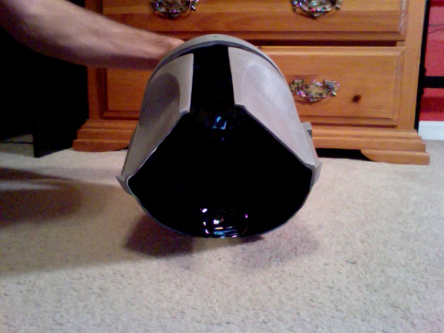

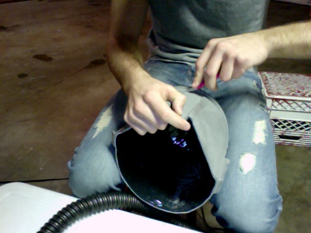

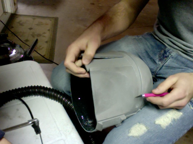

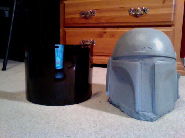

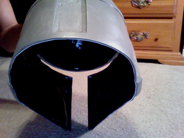

So I have trimmed the excess off the helmet bottom and cut out the t-visor. Wow. It was pretty intense. Thank God for Dremel tools. I started sanding just a bit and I love seeing the metallic finish come through!!! Didn't have any problems or mishaps so I'm stoked about that. Lot of work ahead of me though. Need to buy some more sandpaper....

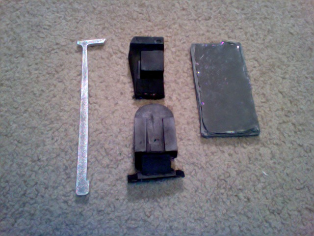

Could someone give me some detailed tips/instructions on getting the keyslots all set and installing them? It would be greatly appreciated. Thanks.
Photo on 2011-02-04 at 21.08 #2.jpgPhoto on 2011-02-04 at 21.09.jpgPhoto on 2011-02-04 at 21.09 #2.jpgPhoto on 2011-02-04 at 21.08.jpgPhoto on 2011-02-04 at 22.21.jpgPhoto on 2011-02-04 at 22.23 #2.jpgPhoto on 2011-02-04 at 22.23.jpgPhoto on 2011-02-04 at 22.22.jpgPhoto on 2011-02-04 at 22.22 #3.jpgPhoto on 2011-02-04 at 22.22 #2.jpg
Mhlayne - I would like to offer a small suggestion, based on my own recent FIRST TIME experiences with a helmet: Don't cut the key slots out yet; wait until all of your sanding and polishing is complete. In fact, if there is a way for you to hot glue the visor piece that you cut out back in, it would offer some more stability while you're sanding, which equals less chance of small hairline cracks due to torquing of the cheeks while you're sanding. I was so excited to cut things out so it looked more like a Fett helmet that I had (and still am) to deal with some small hairline cracks. Other than that it looks great. When the time comes to install the key slots here is what I did (which is by no means THE best way; it just worked for me):
1. Be sure to polish the key slots the same as you do the helmet
2. Cut out the opening on the helmet
3. Place the keyslots inside the helmet and trace the cut out area of the helmet onto the key slots (did that make sense?)
4. Use your dremmel to cut the traced lines, leaving just a tad-bit of excess
5. Hand file, try to install, hand file, try to install, hand file, try to....you get the idea.
6. Once it is installed, glue, epoxy, whatever you choose to keep it in place. Hot glue the mesh in place.
7. Weather the seams to hide any unsavory work
I'm pretty sure there are different, better, easier, etc. methods, but this is one. Good luck!

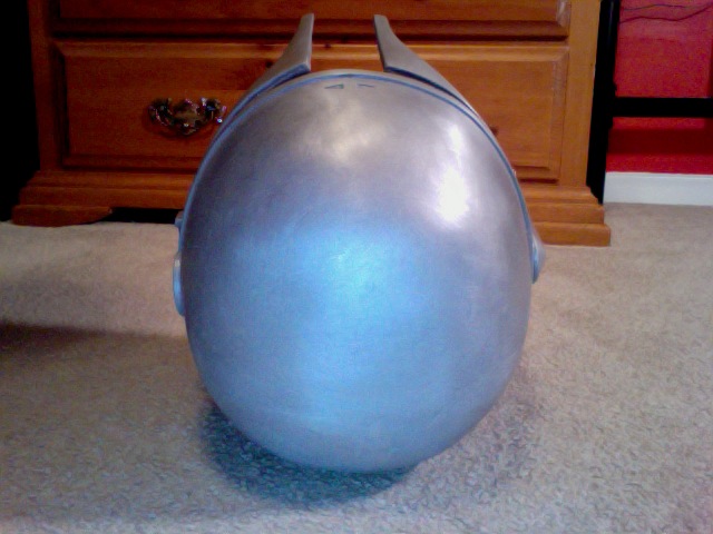

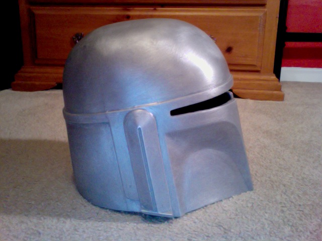

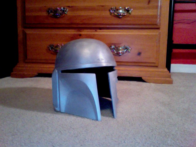

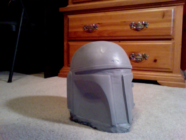

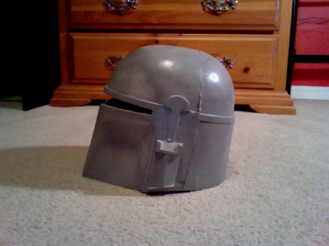

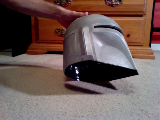

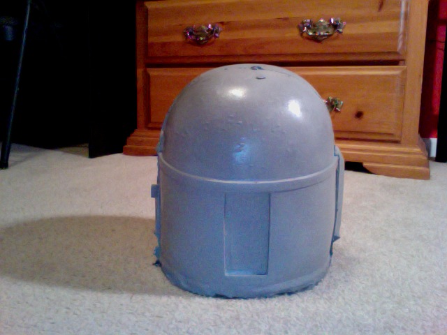

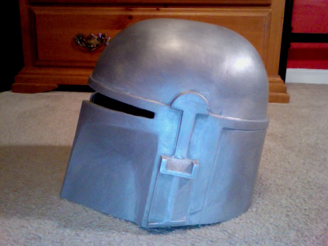

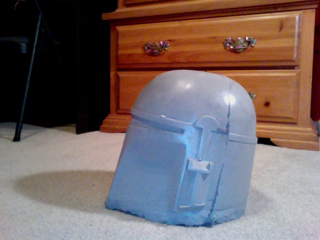

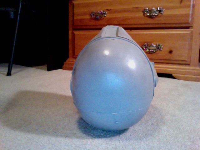

SO I have completed stage 1 of sanding. Getting everything smooth and all excess bumps/dips/all that stuff off. I have not gone over with really fine sand paper yet. I'm going to go back over and just make sure I've got everything situated first.

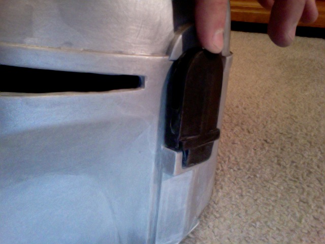

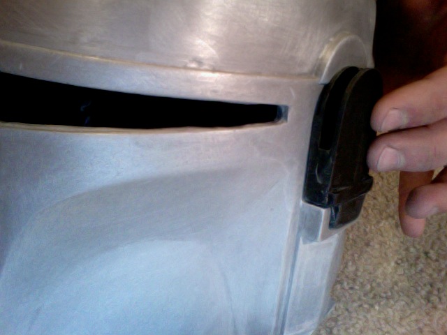

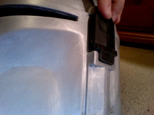

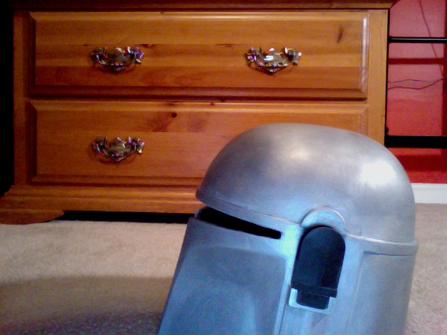

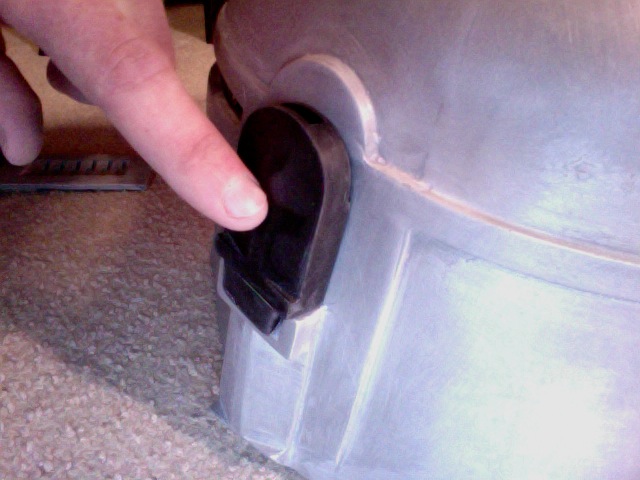

*Question* about the ear piece. Do I have the placement right? Hopefully the pics are good enough to show what I'm talking about. It's not attached or anything so, no worries. ;-) Thanks
Photo on 2011-02-05 at 22.19.jpgPhoto on 2011-02-05 at 22.20.jpgPhoto on 2011-02-05 at 22.20 #2.jpgPhoto on 2011-02-05 at 22.20 #3.jpgPhoto on 2011-02-05 at 22.20 #4.jpgPhoto on 2011-02-05 at 22.20 #5.jpgPhoto on 2011-02-05 at 22.21.jpgPhoto on 2011-02-05 at 22.22 #3.jpgPhoto on 2011-02-05 at 22.21 #2.jpgPhoto on 2011-02-05 at 22.22.jpgPhoto on 2011-02-05 at 22.22 #2.jpgPhoto on 2011-02-05 at 22.20 #6.jpg
Yes the ear sits all the way down on top of the lower section. Look in the gallery and you can confirm how it sits. I think one of the threads in the Jango forum shows how to attach the ear with some small bolts/nuts. I haven't looked for that thread in a long time but that is how I attach mine. Of course I wait to attach the ears till all of the painting is done.
Keep going on the seam across the top and the little seam area just behind the ear. They will go away I promise. What grit sand paper are you down to?
