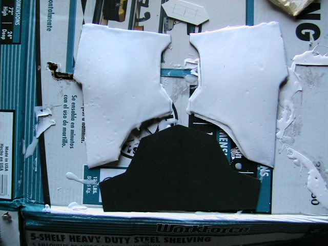

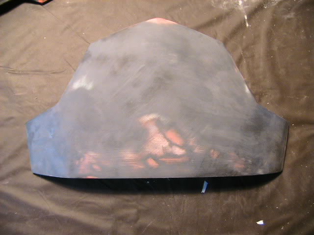

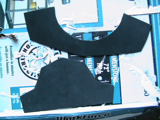

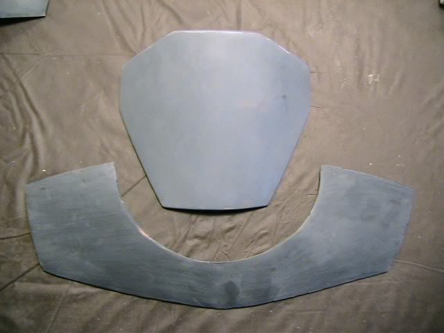

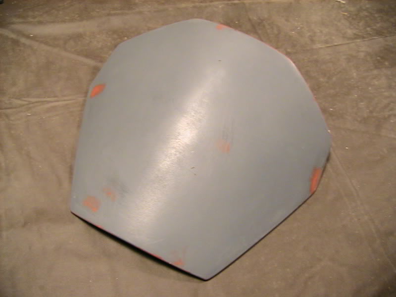

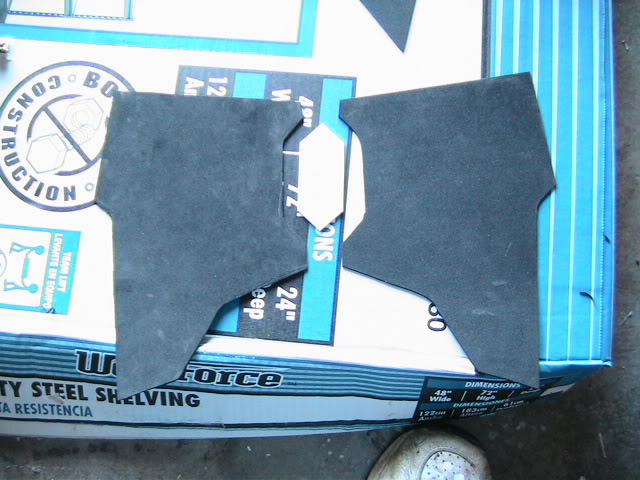

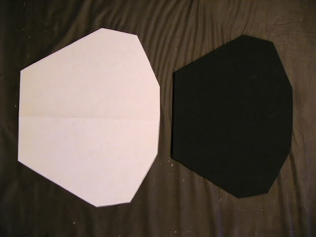

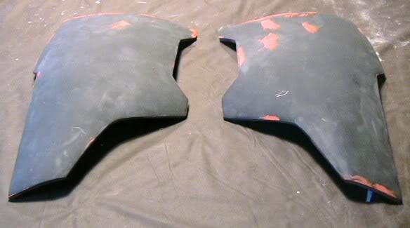

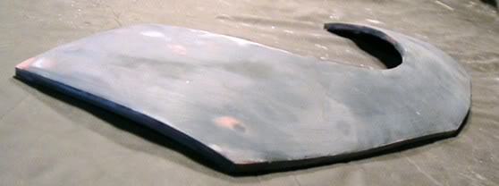

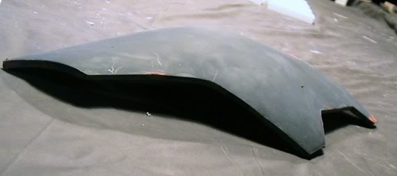

I started by making a drawing of the armor shapes on paper, then traced them onto the foamie sheets. I then brushed resin on them, 3 coats each side, letting it harden between coats. I then took out the heatgun and carefully started to bend the parts. Used various buckets to form the collar, shoulders, and ab, while using a shot filled bag for the 2 chest parts. I then started to smooth out the parts with poly-flex filler, also building up any additonal thickness needed with it.

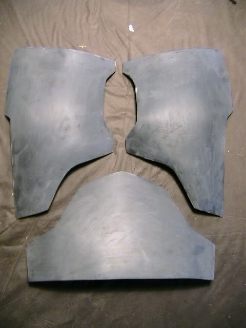

Everything worked fairly well but I ran into a couple snags. You have to make sure you get an even coat of resin on the foam sheets or you end up with soft spots, plus the 2 chest parts gave me fits fits getting nice curves to them. I don't think I would make the chest parts out of the foam sheets if I had to do them over. You end up with the same wrinkles that you would if you tried to heat and bend a sheet of plastic. I ended up adding regular bondo to the backside of all pieces to stiffen them up which was also something unexpected I had to do. The chest parts ended up being msotly bondo in the end due to problems with flexing of teh parts.

Paper tracing tranferred to foamie sheet and then cut out:

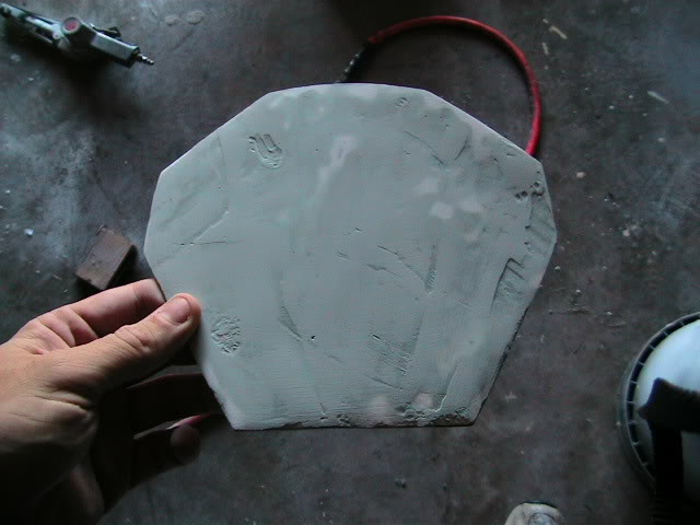

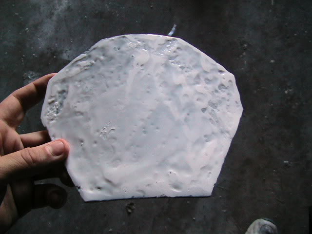

ugly with 1st coat of resin on foam
Starting to smooth it out with poly-flex

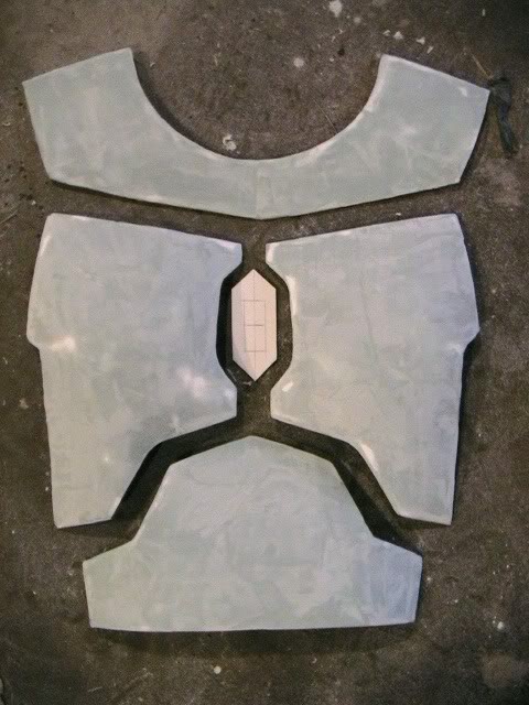

foam chest tracings and abs diamond
chest covered with resin, figured out how to do apply it smoother at this point

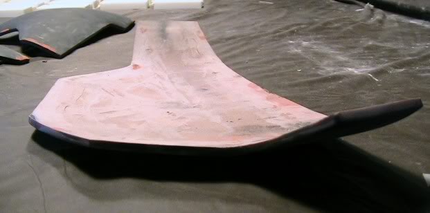

foam collar and ab
resin done and first coats of poly-flex added, also curves beign added

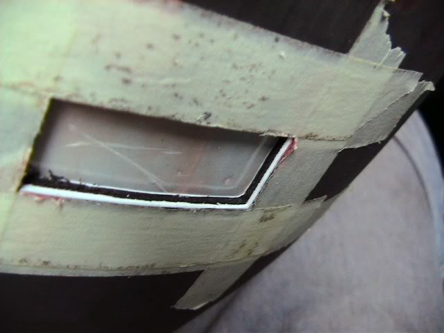

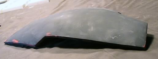

Starting to cut the 2 chest depressions on the left breastplate. It's easier for me to cut one large hole and then make add a filler strip in the middle later on. Notice you can see all the layers. On the back is pure bondo, then resin, foam, more resin, some flex filler, and the primer.

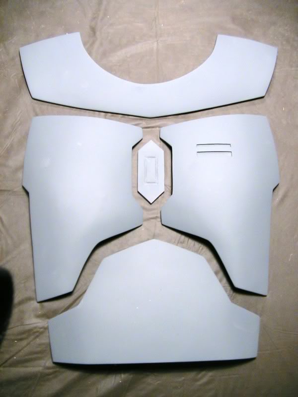

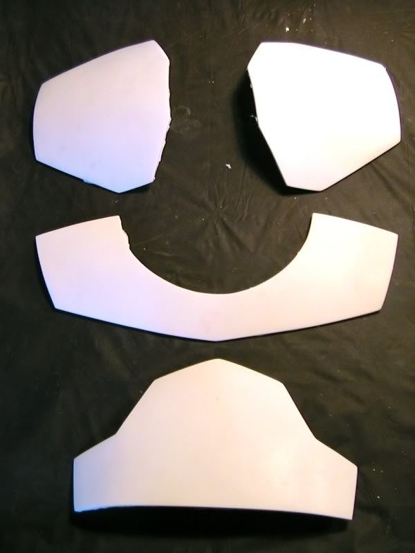

These were the parts close to before molding.
The two breast plates didnt end up being molded as I am going back and modding them some to have the upper edge return towards the body some.

Well, I'm 6' 225 and the BKBT stuff fits pretty good I think, but I'm at the max range for that imo. Alot of the look matters in how how you space the parts out on your soft parts when you are attaching the armor. These parts I did started out much larger when I had them on paper, but as I alluded to on that other board when someone wanted some overlays, I neglected to take into account the loss of overall size when I started adding curves to the parts. Except for the diamond though, most parts are slightly bigger still. Another noticable difference will also be in thickness as I am casting these from .125-.150, plus all these parts have more compound curves to them than my BKBT stuff. A little sanding to bevel the outermost edge and I think these will be some nice looking armor plates.

The weight varies a little, the one prototype set I did got more weight than the others until I found a happy medium balacning the weight and rigidty of the parts, but the other 3 sets are comparable to thick ABS. They are on par with fiberglass I think.
