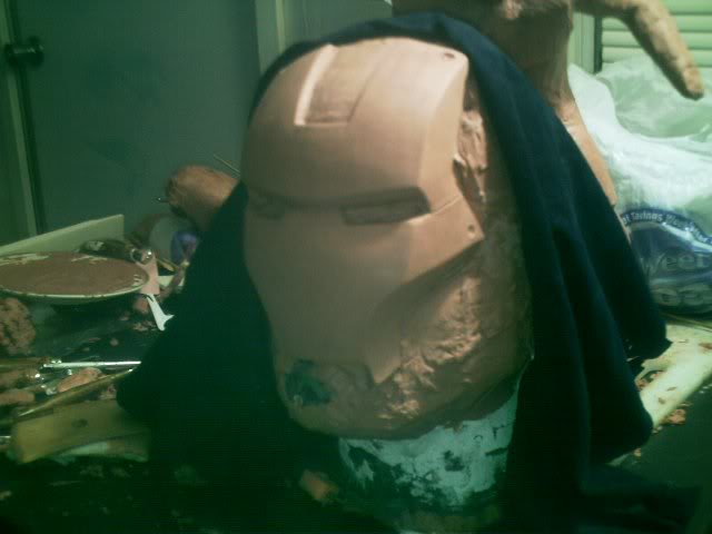

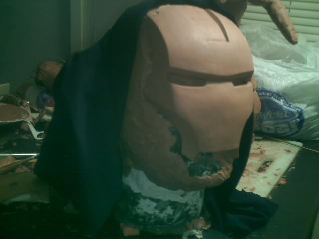

Ready for molding and test pulling, then sanding, and re-mold!!

So you doing casting the Faceplate first, then the helmet? What are you using to make the mold? Ive been using Urethane rubber, while it takes days to dry the amount of detail it picks up is amazing. My first pull had my thumb print in it from where I had picked up the helmet and didnt resmooth it out.

The sculpt looks great so far, suggestion though.. the face plate under the eyes needs to be a tad smoother.. I know alot of the reference pics I've seen "looks" like there is an edge there but i think its just lighting.. (and even my Iron Man sculpt had it there too, but I ended up taking it out before molding it) Other then that great work, keep it up!

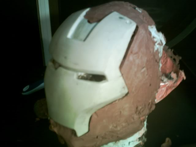

Yea, I am using the faceplate the "scale" the rest of the suit. With the eyes, that's one reason I am doing the suit this way. This faceplate is really just a "test" pull so I know where my lighting and wiring, hinges and other servos will nee to be placed per my tech, when he sends it back, I will sculpt the appropriate brackets and what not.
And again with the eyes, that "edge" on the eye, varies from suit to suit oddly enough; from CGI to Hero suit, to close -up -hero suit to animatronic hero close up - it all changes.

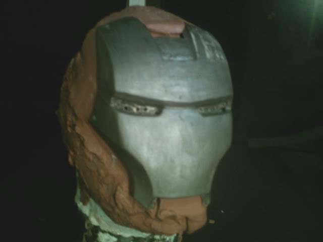

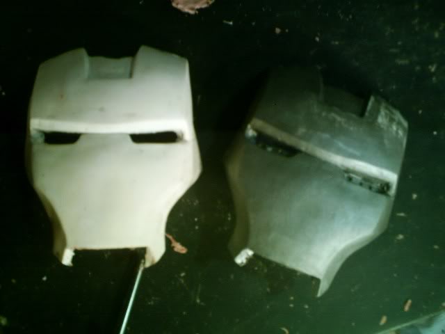

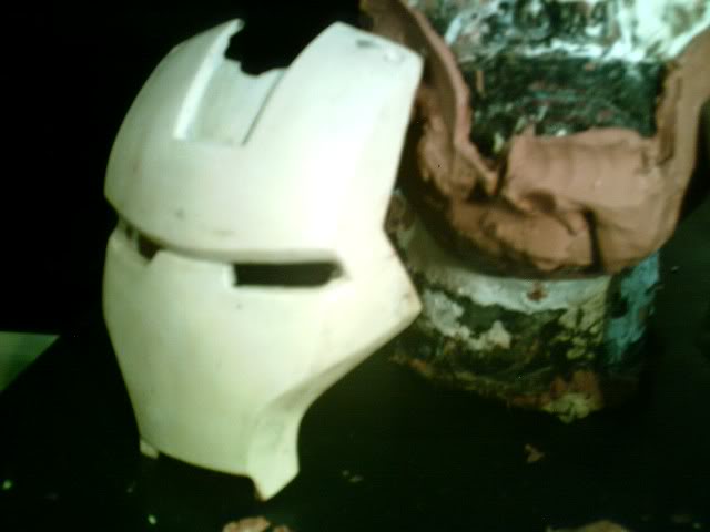

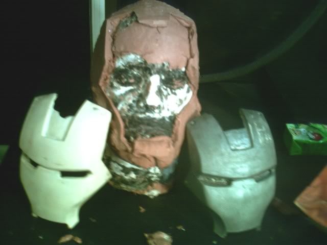

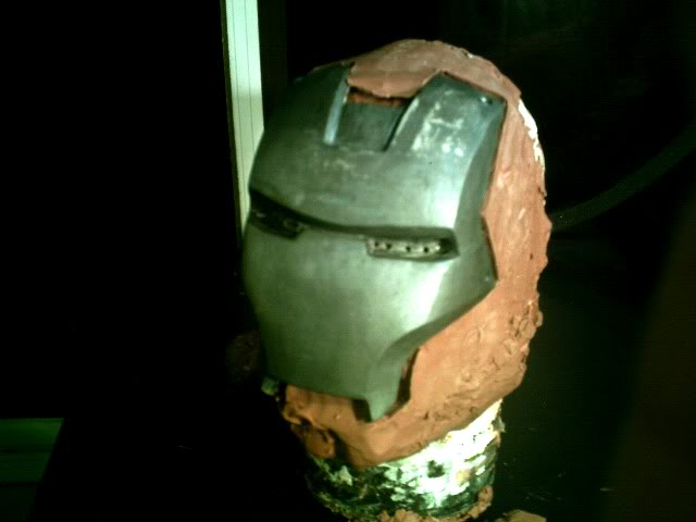

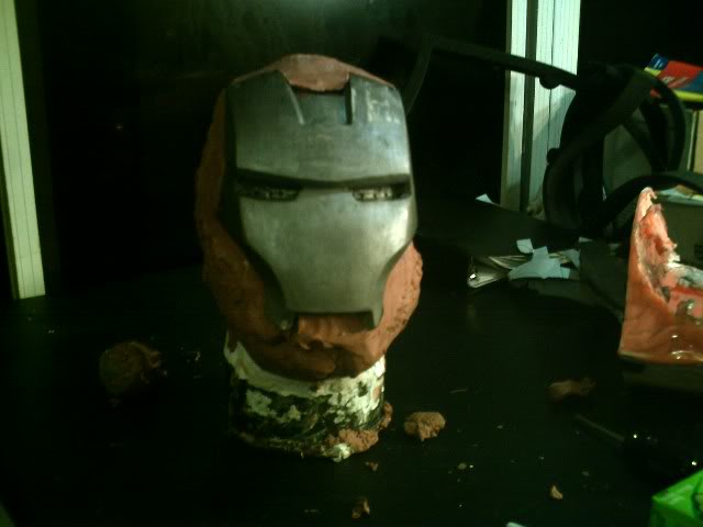

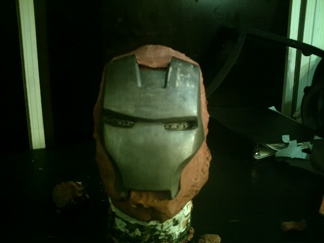

Just a quick update - I pulled these on the 17th and have really been swamped with other work - I am really thinking about switching gears and doing a War Machine suit just because it's a bigger suit, and there are a lot of us who are bigger guys... The pulls aren't sanded or anything just yet, I was toying with some gun metal powder from Alumilite and they work amazingly well - I just wish the pics showed them the justice they deserve... Also in the pic you'll notice the outline for the rest of the helmet... I have to wait for the face plate to come back from my tech before I sculpt the rest of the helmet to accom. for the wiring and servo placement, so this is going to be a big project - be it the Iron Man and/or the War Machine.
But here are the first pulls...
