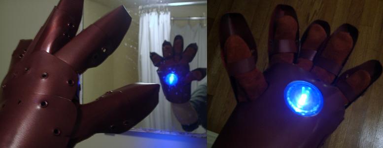

First new thing is a glove covering, I finally found a method that works for making Iron Man gloves, and I got most of my help from a Freddy Kreuger glove teplate. Using "For Sale" signs as material, I have the left glove nearly complete, only thing left to do other than paint it is to find a device to use as the palm light, and lock down the palm plate. I found this perfect little round LED lights, that used twist tops which would be easy to turn on and off in the costume, but I didn't realize till I got them home that they are "disposable" and you cannot replace the batteries. Considering that would make the palm lights pretty crappy once they ran out of juice I am still looking for affordable small disc-type LED lights for the palms.

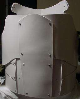

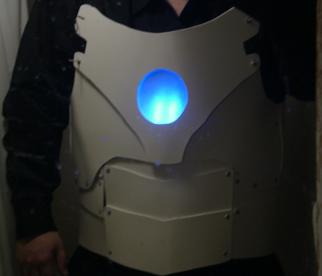

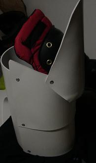

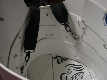

For the Torso, I attached a plate to the back to more closely resemble the back on the movie armor, and also setup a shoulder strap system using comfy gel-padded straps so the main torso piece goes on like a bullet proof vest (the armor however is NOT bullet proof :p). For the chest, I made a piece to go accross the front, a sort of V-shaped plate to resemble that of the V-shaped piece on the movie armor chest going over the cheat uni-beam. The chest uni-beam consists of two thin clear plastic plates stuck together, one I sprayed with a Transparent Blue paint, and the other I rubbed down with sand paper until it became opaque. So with the chest uni-beam light turned off, all you see is a opaque white disc, but when the light comes on, it glows blue.
Pictures of all of this work is as follows: 1st the Glove, 2nd the left leg with Red/Black hidden Kneepad showing, 3rd Torso Back w/New Plate, 4rth Inner Torso with Shoulder Strap hooks attached, 5th Me wearing the Torso with V-shaped chest plate and Chest Uni-Beam Lense installed and the backing light just kinda sitting back there not installed yet.

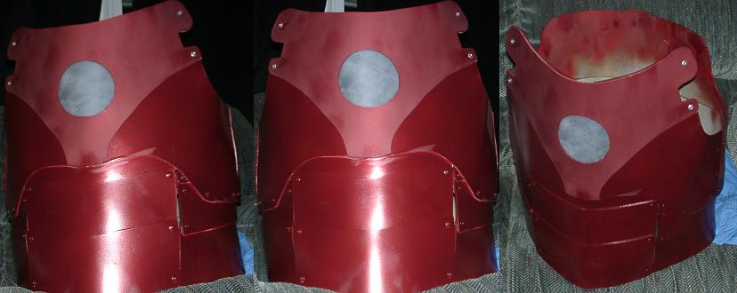

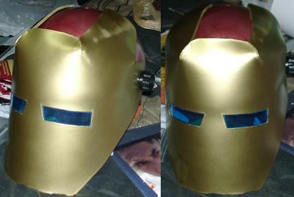

Well, another update, and some good pictures to follow. So I spent pretty much all evening spray painting the pieces I had more or less finished. This includes the top helm and face mask, the left glove with working palm light, and the torso. Pictures are as follows, enjoy!

On the other hand, I dressed up in as much of the costume as I had done for the Halloween party, but am sadly waiting ona select few people for pictures of me in it. If I get the urge I will toss it on and try to take some pictures myself. I will say that the hand lights were pretty cool and useful! To make the grand entrance, my roomate wanted to turn the lights off and have me enter from upstairs in the dark, so being behind the helmet blue tinted lenses with limited visability meant I couldn't see the stairs at all. So I used the hand beams to light my path! :)
The mask still irks the **** outta me, I dunno if I can get the perfection I want out of the Sintra material, but I guess I should just be happy with what I have. The hardest part I am trying to figure out, is the armor "diaper" of sorts to cover the crotch and butt area. Cause I want the armor to be reasonably comfortable, definately flexible, and able to sit down in.

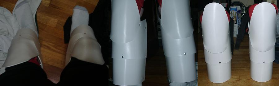

So a little bit of an update, and a couple of pics. A friend stopped by on new years and checked out the armor and thought it was really good, so I got a lil boost to start work on it again. Not too much really, but these are both of the lower legs complete with rotating knee cap. I'm trying to decide whether to attach the upper legs to the lowers permanently, but I fear it will make them too difficult to get into, as getting into the lower legs alone isn't overly simple (although not really too difficult either).
The size of my pot for boiling water is putting limitations on the size of pieces I can use, so it looks like the upper legs will be comprised of several pieces riveted together. This is also why the lower leg / shin piece in two seperate pieces, as I found out the hard way couldn't fit one large piece into my pot. Still contemplating putting the little wings on the left and right side on the bottom of the lower legs to match the movie armor, as well as the under-flap in the middle.
Anyways, first pic is of me actually wearing the lower legs (overhead shot), there are nice soft kneepads connected to the inside to strap on to your leg/knee to insure a tight, flexible, and comfortable fit. Second pic is of me wearing them again but from the front. Last pic is better lighting and just of two leg pieces sitting on the ground. Enjoy!

Paco instead of using a pot of boiling water have you thought about picking up a heat gun and trying that?
I didn't have much luck with a heat gun. The distribution of heat was uneven, and the plastic got too hot too fast.
I've been able to bend Sintra by putting it in the oven at 200 degrees Fahrenhiet for about 2 or 3 minutes. You can make a cardboard or chipboard shape, then lay the sintra on top of it. Paper ignites at 451 degrees, so the wood, cardboard, chipboard or newspaperboard should not catch fire. It will get warm, but not ignite.
Let heat and gravity help and this stuff will kind of bend itself around the shape. If you are using 3mm Sintra, just increase the time in the oven, NOT the temperature. Trust me on that. :lol:
Keep an eye on your sintra. At 195-200 degrees, it should not get so hot that it begins to bubble, any hotter, and it will ruin it. Water boils at 212 degrees F, so with the oven at 200 -210. If you're worried about fumes, it's about the same thing as immersing sintra in boiling water.
I always open a window any way.
:lol:
yeah, I have not tried the oven method as I do worry about the fumes, it may just be silly, but I worry about the fumes and possibly causing the insides of the oven to become toxic and then when I throw my oven pizzas in there, I don't want to have to worry about getting sick.
The heat gun was actually the first thing I tried, but it came out to be pretty difficult IMO. It took quite a while to heat the pieces up to where I could form them, but then reheating "quickly" to reform again right after the first time took too long. As well trying to heat up large pieces so I can bend/form it all at once wasn't very feasable. Then I heated up a spot a bit too long and it started to burn/melt the Sintra and left a nasty brown spot with bubbles. I ended my heat gun dealings at that point and switched to boiling water.
