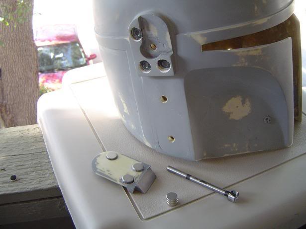

For the side pieces, I recommend using nuts and bolts, as outlined in SpideyFett's MSH2 thread. This method requires a Forstner drill bit to counter-sink the bolts into the ear pieces.
http://www.thedentedhelmet.com/showthread.php?t=13855
For the earcap, I recommend using 'Power Magnets' found at Hobby Lobby. A few of us got a chance to work with them this past weekend, and they are tough little suckers! They come in a package of 6, at 1/2" in diameter. A 1/2" Forstner bit makes a perfect hole to counter-sink the magnets. Instead of using magnets for the base, I used 1/2" metal washers (thinner, yet still powerful enough to hold the earcap in place!).

I was just Christmas shopping (ugh!) and happened into the crafts section of Walmart for more paint, brushes, Goop (which I finally found!), etc and walked by the same magnets you were using above. They're Promag 3/4 inch diameter magnets and wondered if they'd work to hold on the earcap. I wasn't certain whether they'd by strong enough, or at least as strong as those you guys are using...I think they were $1.37 for an 8 pack of magnets-now I just need to buy a Forstner bit, unless I can find my drill bit stash. Wish me luck!
