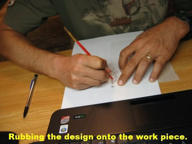

I flip the tracing paper over and trace over all the outlines on the back side. This gives me a mirror image of the template.
After you've traced onto the back of the paper, it's a simple process of holding the template (right side out again) against the helmet and rubbing it onto the surface. I just use the back of a skinny paint brush to transfer my pencil lines.
Here I'm transferring the pattern onto a sheet of paper.

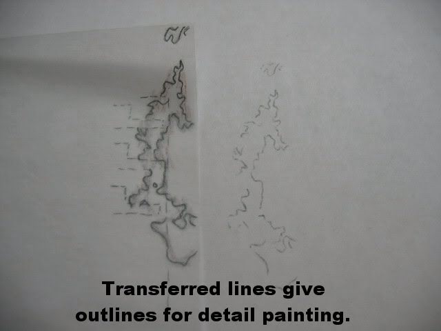

What you'll wind up with looks like this:
Once your template is transferred to the helmet, you can use it as a guide when painting on the damage. I still keep the reference pictures handy while painting. The templates give me a great guide for shapes and proportions, but it's practically impossible to transfer every tiny detail. So the good ol' eyeball is still tremendously important!
