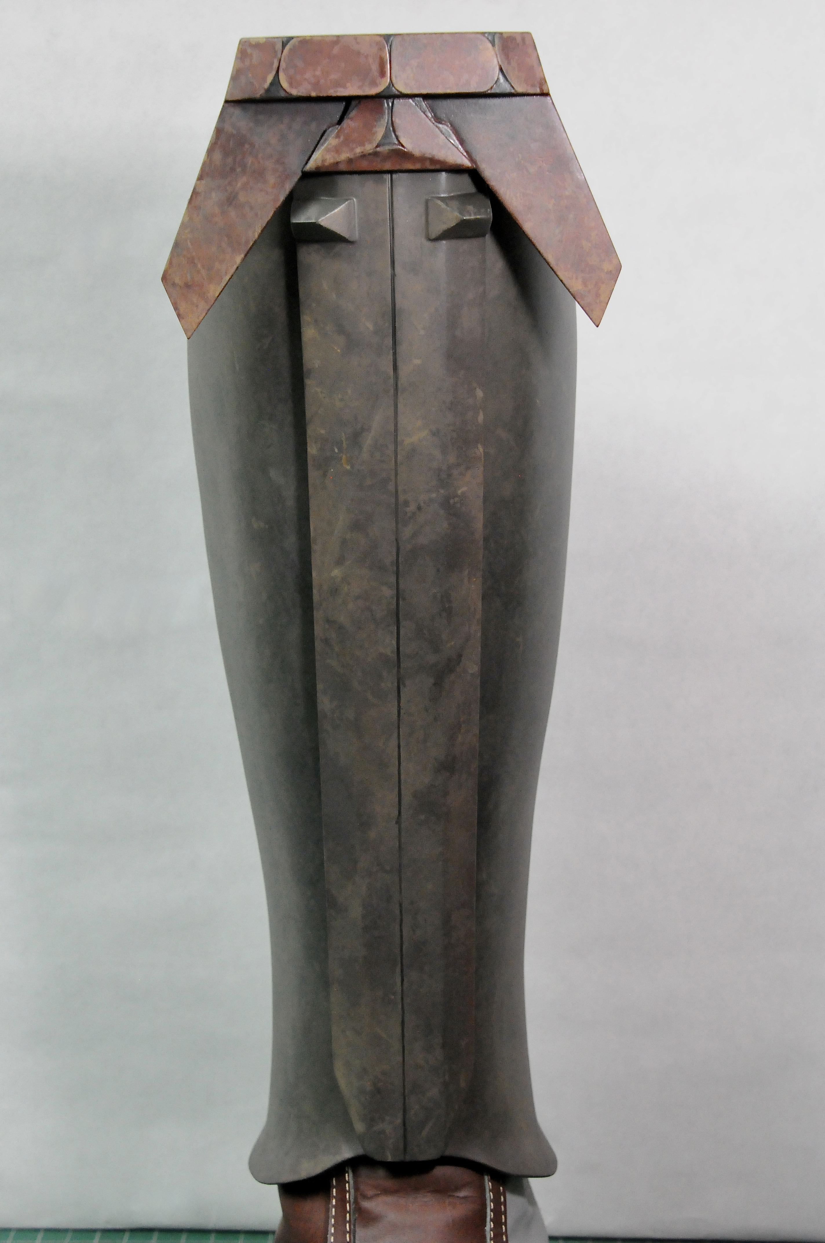

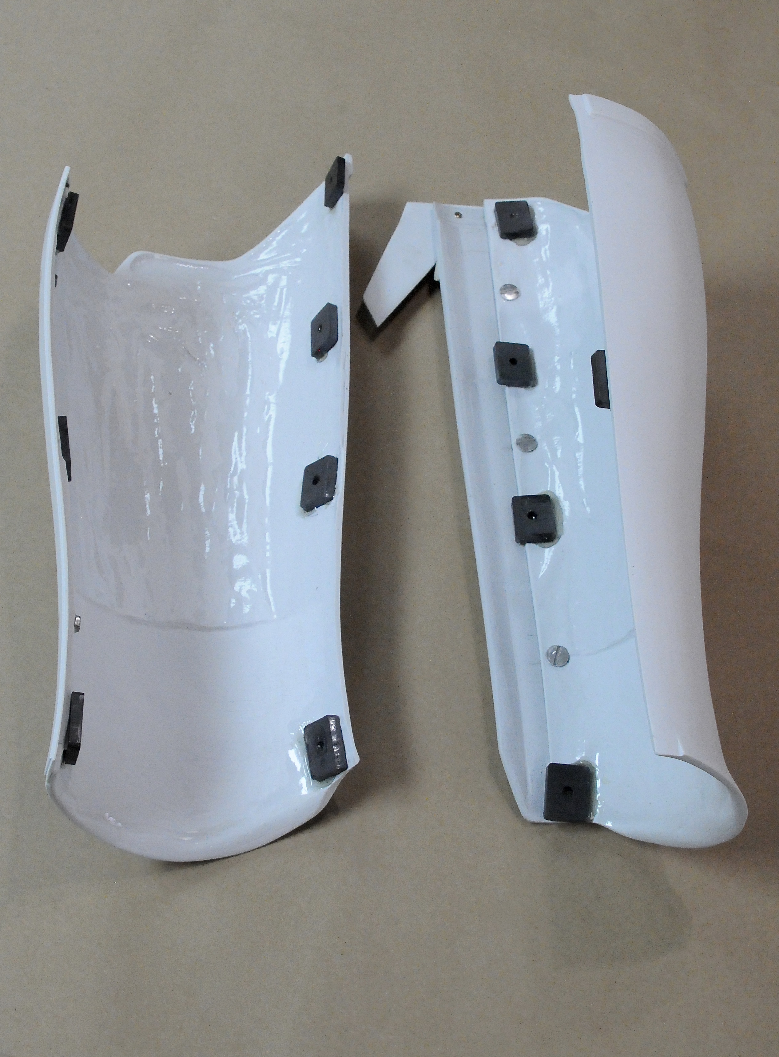

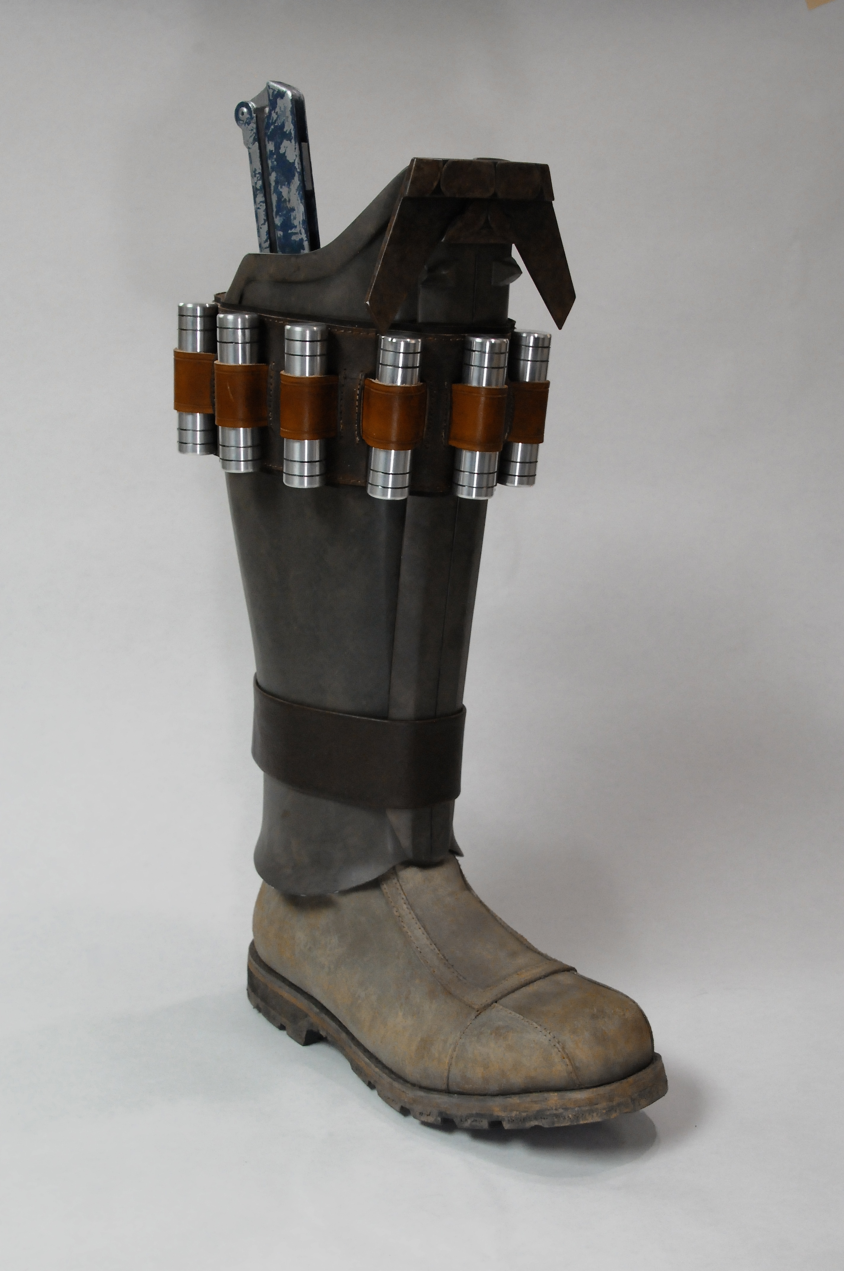

How to attach the V on shin piece
This is the way I worked the shin piece out with magnets. As you can see when snapped together the magnets
are offset on the center line of the halves to keep the halves alined. The v is screwed to the top edge of the front strip. Then that strip is screwed to one of the halves. When the ankle and calf straps are added
everything holds together just fine. Happy building!

Phenomenal paint job!
