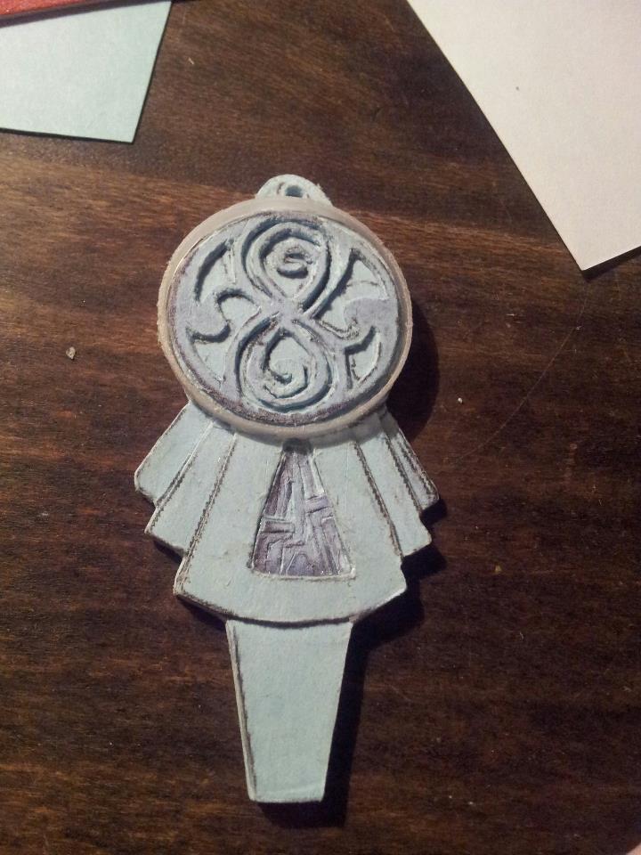

Hi, I'm new here but I've been making paper models for a few years now, I need to know how to go about making a mold of my paper Dr.who Tardis key.
I'm not sure about pressing the key into clay because it's made of paper, and I don't want to ruin the key by pouring plaster on it.
Do you guys/gals have any ideas?

Thanks for the link, Do you think I could just paint some kind of paint seal or something to give the key a water barrier? if the paper is protected and I spray some anti stick on the key and then use plaster or silicone to make the mold i would think it would work.

I was just going to suggest that. You can spray an acrylic clear coat on it to seal it. Once its COMPLETELY dry you can make a silicone mold from it. I think its the best way :) Let it dry and air out for a coupleof days to be sure all the chemicals in the clearcoat evaporate or they will react with the rubber and may prevent it from curing properly, or at all. I learned this the hard way. So give it a couple days after your final coat and you should be good to go :)

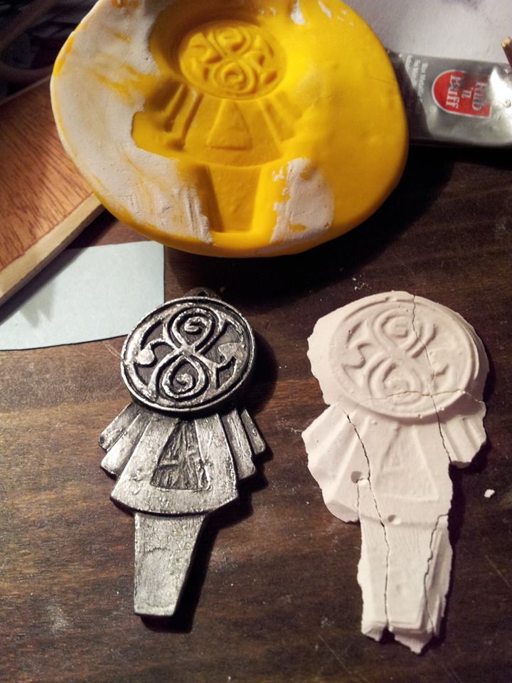

I will try that, I will post pictures of the progress.
You should make a mold before you paint the original. Sometimes, even with a release agent, silicone clings to the paint and you end up with flakes of paint in your mold that come off a little in each casting. I'd suggest filling in your paper from behind with some kind of resin or filler (like Bondo) to make sure the weight of the silicone doesn't cave it in at all.
