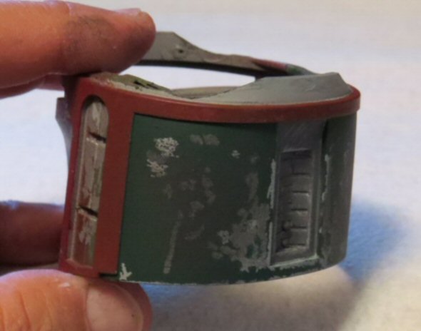

The back panels are pretty much complete. *Whew!* I actually made some basic templates for these using
Rafalfett's ROTJ stencil set, LOL. I had to greatly reduce them in size and just do outlines for the most basic
shapes. I referred to the reference pics to get the finer detail.
For the green I mixed up a custom shade using Polly Scale Southern Sylvan Green as a base, then darkened
it with some PRR Brunswick Green. I have some CNW Green, which a lot of people think is the color used,
but I felt at this scale it was just too dark.
The gray damage was all done with Floquil Primer, applied with my 18/0 round brush. I "stained" the darker
areas using a wash of Polly Scale Tarnished Black.
In these pics the red band has only had the RI Maroon "primer" applied. I still need to mask and mist with the Rustoleum Cabernet.
I also went back and lightly misted some Tarnished Black over certain areas. It's really tricky to limit the misting in this scale!
The keyslot area was based in Polly Scale BAR Gray, with scratches added in Floquil Primer. I dotted the two dental
files with some medium red, but it doesn't really come through in the pics. I'll add a little more.
When this is dry, I'll mist the final red color on the band and ear platforms. Then I'll work on that portion of the detailing.
The dome is still to come! (Gulp!)

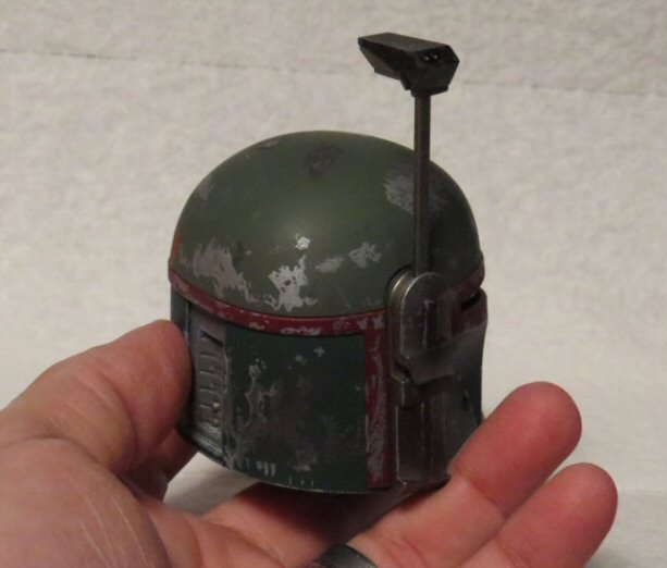

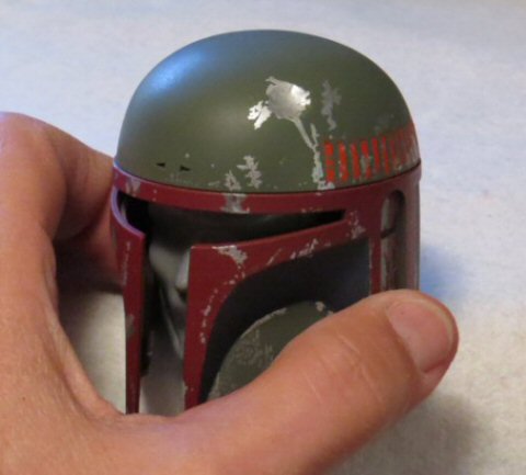

As near as I can tell, the helmet is done. :) Man oh man. . .
This was very challenging for 2 reasons: first, working in 1/4 scale; second, this my first ROTJ helmet paintjob of any type!
So it was uncharted territory for me. Hopefully I've captured at least the essence of this style. It surely tested my eyesight
and the steadiness of my hands, LOL.
Here are some pics. The obligatory "staring you down" angle.
We'll just move around the helmet now, starting with the killstripe side. I added some fine silver scratches on the ear parts, too.
Everything was misted with a couple of light coats of Testors dull coat after the paint work was completed.
If the helmet was a single piece instead of being broken down into the dome and lower parts, this would have
been much more difficult. Well done, Hot Toys!
Some additional fading was added using colored pencils (very lightly).
Here's a slightly higher angle of that giant scrape on the right side of the dome.
I'll do the final assembly on the figure tomorrow and get some pics of the whole thing when I have time to get
pics using some bright indirect daylight. All of these pics are taken with direct incandescent light from overhead,
so there's some glare and color shifting.

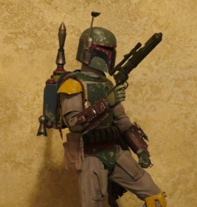

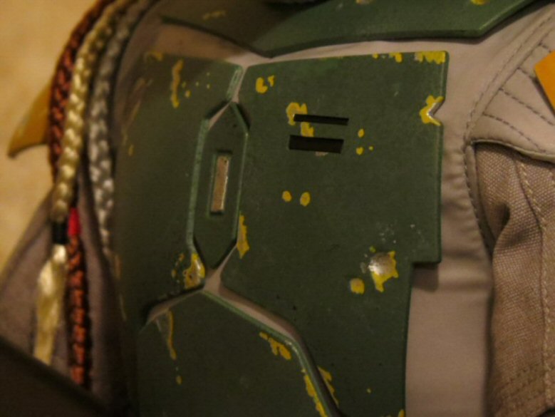

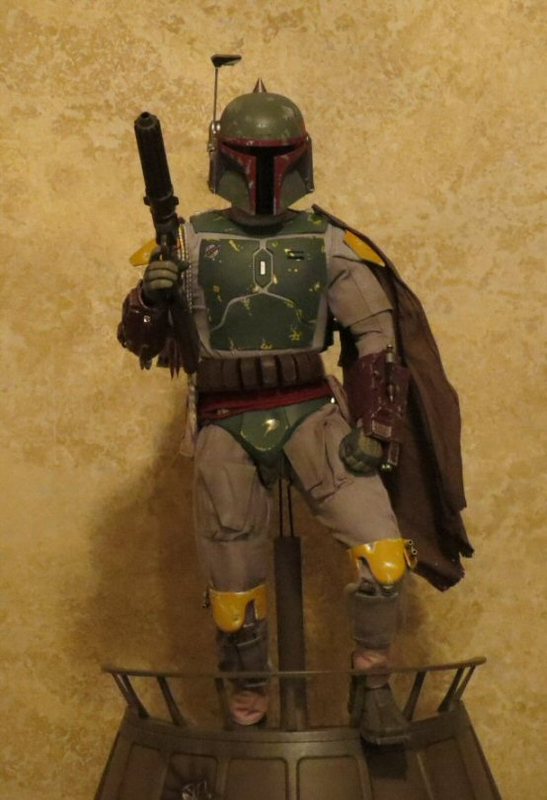

Boba is reassembled and resting comfortably after his ordeal. He was kind enough to pose for some pics for all the
crazy Fett heads out there. First, a couple of overall shots.

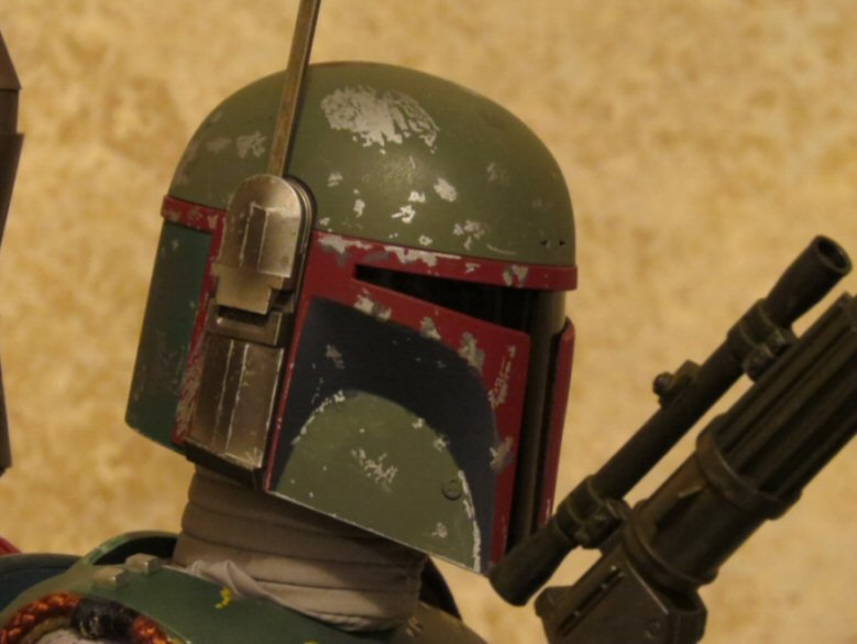

Some closer views showing some of the new details. Let's begin with. . . the helmet! Big surprise, right?

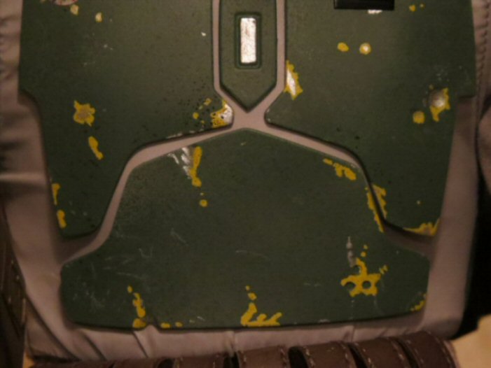

Here are some shots of the chest and abdomen armor. I tried to get lighting that would show the misting passes
which built the color up slowly over a lighter base. Some of the faded looking spots were done with colored pencils,
and the spatter was applied by flicking an old toothbrush with thinned flat black. However, I did actually go back with
a very fine brush (18/0) and dot in some of the more prominent spatter--especially on the lower half of the right chest piece.

So that's it, kids! :) I think Hot Toys really created an amazing 1/4 scale figure. I just wanted it to look more like I picture
the ROTJ version. This was extremely challenging and a ton of fun to do. Thanks for following the progress, and even as
a "stock" figure, I highly recommend this piece.
