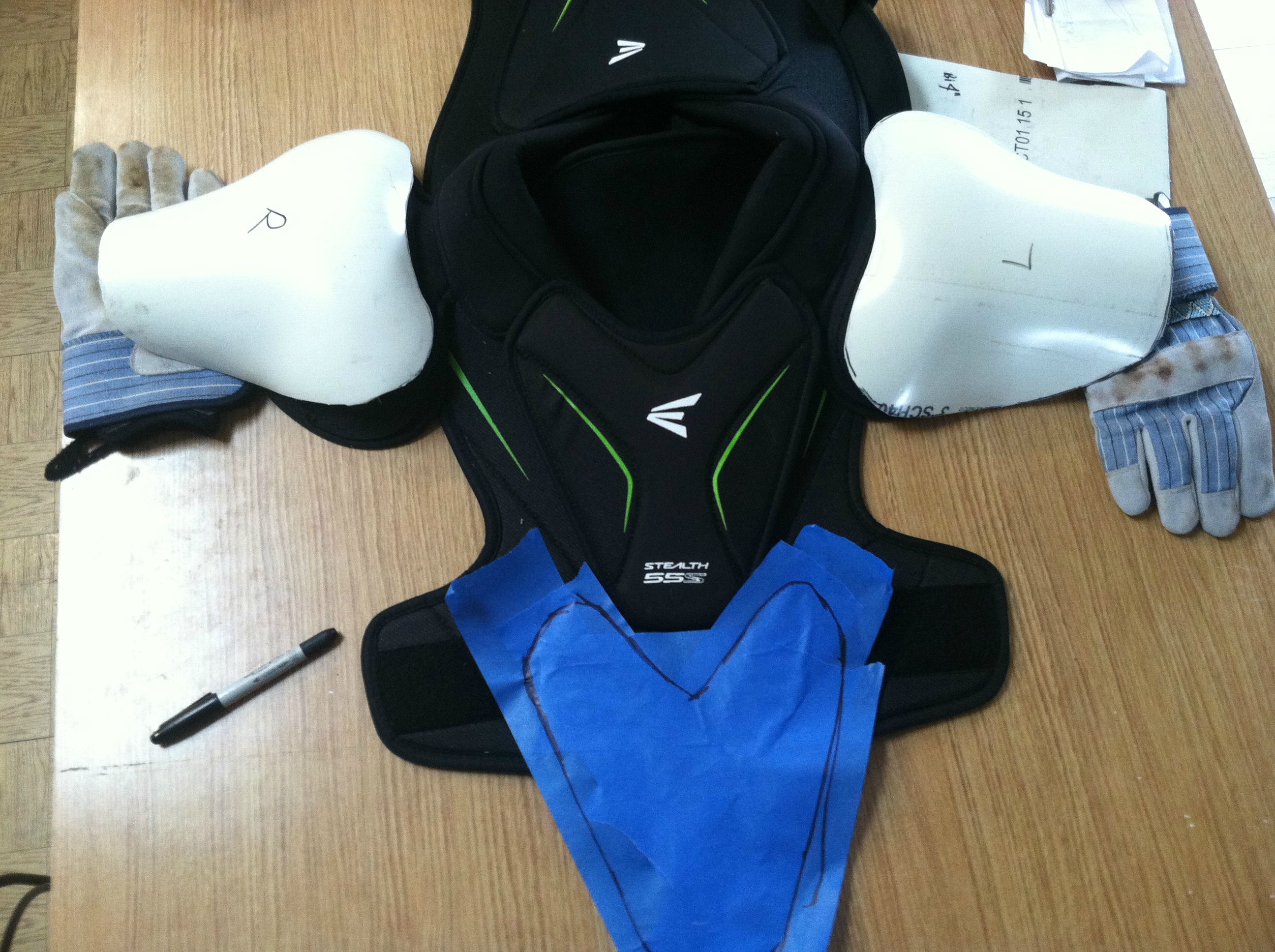

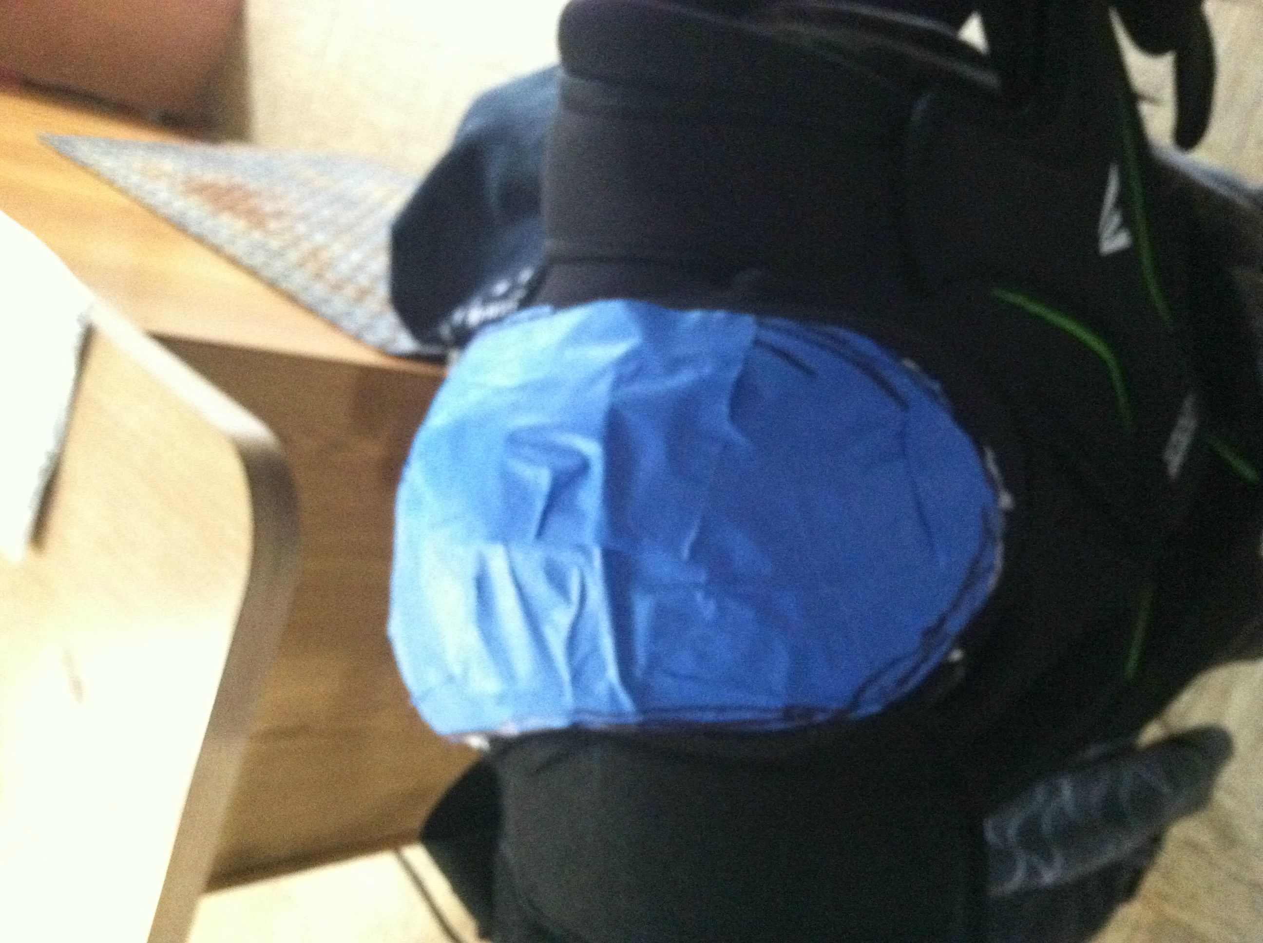

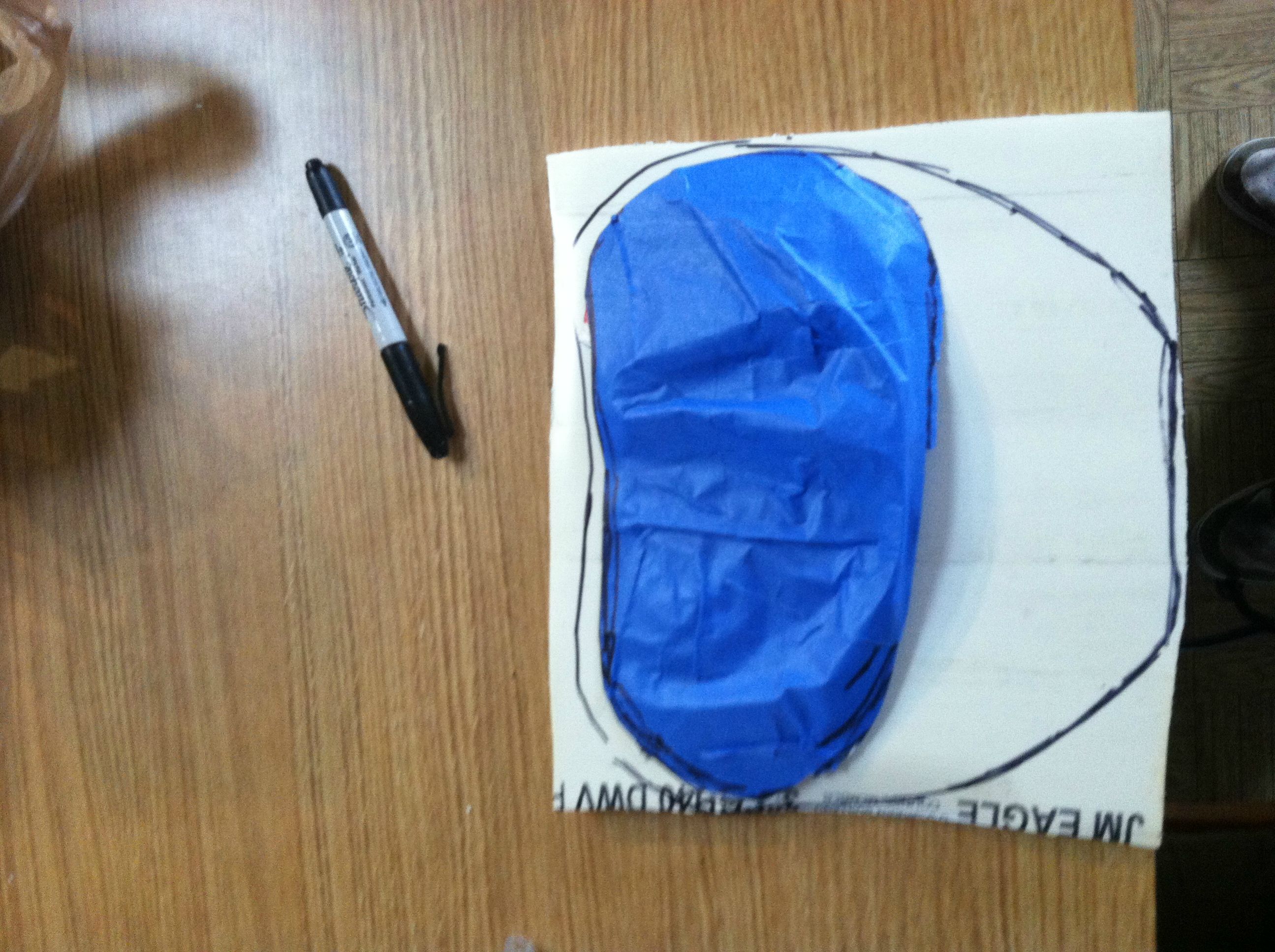

I used painters tape to make stencils for PVC "armor"

Cut the basic sizes you need according to your stencils
Split them down the middle

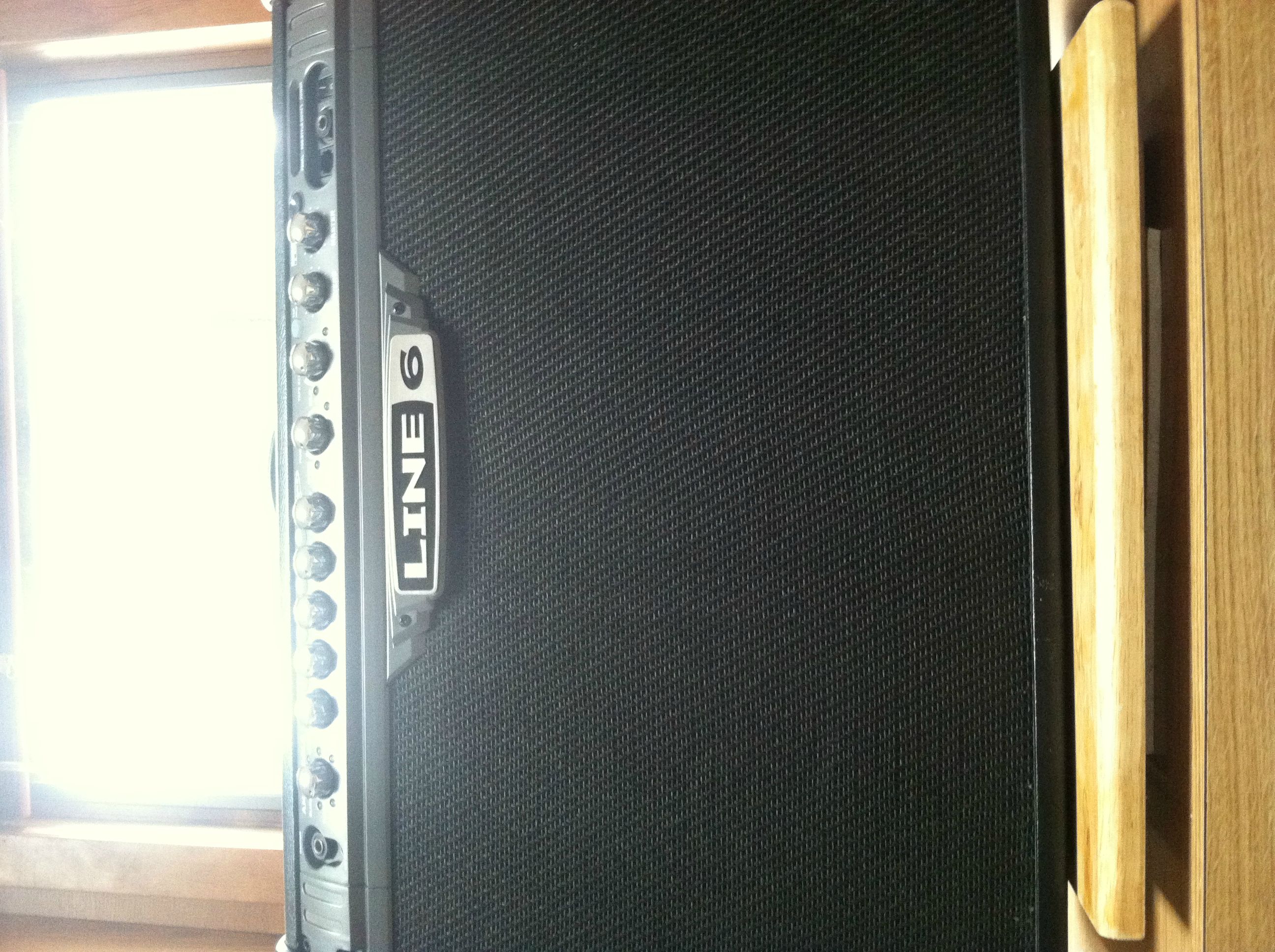

I used a cutting board and my Rather burly line 6 amp on the counter

Trace your armor stencils onto the Flat PVC pieces

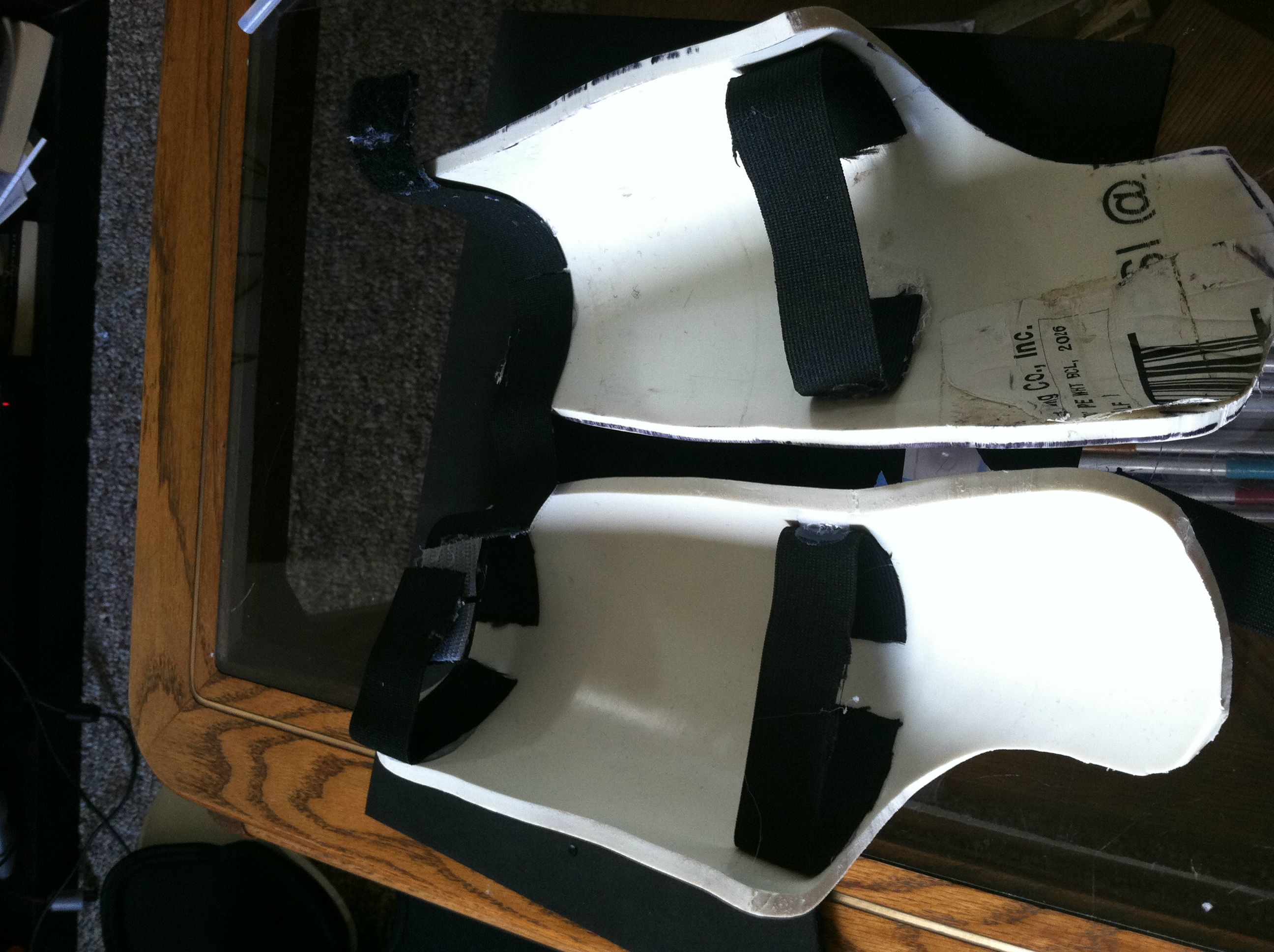

Shape the shins, hands and gauntlets to your body...
Shape the shoulders to the pads...
I used Velcro on the shoulder armor to hold them on (For easy transport)

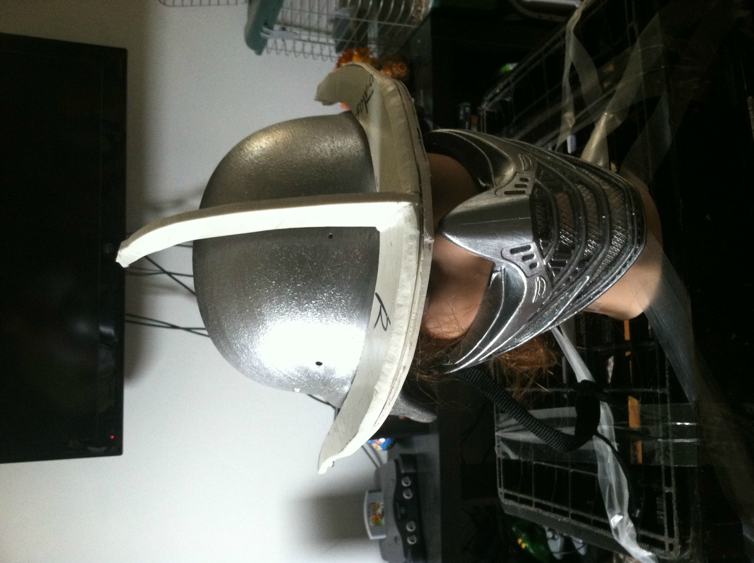

The helmet is a big pain in the butt
Shape, Cut, detail, paint... I knew I'd want the mask off some of the night to drink, eat and carry on a conversation when I wasn't posing for picture... It's important to eat food (To maintain those gains) and drink booze (To maintain that buzz) Priorities first. I had to make the mask its own piece to put on under the helmet... I did have to remove the helmet to put on/take off the mask. I'll fix that down the line.
AFFIX ELASTIC STRAPS WITH HOT GLUE
