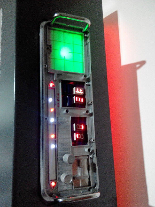

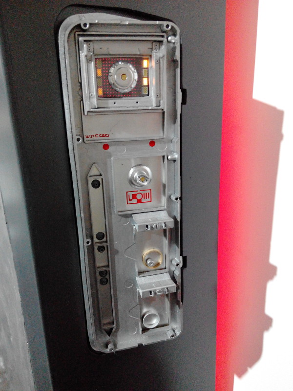

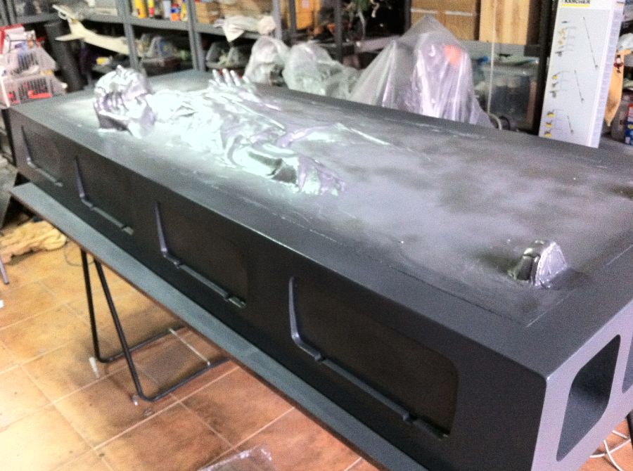

I just wanted to share my work in progress. I have been working on it for almost a year, and now it is worth showing. Not finished yet, but I am very happy about how it is looking already. Now I need to mask the dark grey area and paint all front silver. I did paint silver the front to see how it looked, but did no mask it when painting grey and now I need to repaint it. Once painted, I will try a black acrilyc wash.
I have built some details for the base and the top, a vent grill and some cilinders. I like the look of the Gentle Giant Statue (the one with boba and the two stormtroopers), just as some people have already done.
And this is next step, I am about to start painting greeblies.

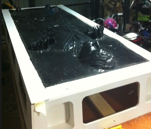

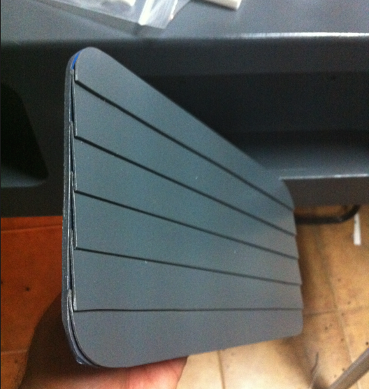

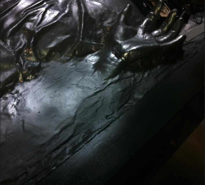

That looks great! How did you create your vent grill? I really like that look and will most likely add some lighting to the top and bottom through the vents. Also, what HIC panel did you use? I have a Stormrider full rubber front and am curious as how to blend it with the mdf box kit edges. It's a Zenix kit.

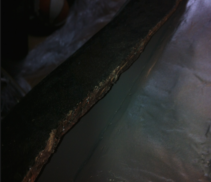

It was a stormrider full rubber front, with frame. But I did cut the "frame", since the box I built was slightly bigger. Anyway the rubber height on the frame was not even all around and I was having a hard time trying to sand it where it was too thick and fill it where too thin. So I just cutted just where the frame ended and the carbonite surface started and I rebuilt the frame with plastic.

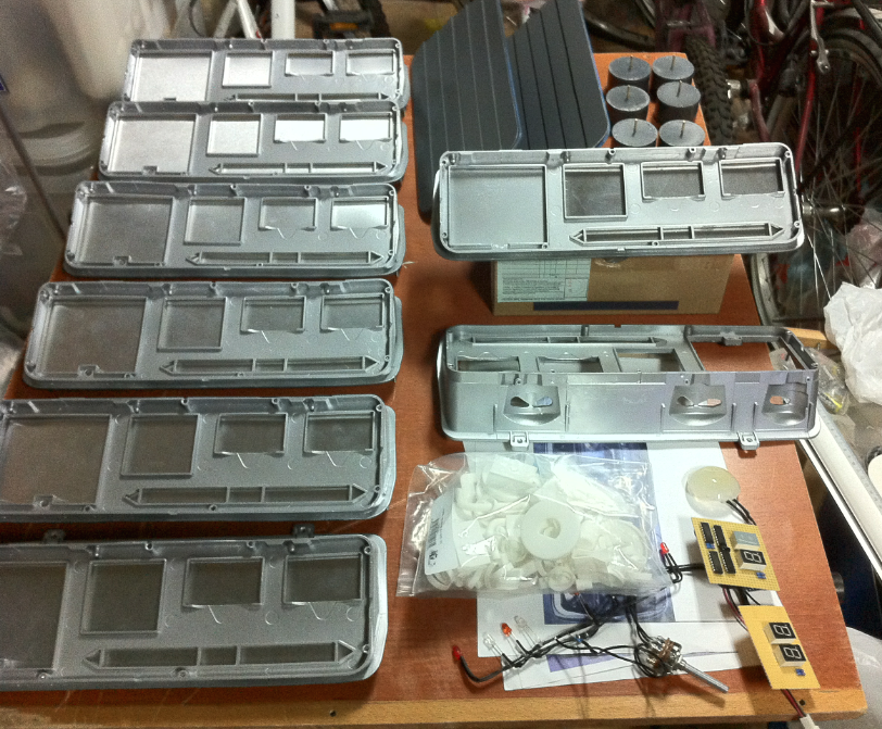

This a picture of the leftovers
To fill the gaps between the rubber and the frame I used hot glue and bondo to fill the gaps. The hot glue helped to keed the sides of the rubber on place, too ;-)

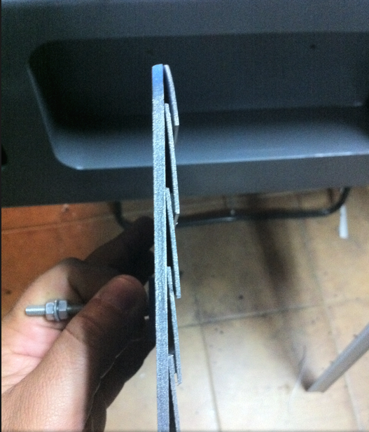

I have built the vents with plastic, just cut a piece the size of the big hole on top and bottom, to use it as base, and using that as pattern, cut another piece the same width but a little higher. Then cut that second piece in 6 pieces horizontally, and put one at the top of the next, just a few millimeters, to give the vent grill look. Not my idea, somebody else did on this forum before!
HIC_JMHE_GRID.pngIHIC_JMHE_GRID_SIDE.png HIC_JMHE_GRID_BACK.pngHIC_HMHE_GRID_TOP.png
I used some extra plastic to make that "step" a little bigger.

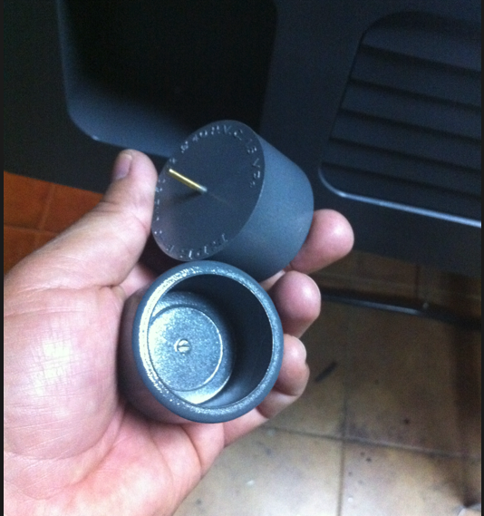

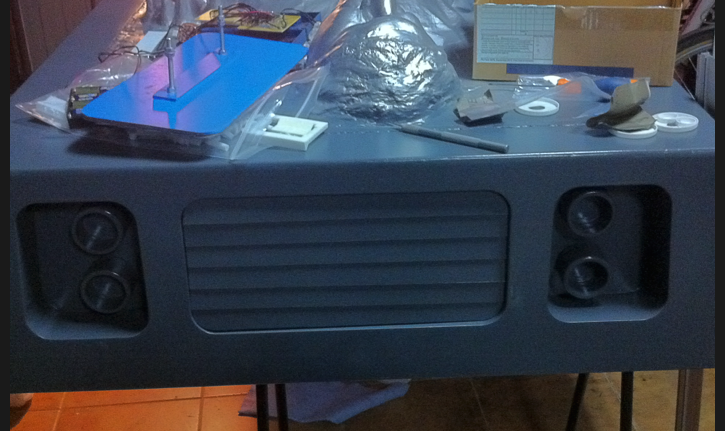

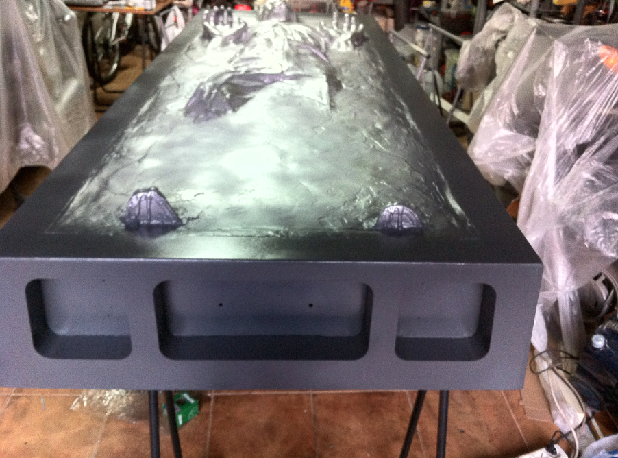

I added a couple of PVC cilinders
And this is how it looks:
I am happy about it.

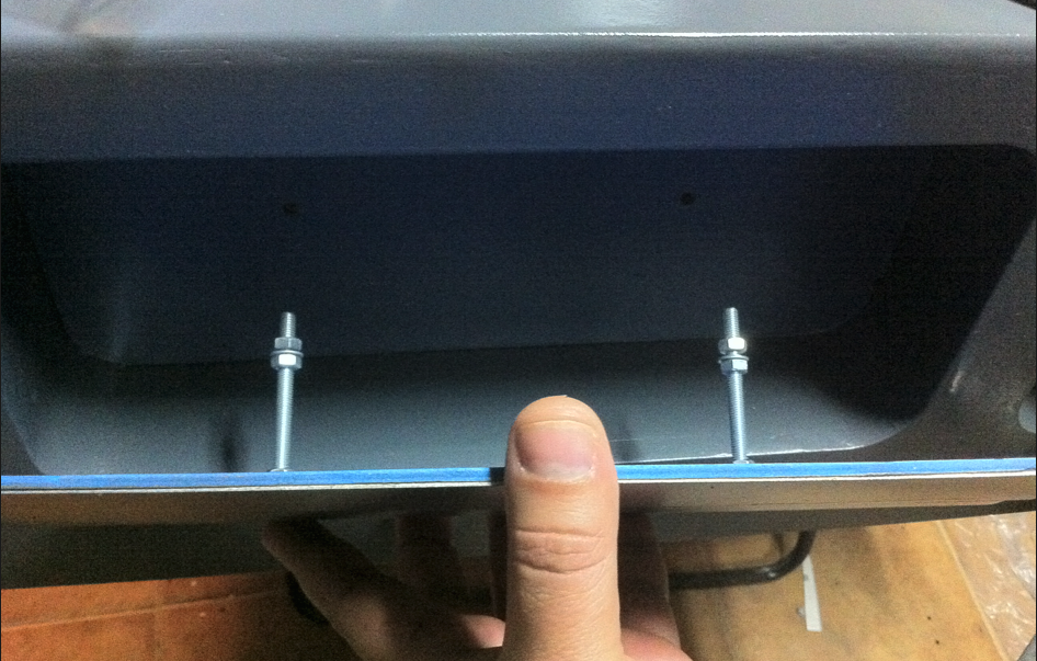

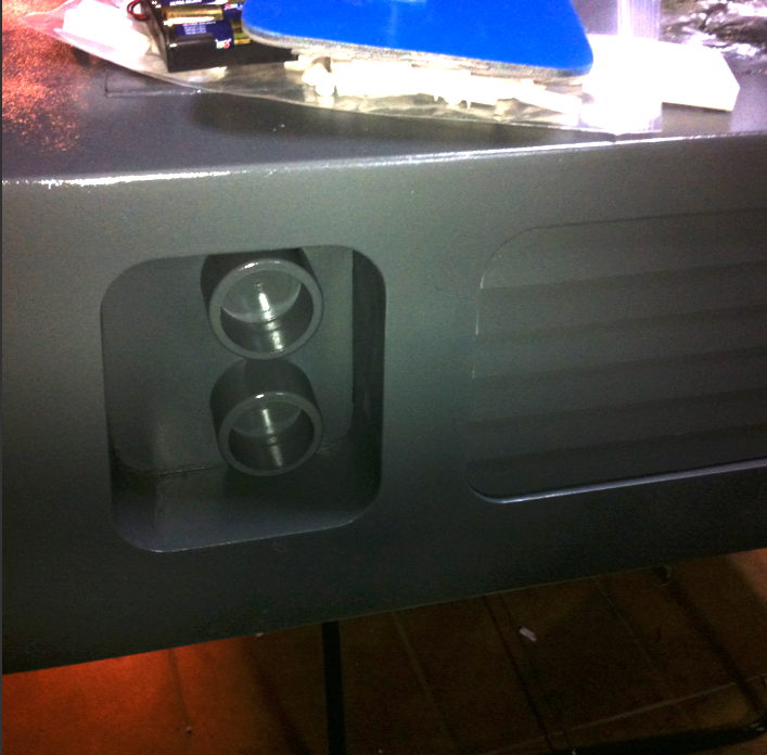

I just wanted to share how I built the "holes" on the box out of a flat kit. The box was built out of a kit done on plastic by a guy here in Spain. To make the "holes" for the vent grill and the PVC cilinders, I used some thin plastic, made a few cuts on the corners to allow bending, and then nailed it to the box with very thin nails. And then applied a lot of bondo to it to hide the cuts.

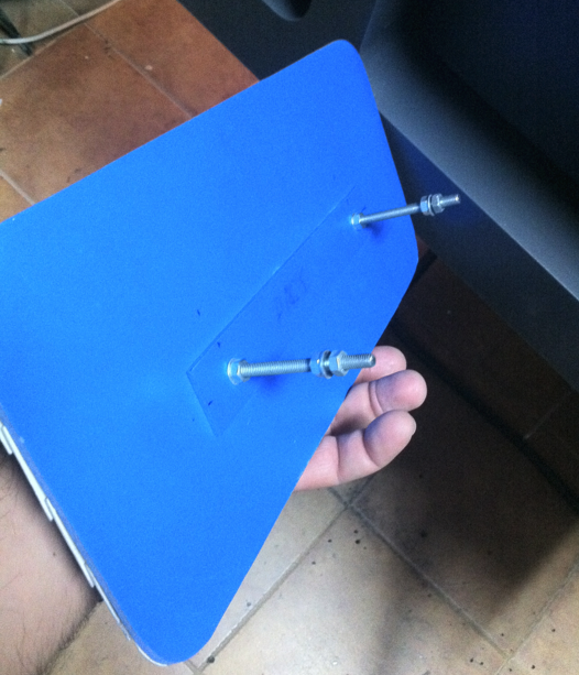

I glued the rubber front to the box with glue, but I did put a few nuts and bolts through the rubber to secure it to the backpanel on top of the box. Actually I did use a few bolts around the head, the body, the legs, and then down around the feet, and I did put some on the corners, too, just to make sure the rubber would not come over when the HIC is on upright position. I hided the nuts heads with bondo. The hot glue that I used to fill the gaps between the frame and the rubbers helps to keep it on place, too.
