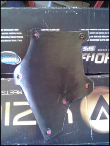

Alright, here is my tutorial for using line 20 snaps to attach plates to a flak vest.
1. attach one end of the snaps to the plates using some form of adhesive (JB weld is what I use)
2. Put a bit of brightly coloured paint on the tips of each snap

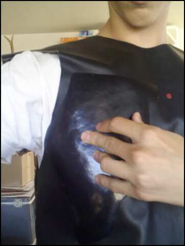

3. Press the plate into position on the flak vest, making sure each snap presses against the vest.

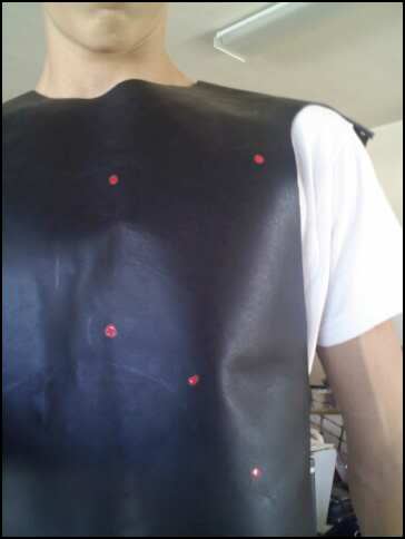

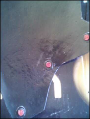

Once you pull the plate off, it should look like this:

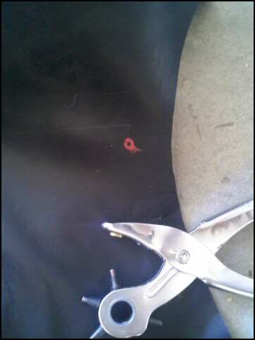

4. Punch holes in the flak vest in the center of the red dots:

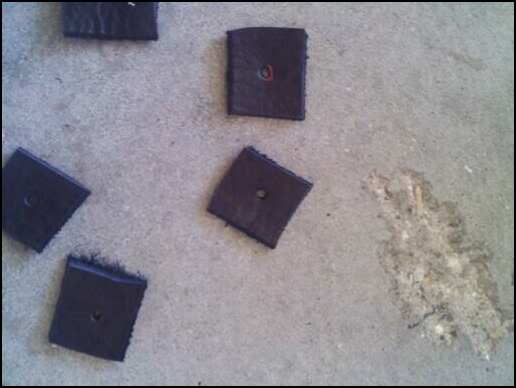

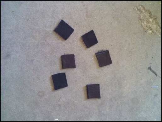

5. Get a piece of scrap leather and cut it into 2-3cm squares; punch holes in the center of each:

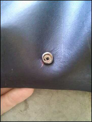

6. Set the other end of the snap into the vest, backing them with the leather squares:
Once finished, it should look like this:
