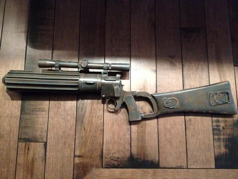

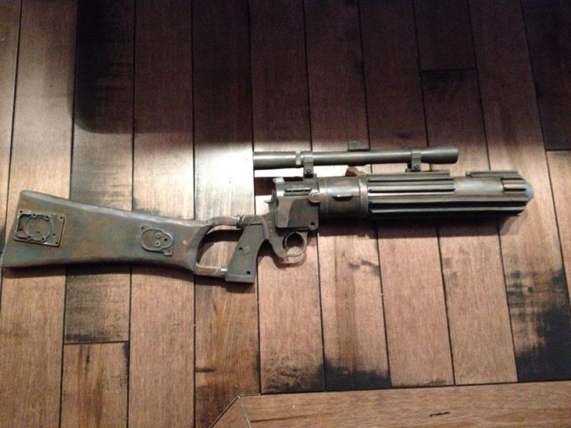

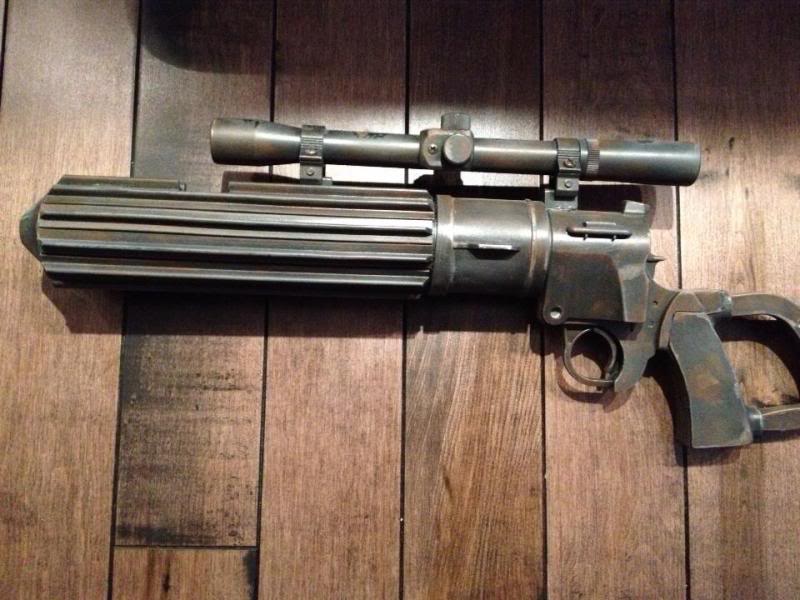

Thought I'd put this up for anyone looking for an alternative route to go about the ROTJ blaster. Started with the basic Hasbro green and grey monstrosity, wow that thing is ugly, but it does clean up nicely! Don't have a shot of how I got it, but we've all seen it and shuddered. My plan was to leave as little of it as possible, size it back up and make it look like a respectable blaster Boba would be proud to carry. Took a while LOL

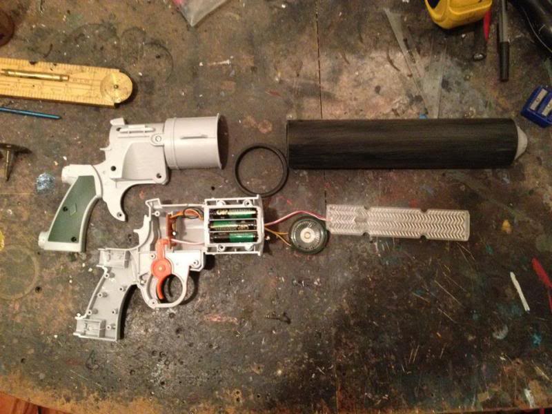

Here is is disassembled, along with the electronics I kept working, the new barrel and the barrel ring.

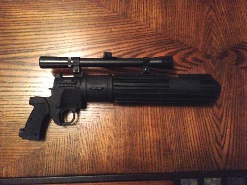

Assembled, with scope, muzzle and various filling

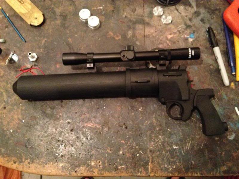

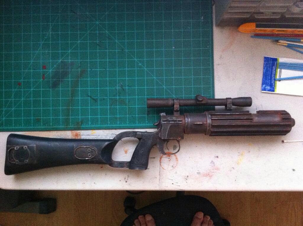

Coat of black on it, starting to look like something
With T track from Blastech installed
Not quite done, but needed to make it work for my 501st profile pic, so a head on shot

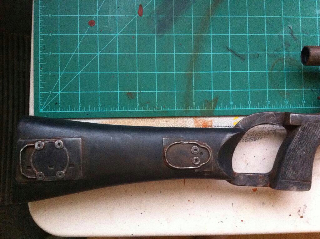

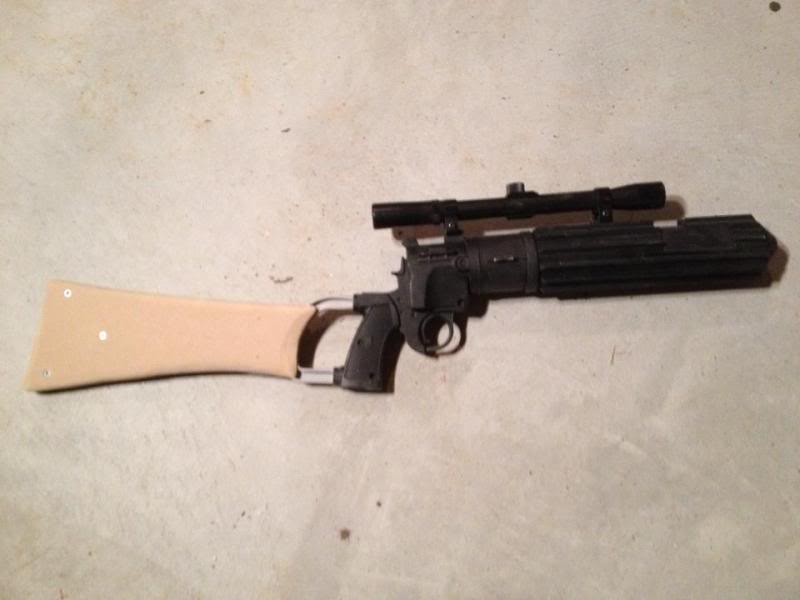

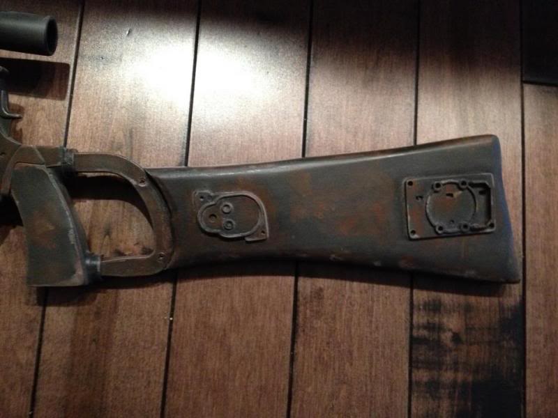

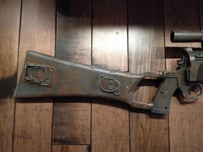

The stock finally, made by rescaling images of the screen used blaster and the using that as a template to trace and cut a 3 layer mdf press board basic shape. The middle layer was constructed to accommodate the stock attachment D handle that came with the Hasbro, makes it fit perfectly, and is removable for transportation. All 3 layers were glued and screwed together for the ultimate hold. Then it was sanded to be an all one piece unit, spot putty to fill it all in and it was in business

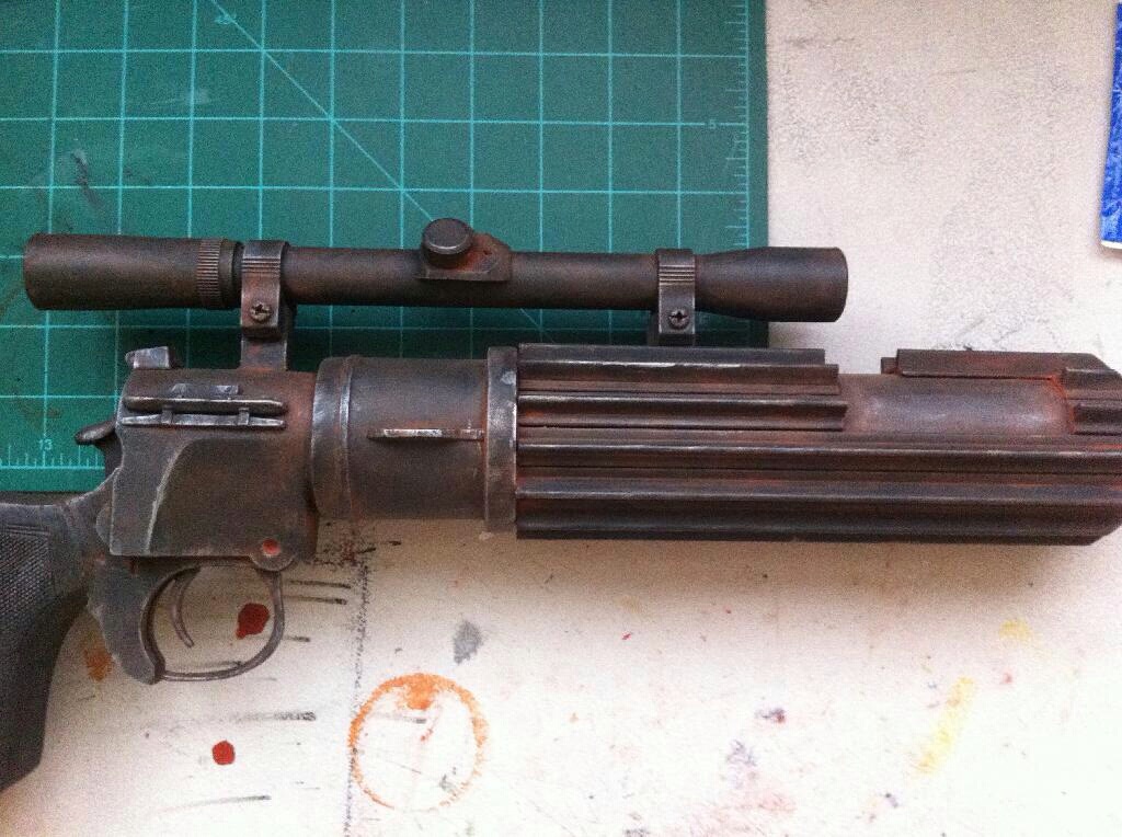

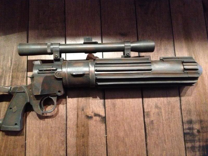

And the finished blaster with paint. Still slightly undersized (9 - 10%) but pretty serviceable and has working sound and light to boot, pretty pleased with the outcome. Stock greeblies suppliedby Asok, thanks again man!! All in, $30 for the Hasbro, $20 for the T track, $7 for the scope, $8 for the greeblies, $5 for materials (I already had most) So for $70 total hard to beat!

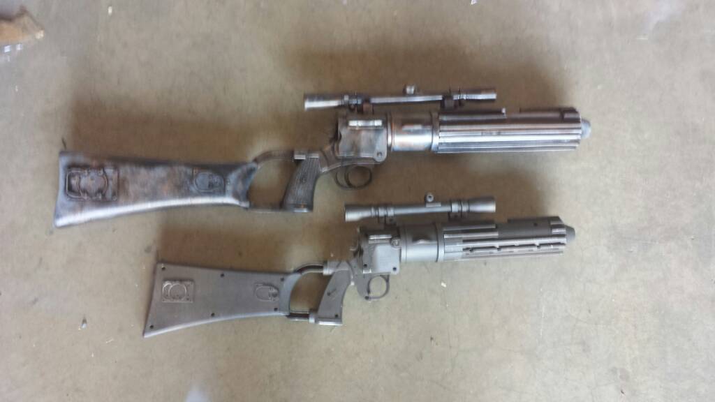

Figured I would chime in on this one as I to myself did a mod on a hasbro EE-3, (check out my thread) though most of the pictures have been deleted the finished photos are still there. Ok yes we all know the hasbro is a really, really bad representation of the EE-3 but it can be made to look like a really good blaster. All you have to do is get the juices goin and the skies the limit. In my case I pretty much took it down to the bear minimum and started there. I did my research getting every measurement as close as I could and after finishing it and taking it to comic con it looks pretty close to what the pro's are doing. In the end I was happy with it and that's all that matters.
On buying what I call a (true blaster) hyperfirm, sidewinder, these are the cream of the crop and have every right to be. But are by no means cheap, if it comes to me spending $150 (what I spent on mine) as a posed to spending between $350 an up for a better one I choose to take the road less traveled. In the end do whatever is gonna make you happy that's all that really matters.
