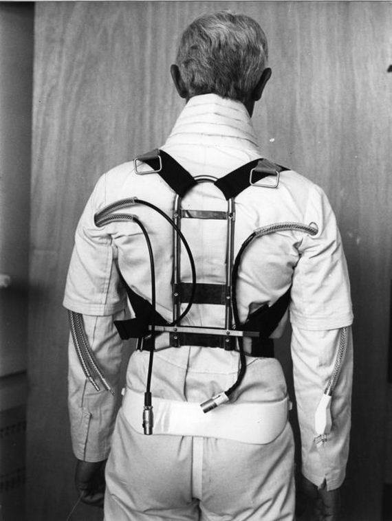

So i have a question..on my pursuit for accuracy wearing my Fett suit, i noticed something off. In the promo shots from the back, the harness is not seen at all. It doesnt look like the ammo belt is over it, but im not sure. On mine, you see the harness sticking out below the jetpack. Now i have the lower hooks where they are show on the heilman photos. I have a MOW pack in these pics, so i know its a little undersized, but i dont think it should affect this. I COULD just put my ammo belt over the harness, but i dont know if thaths "Correct". Honestly im not sure if anyone knows lol. Anywho, Heres a comparison of mine and the promo shot.
So, how do you guys set up this part of your suit?

Well the thing is, no matter where the harness is on my back, the pack will sit in the same place in relation to the harness, and the bottom of it [the harness] sticks out. The 2 hooks on the pack that hook onto the bar are mounted all the way on the bottom edge of the pack, as in this heilman photo:

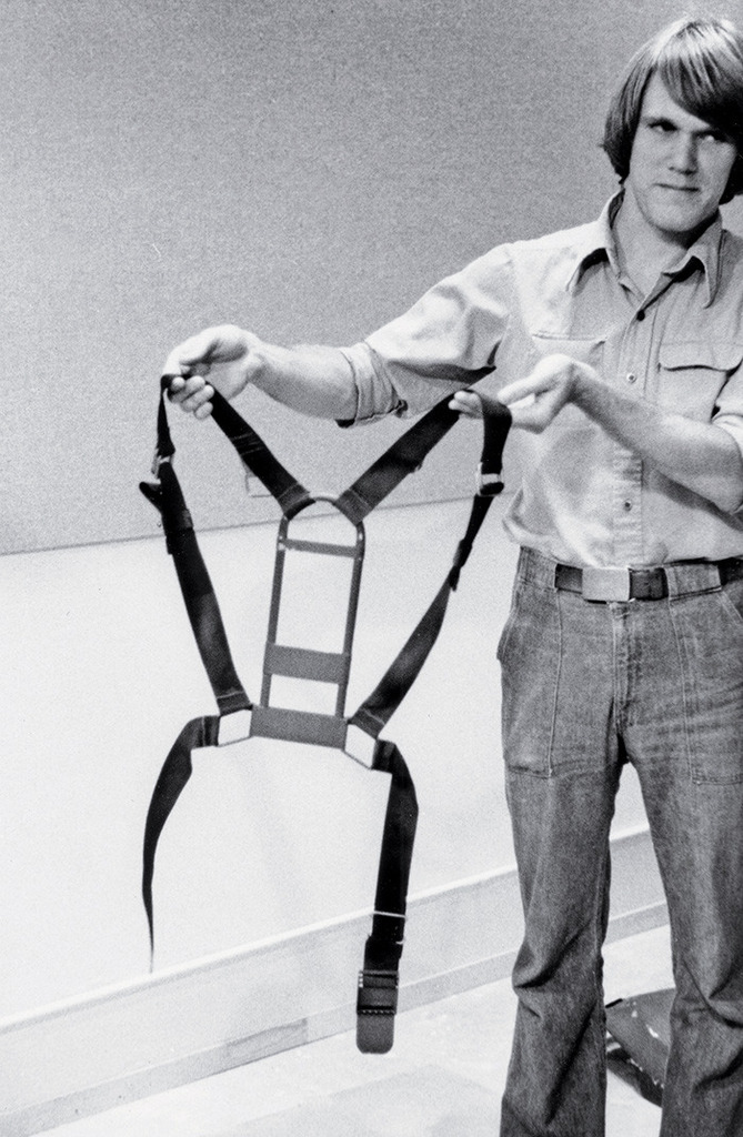

BigDane, as for the strapping configuration, that pic i posted above is the only one i have aside from this one:
Maybe they can help ya?

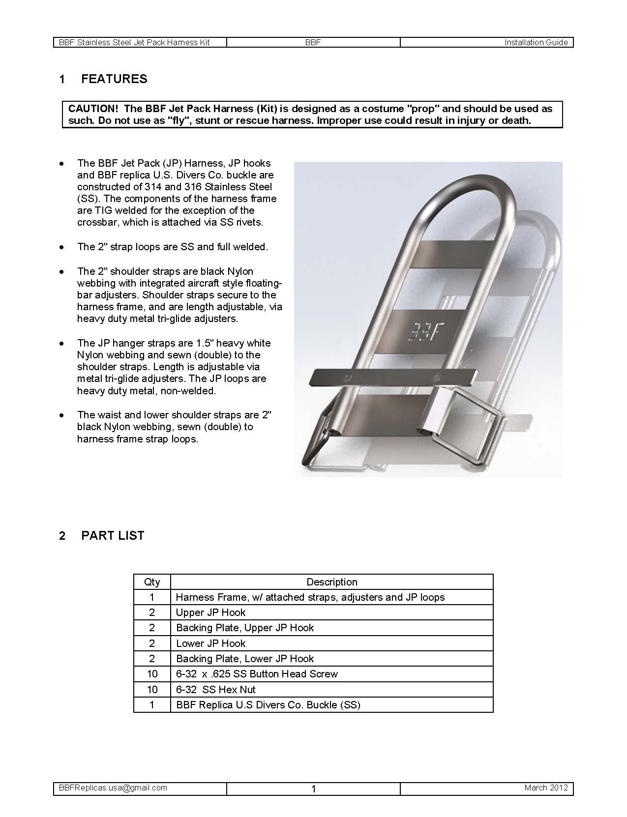

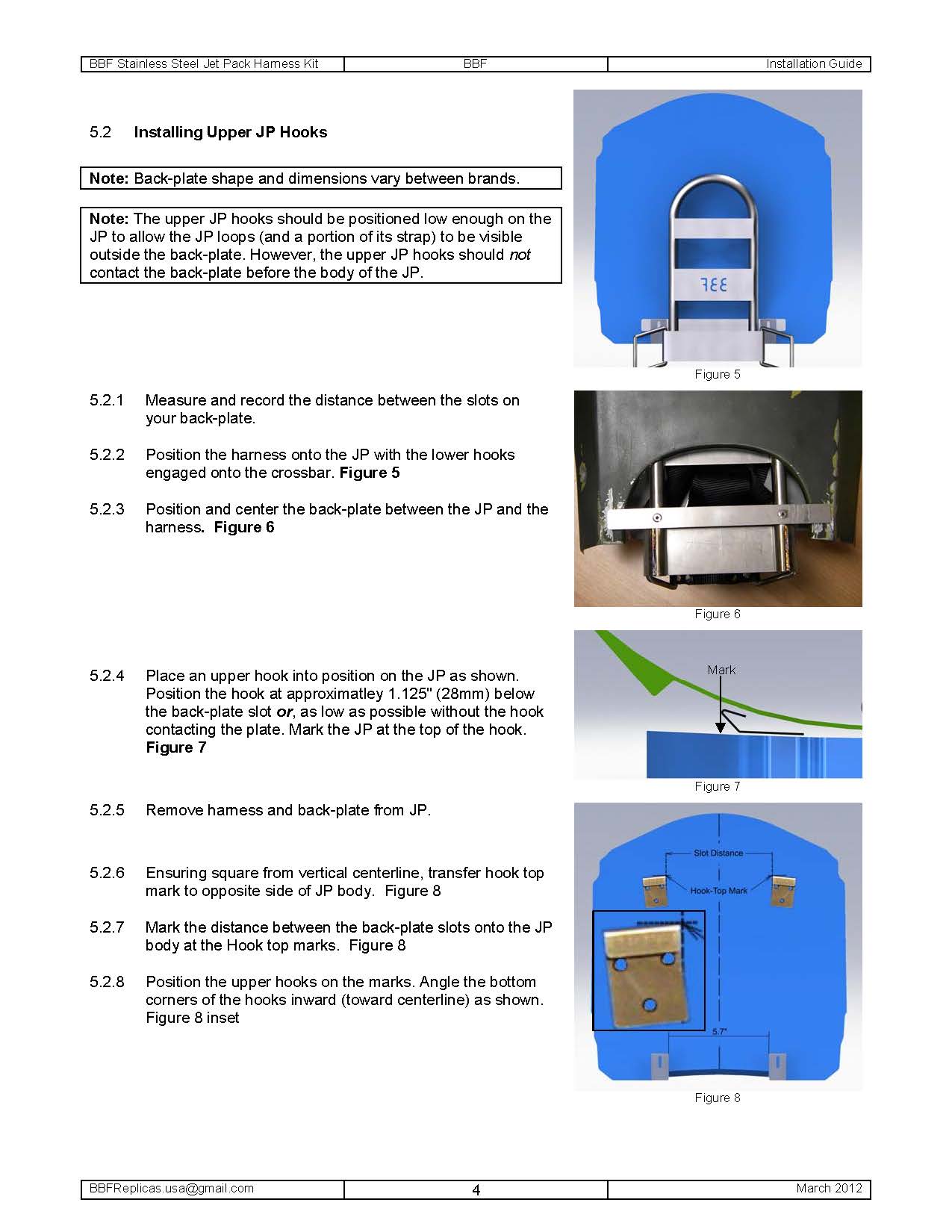

If you have a BoobooFett harness the bar is mounted much higher. If you look in the install guide he put out for his harness it shows the harness sitting below the bottom of the jetpack.
It looks like the bar on his harness is .750" to 1" & sits a little high in relation to the bottom of the harness. If you were to move the bar down to where it is flush on top with the support piece running between the tubes it may help with how the harness sits in relation to the jetpack.
i think your 100% right man. I think if i moved the bar down a touch and replaced it with a thinner bar it would fix the issue. I think yours looks near perfect. I can see the ammo belt, but i do not see the harness :)

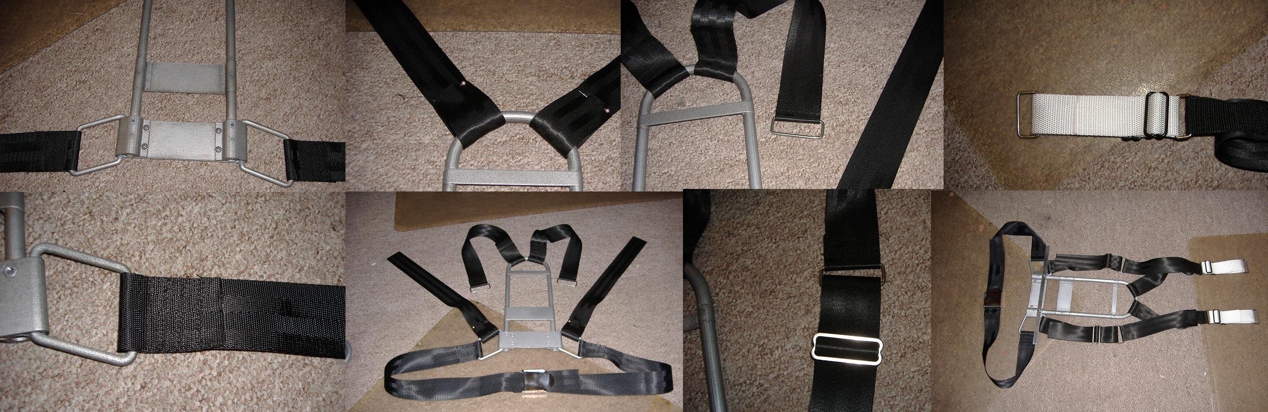

What harness is that on the bottom there layed out on the floor?
